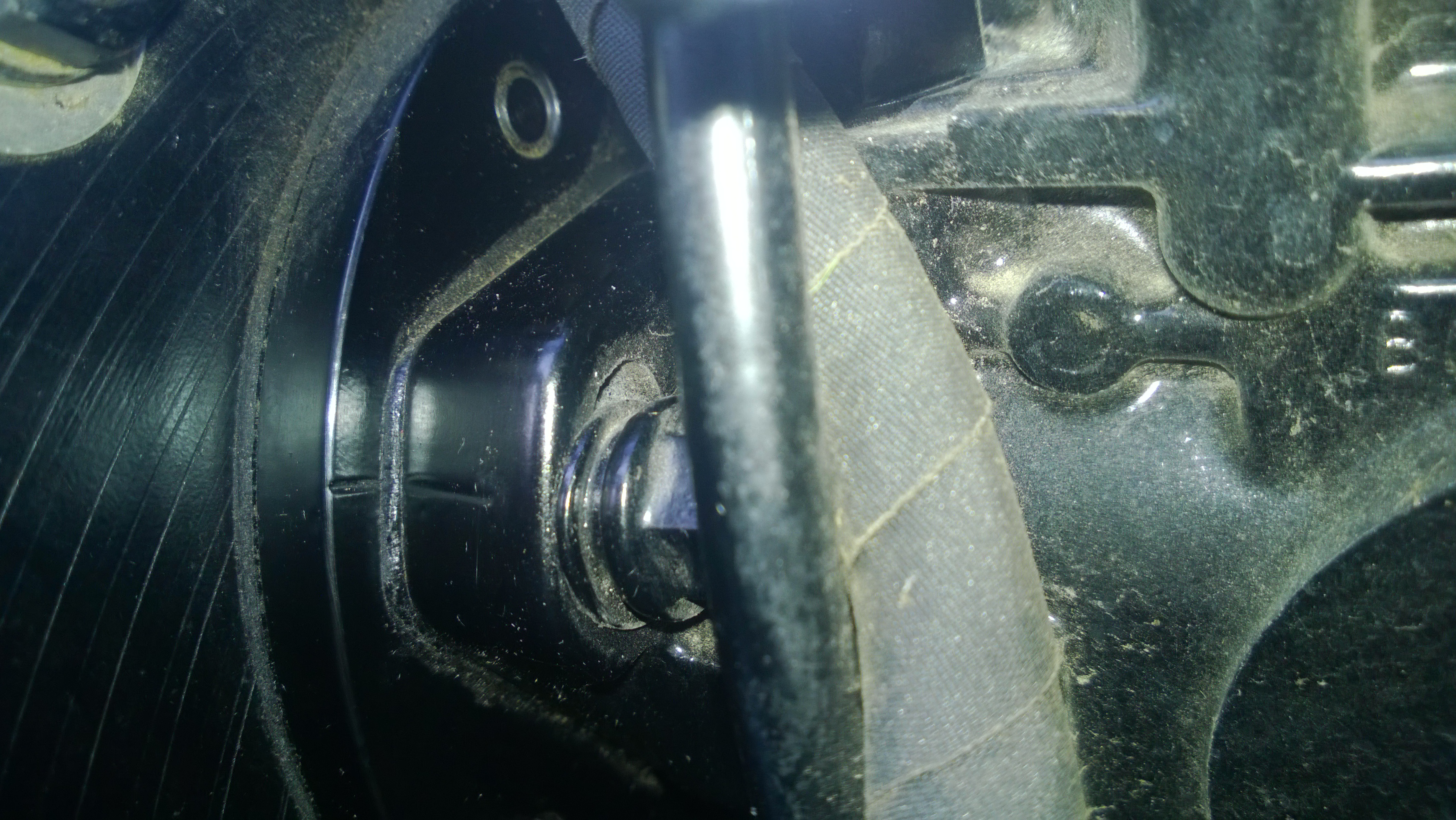

OK, so I've done the research on advancing the pump, that has led me to a new query... In visually inspecting my engine, it appears the pump is nearly rotated as far as it can go in one of the two directions. I'm sure it hasn't moved since it left the factory as there is not only a coat of paint that was applied after assembly that is flawless, there is also an alignment mark that indicates the factory position and that is perfectly aligned.
What if I make the adjustment and it helps but isn't enough? What needs done to correct the issue? Most likely it will go back to the dealer for anything more than what I'm into already, I'm mainly curious.
I wanted to try the timing adjustment on my own because sending the tractor to the dealer for an unknown amount of time for a 20 minute fix isn't appealing to me at all...
Below is an image of the timing marks and you can see how the bolts are not centered in the slots.

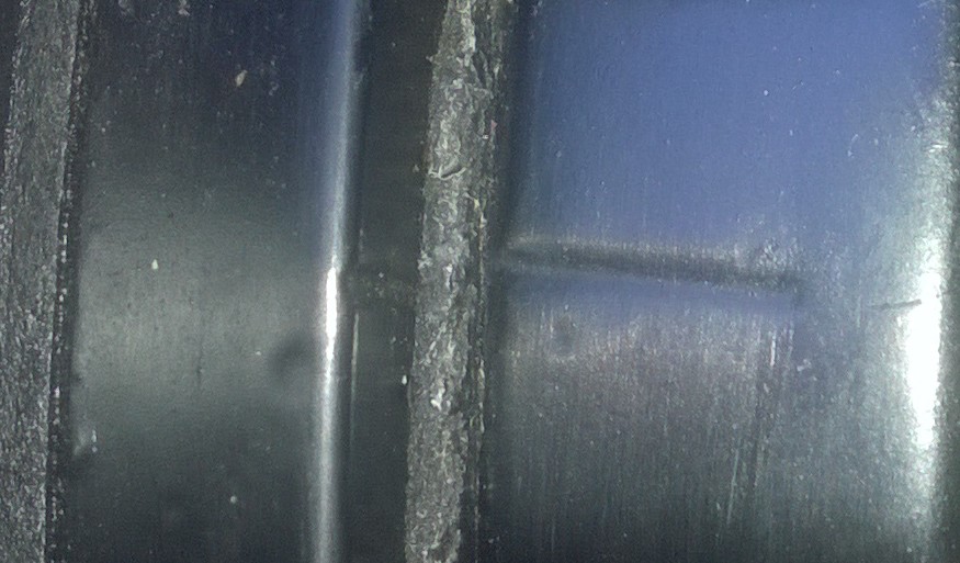

Well, my concerns were somewhat justified. It needed to go the direction with the least amount of travel. With it set as shown, it starts like new. I will be running it some in the next few days and see how it performs and report back.
   / 4035HST timing adjustment
Well, I've got about 8 hours of operation on the tractor since making the adjustment. Everything seems MUCH better. The engine still dies if idling when the KSB timer kicks off, but it is now able to be started without cycling the key off and back on to reset the KSB timer. Just give it a little throttle (makes it start at about 1100-1200RPM) and it takes back off with a 6-8 second grind on the starter. If I have it warming up at 1200RPM when the KSB timer kicks off, it sputters but doesn't die, which is closer to how it was when new.

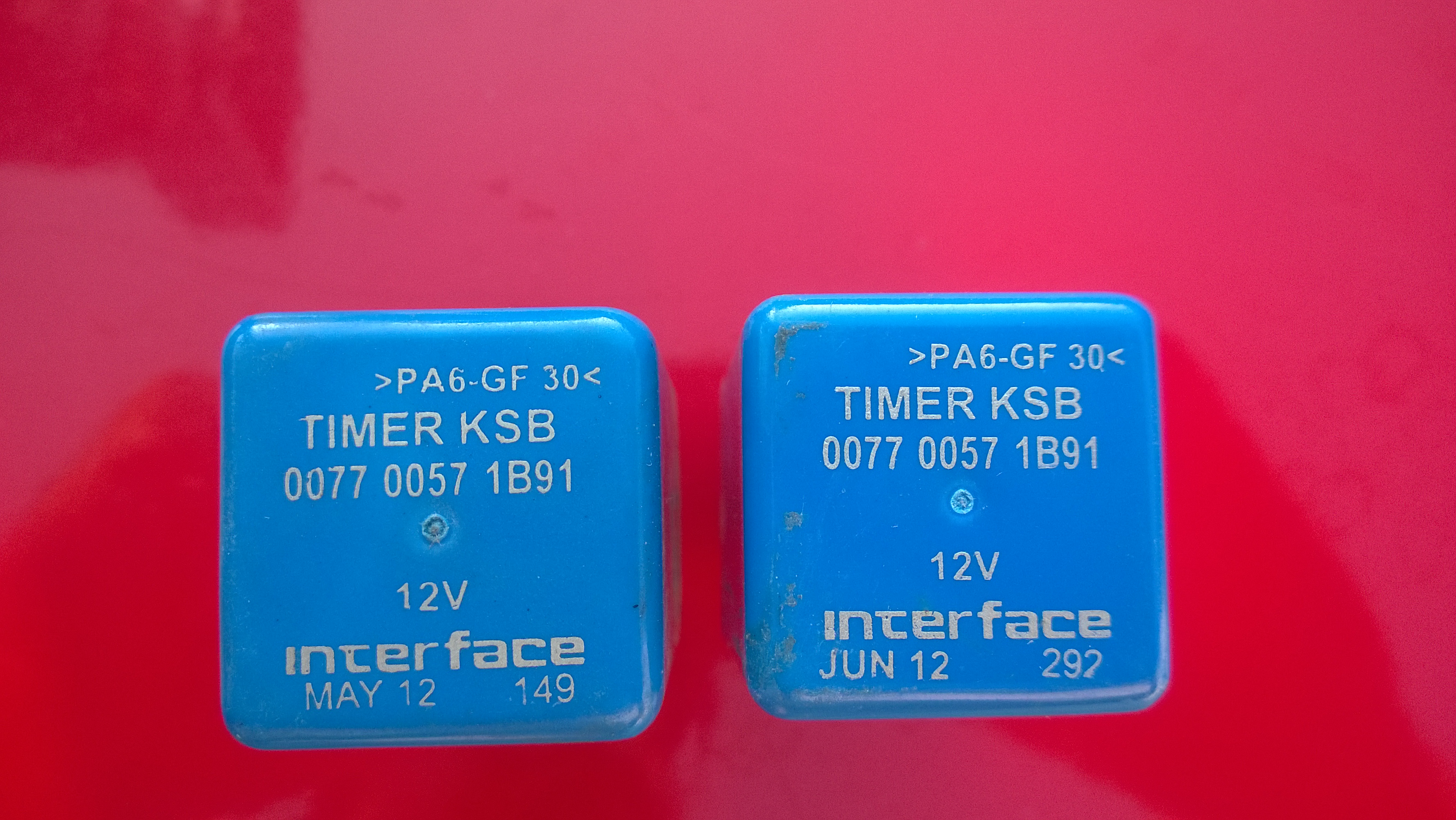

Does anyone know if the KSB timer replacement Mahindra normally does in this situation, is an updated part? Is it a new number? I'm considering asking my dealer for one to see if the transition is not as abrupt when it kicks off, perhaps that will prevent it from dying.

It just so happened my travels today took me near enough to the dealer with enough time to spare I stopped in and popped the hood on one of the new 4035s and looked at the KSB timer. It appeared from memory to be an updated part, so I went to the parts guy to have him order one, but he had two in stock already. I walked out the door with the new one in hand (free/warranty) and will be trying it in a couple hours.
Well, not so great of a result, but nothing that can't be tried again. When I had stopped at the dealer earlier and picked up the part, his computer only showed one in stock, but the bin had two in it. Neither of us gave it a thought, he just handed me one and out the door I went. Got it here and unboxed it, it is one month newer than mine...
I also noticed it has some dirt on it, not likely is it a new part... I tried it just to see if there was any variation in the operation of the tractor, everything remained the same. I'll stop and trade him for the other one in the drawer, hopefully it is the new one the computer database indicated was in stock...

Well, the other they had in stock was also June 12. I don't think it's going to do me much good to change it with the one. The mechanic said it could also be drawing air on the fuel line, but that doesn't explain the fact it is fine until 20 minutes each time. I'm just going to run it and live with the sputter at 20 minutes and let him change the fuel line this winter unless things progress... I can live with a machine that is 100% usable except for 3-5 seconds of sputtering 20 minutes after being started as long as it doesn't die and doesn't get worse...
