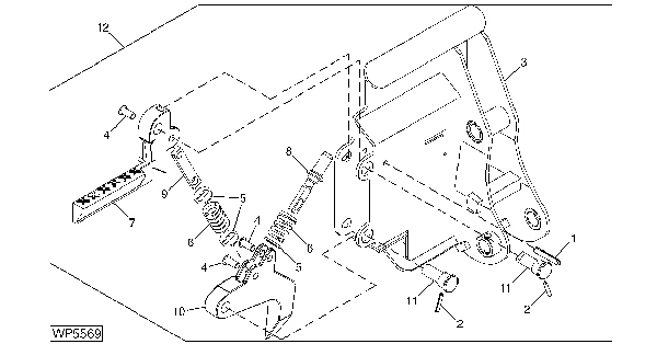

The exclusive rockshaft-assist mounting system (Patent Pending) makes hooking up the backhoe simple and quick.
Unique 4-point quick-attach system allows operator to install the backhoe to the tractor from the seat.
The RSA design positions the backhoe closer to the tractor.
Backhoe can be attached to the tractor without tools.
RSA mount plates stay on the tractor and are compatible with mid-mount tractor attachments.
To attach:
Back tractor up to the backhoe.
Raise rockshaft arms.
Pins in rockshaft arm engage hooks on backhoe.
Raise rockshaft arms to full up position.
Install pins.
Connect backhoe hydraulics to power beyond.
Backhoe is ready to use.
To detach:
Disconnect hydraulic hoses from the backhoe. Reconnect tractor hydraulics.
Raise rockshaft to full up position.
Remove pins. Can be attached or detached without the use of tools.
Lower backhoe to the ground and drive away.
Tractor is now ready for other work.

Found the fuel filler (not visibile in the photos so far). Look at the drawing Mike posted above - there is a large flap ("door") over a well - directly above the instrument panel, part of the same "dashboard" molding . Under that is the fuel filler (rather than thru the hood.) At the highest point on the tractors hood. What braniac thought that one up? Guess where your spills are going to go? Why didn't they move the tank to the rear and lower the fill point? Sigh.
