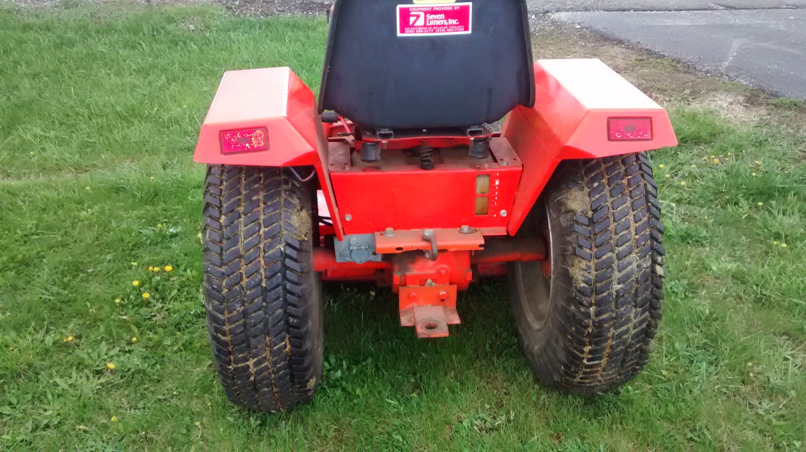

I have a question about an electrical connection on the back of my tractor. It looks sorta like the kind of thing you'd see on the back of a pickup for plugging in trailer lights. What is this used for?

Your tractor should have working lights on the rear but no OEM connector like you described. A photo would be a big help but I think that a previous owner has installed that receptacle so that a trailer with lights could be plugged into it.

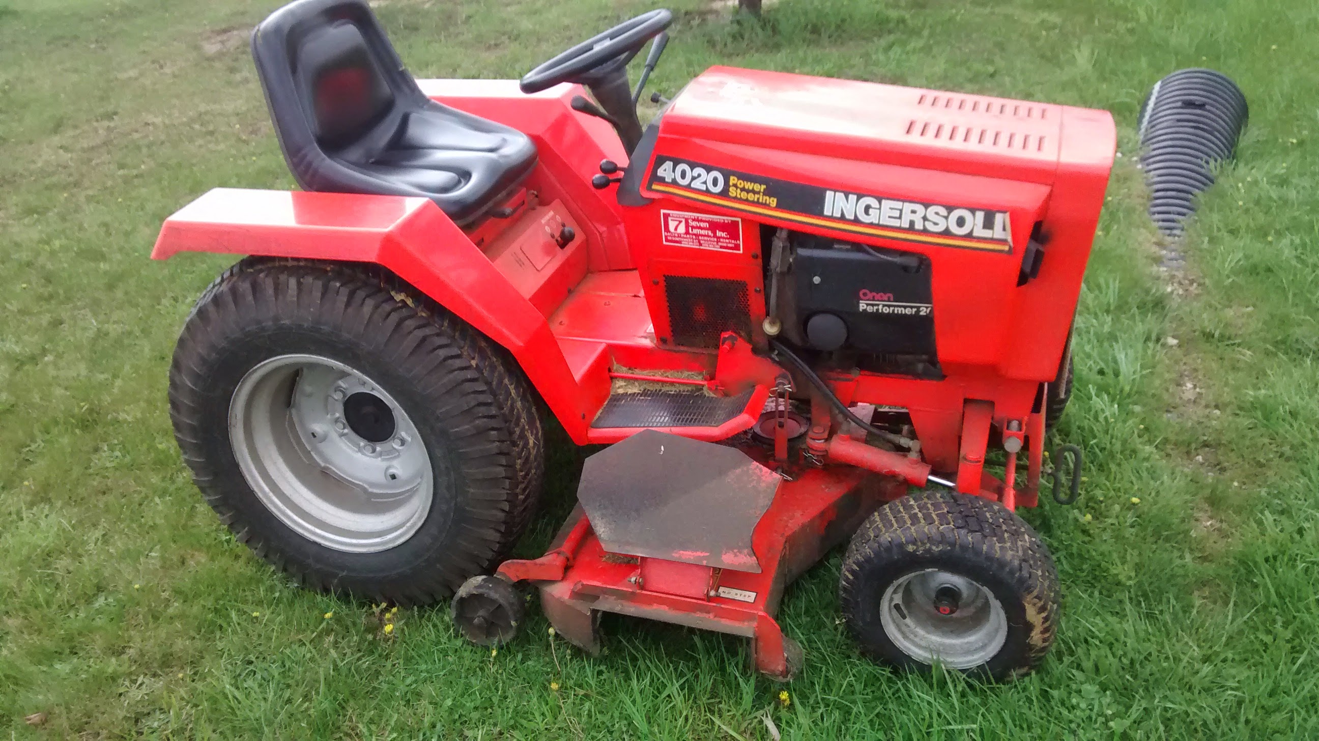

Here are some Photos. I think you're right hydrive, the receptacle seems to be something one of the previous owners installed for some reason. I'll take a closer look when I pick up the tractor tomorrow. I noticed too in a picture that I took of the PIN that this tractor may have at one time been owned by the Ohio State University.
Thanks for your help,
MM
/ 4020 Newbie Questions #7
Thanks for the photos. They help a lot.
The mystery receptacle is definitely been added. And you are right, it is a common trailer receptacle. The tow plate has also been modified to take a trailer hitch ball and the bracket above it was probably for the safety chain hooks.
You scored big time with this one. That Ingersoll is in lovely condition. It is essentially original except as I noted above and I believe the hour meter reading. Even the discharge chute deflector is still with the deck and that is rare. I also think that you are right about the previous owner being OSU. That is a bar code tag put on by OSU to identify a piece of their equipment. Those tags make it super simple for them to account for everything when they perform their annual inventory check.
