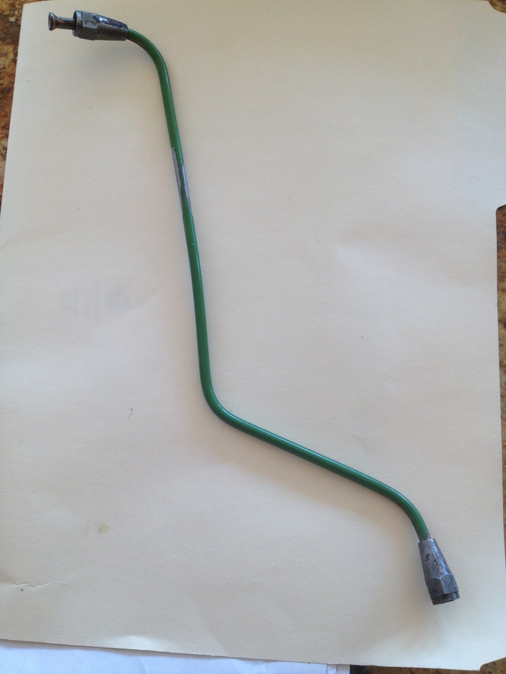

Here is the part. It is a 1968 4020. You darned near need to be a contortionist to get that thing out of there. It was leaking at the top fitting. What might this be? I ordered a manual but it is not here for a few days. Ill go o the dealer and order one i guess, no holes in the line probably leaking around the fitting. Any tricks to getting the bottom part back on? Lol
/ 4020 hydraulic fluid leak #6
Line is probably cracked in the flare. Have you considered replacing that line with a high pressure hose?
/ 4020 hydraulic fluid leak #7

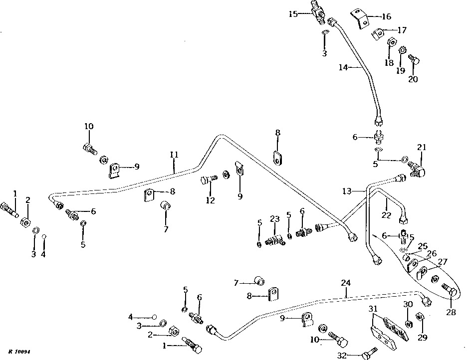

Looks like #14 in diagram. It is the brake pressure line coming off the steering valve.. Part number AR32238. They are still available. I assume it took a 7/16" wrench? The lower fitting is easier to tighten if you have a 7/16" crow foot wrench with a 6" extension.

Thanks and yes it did take a 7/16" wrench. We were out of town last week so I couldn't post. That part is put in and now there are no leaks visible in that area.....Now with that said, it is leaking somewhere else. Not a lot but I had never noticed it before, I bought this tractor last year and it has been running fine, using a bit of hydro fluid but nothing bad until that line cracked.

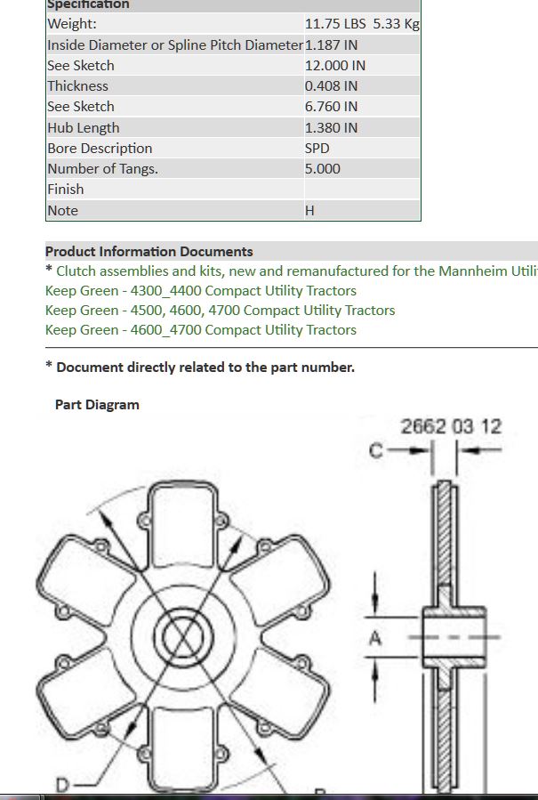

jd110 very good point about the possible pto linkage boot leaking. If tractor has a button clutch would hyd oil leak in clutch housing be blackish oil?
/ 4020 hydraulic fluid leak #13
Yes, button clutches still seem to put off black dust. They wear down the pressure plate and flywheel, also the pto disc is always a conventional disc.

Button clutches has bronze like pads that hold good but aren't suitable for things such as FEL work. To access rubber boot one needs to remove dash panel that both key & light switches are mounted into and look to the left.
