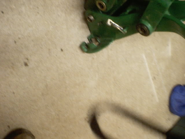

Has anyone had problems with the quick attach brackets on the 400x loader? I have broken one on each side where the pin on the bucket goes through bracket. That part of the bracket is about 1/4" cast. This is my first experience with a part breaking on a JD loader, I've used others the same way I use this one and never had a problem. Just wondering if anybody has used one and had similar results.

Here are some photos of the part and its mate. I have looked at other JD loader hookups and they are all plate, welded steel. This is a cast part.

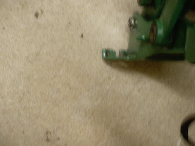

   / 400x loader
More of the part

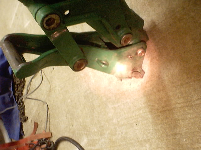

   / 400x loader
The other side

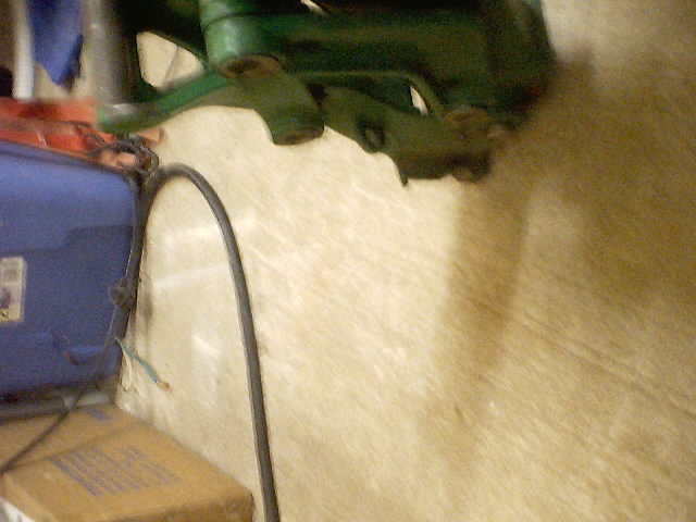

   / 400x loader
One more

On my 4520 with the 400X FEL, the part appears to be a forging rather than a casting. Sand castings usually have a 'grainy' appearance/feel, whereas forgings are somewhat smoother. And, as you undoubtedly know, forgings are almost always stronger than rolled plate steel. But, appearances can be deceiving, especially after having been painted with the John Deere green.

If you break this part it should be covered by warranty. I doubt if it will be covered after welding but it is worth a try. My dealer told me that if enough of these break that JD sometimes steps back and looks at the design possibly changing it to reduce breakdowns. BUT you have to let your dealer and/or JD know there is a problem. Also, my dealer said as long as it is covered under warranty to keep bringing the two halves in and they would replace them- after it's off warranty, then look at another fix, if JD has not changed the design.
