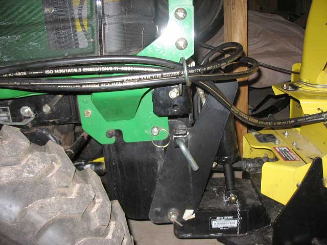

Great place....in the time it took to type a reply there were already several other posts. At any rate, here's a side pic of a 4110 with the blower/hitches mounted up. The tractor mount I refered to is green (nice contrast) and is part of the FEL hood guard. Good luck
   / 4000 series/2520 snowblower help?? #12
al3,
That's basically it, mine is in black.

Thanks guys! Do you run a MMM as well? There are two attaching kits available... both look a little different. There is also a "Front hitch/mid-mount mower combo bracket" for $94. I have a mmm as well...
It's kind of wacky for JD to put the one I have if you can't even attach the front quicktach to it... Why in the world would they do that??? (kind of a rhetorical question) :eek:
Front Attaching Support Kit
For 2520, 4100, 4110, 4115 Tractors.
If Tractor is Equipped with Hood Guard, Attaching
Support Kit is not Required. 2520 Tractors with
200X or 200CX Hood Guard Require Attaching Support Kit.

Front Hitch/Mid-Mount Mower Combo Bracket
(2320, 2520, 4115)
Required for Tool Free Change Between 54D or 62D OnRamp
Mid-Mount Mower and Quik-Tatch Front Hitch (2320, 2520, 4115).
LVB24899 $94.00

If I remember right, that new $94 bracket may require you to
get a new hood guard, and/or some new front attaching plates.
We had a deal where the original hood guard wasn't compatable
with this combo bracket, and in Sept they released a new hood
guard that was compatable... which allowed a very easy changeover
from MMM to Front Quick Hitch..
When did you get your loader and hood guard?
I think the new hood guard number is :
BW15634 , and this new guard will integrate with the
front attaching support kit (LVB25302) , which will then integrate
with the combo bracket (LVB24899)..
are we confused yet??

My dealer gave me a third bracket that replaces the front PTO bracket. So you pull off the PTO bracket and this pops right in for the MMM front bars. I just found it sitting on my 62D mower deck. Took me a few minutes to figure out what was going on but now I think I should be able to switch things back and forth fine.
Rob
