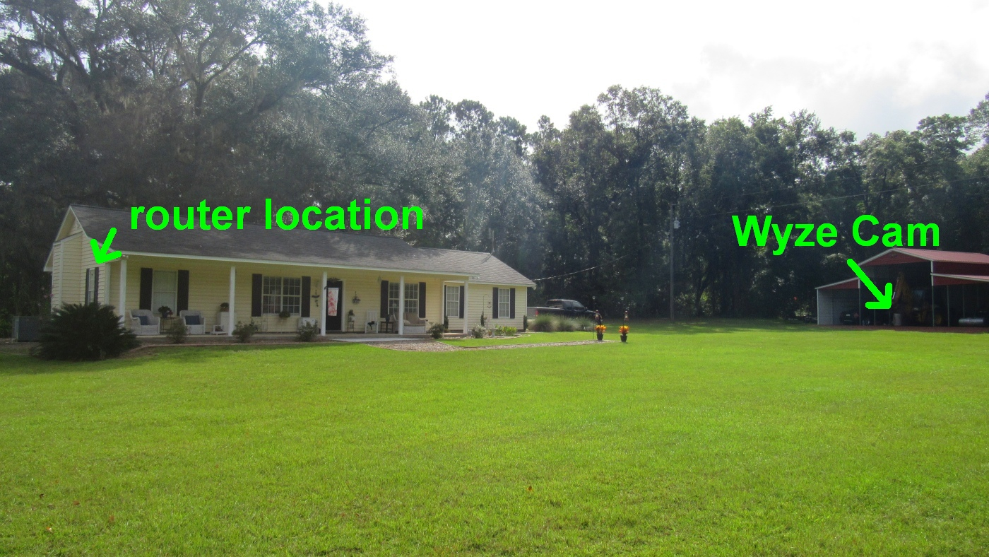

The subjects of long distant wifi and wifi security cameras come up from time to time so I thought I would share my setup. It works well and is about as low budget as you can get.

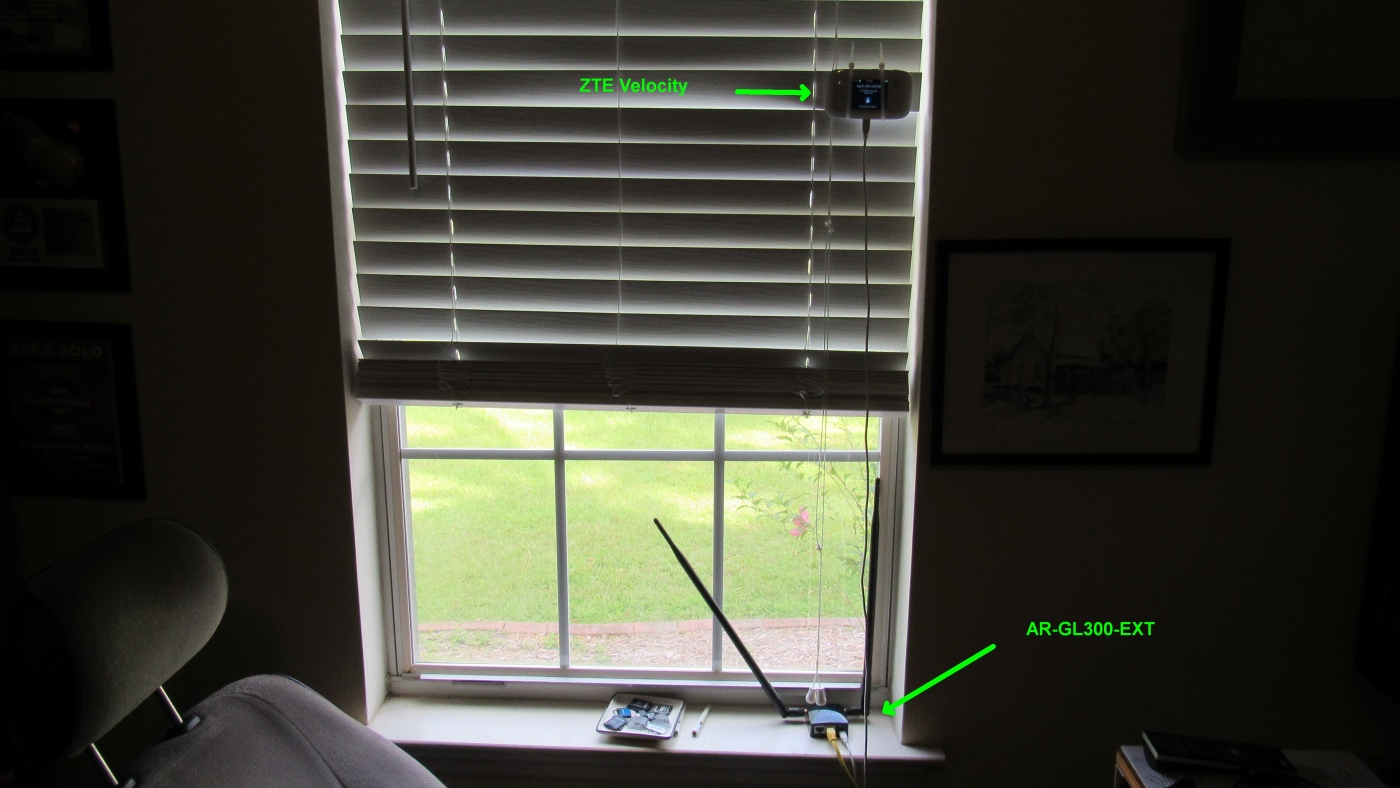

My internet wifi system consists of a ZTE Velocity Hotspot Router on AT&T connected to a AR-GL300-EXT travel router. I have the travel router connected wireless to the Velocity. It can be connected wired or wireless. I have my PC connected to the travel router with a cable. Everything else on my home network connects wireless to the travel router including TV and outside cameras.
The Velocity is tie wrapped to the blinds for a better signal and the AR-GL300-EXT sits in the window sill. There are several versions of the AR-GL300 router and they don't all have external antennas.
I have added longer 9 dBi antennas to the travel router and the furthest camera. I didn’t see any real improvement with the longer antennas but I also didn’t see any degradation so I left them on. I bought the antennas off eBay for <$9 for a pair.

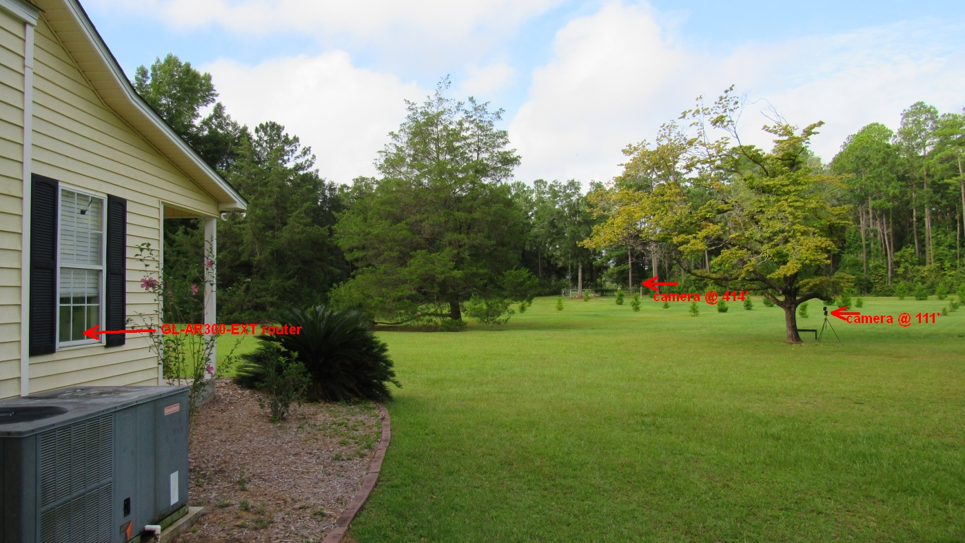

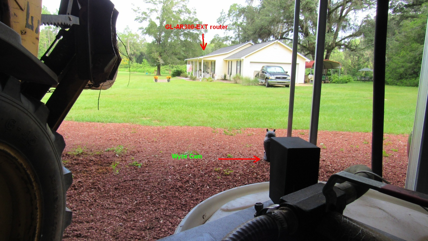

I have 4 Reolink wifi cameras and a Wyze cam on the network. The furthest camera is a Reolink Argus Eco at 414’ from the router window. The next closest is the Wyze cam at 198’ in the barn. The Wyze Cam has to shoot it's signal through the whole house. I also have a Argus Eco at 111’ out front. The other two cameras are Reolink RLC411WS and a Reolink RLC410W on the front and back porches.
Some weather conditions seem to hinder connection to the field cameras but I can access them 90% of the time with no problem. The Wyze cam almost always connects and it doesn’t even have an external antenna.
Sooo the signal quality depends on a combination of a good signals out and in. It is also affected by weather at times. The key ingredient to the distance in my system is the little $32 travel router.

The Wyze Cam has superior motion detection if you have power and a covered area but it's night time infra red range is limited to close range. I have the Wyze Cam plugged in to the USB output on a Solar Controller that has a group 27 battery on it so it remains powered.
