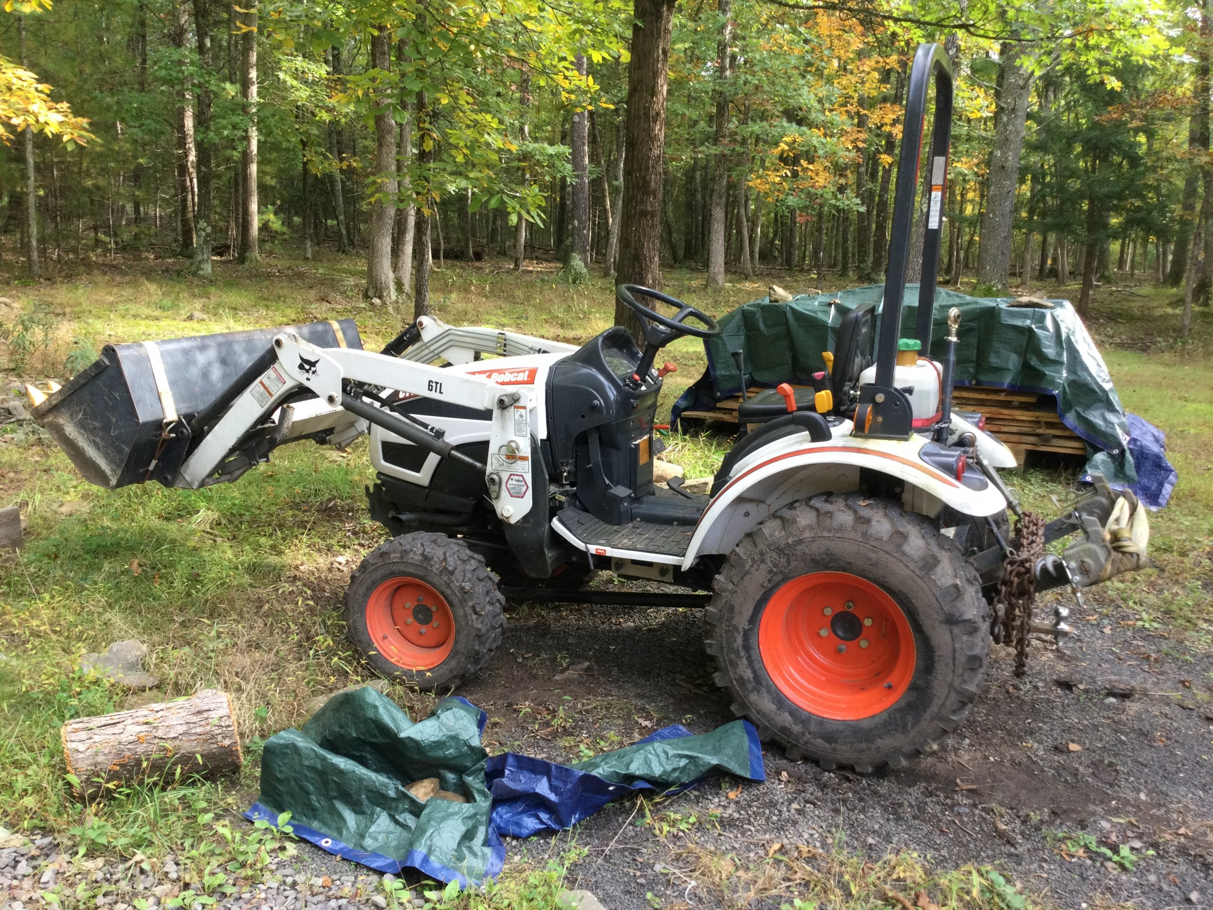

I have a bobcat 2025 (kioti) with 55 hours so far; got it this spring. I really only need to engage the front axle when moving dirt or slogging through muddy trails. All my mowing and manure spreading are easily done in 2wd. Any reason to use the front axle every once and a while? I don't really notice a difference either way; power or steering etc.

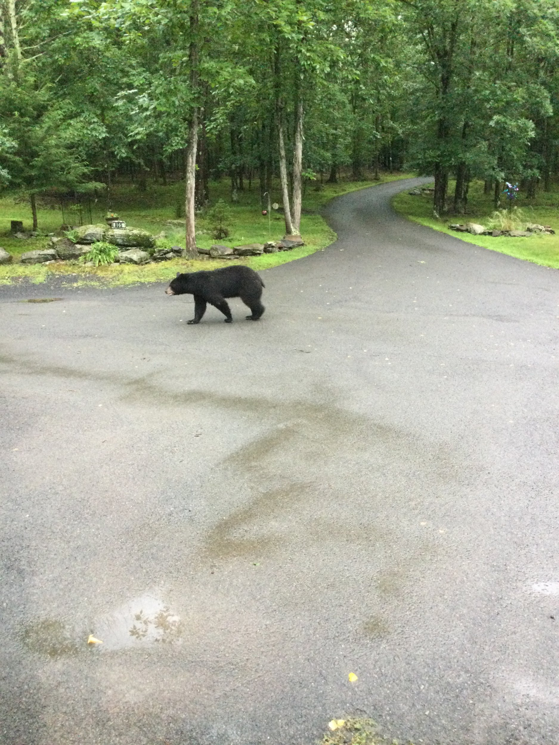

Do set up a video and let us see you do that with forks and a machine out front while you are in a uncontrolled slide. I'd be interested in learning how one has the presence of mind to slowly lower the FEL. The slide was over in what 30 seconds?
With the forks curled as much as possible to keep the machine on them, with the forks just barely off the ground, my fear was the fork frame would catch something and pin wheel me. If I had the bucket on, I would have been far more inclined to try your idea.
You suggest apply slowly.. how many experiencing this for the first time would have the skill to do it slowly while trying to keep the machine from heading into a tree? Trying to keep the machine over the crown of the driveway and not headed into a side ditch?
The first mistake was no ballast on the back. The second mistake was not putting the machine in 4WD where the engine and the brakes can work to slow it down and to keep in control. I've traveled that hill hundreds of times. This was the first time I forgot to check the 4wd.
I admit to the stupidity of those mistakes because I rushed to do something.
I won't add anything real intelligent here except to note that I learned the (almost) hard way about running a full FEL (wet gravel) down a sloped, paved driveway in 2WD. I was shocked that the brakes did almost nothing to slow me down and I was scared as hell. Luckily my driveway has a long, flat-ish tail out to a gravel road and I was able to regain control. I'd be lying if I said at one point in that fishtailing toboggan run I didn't consider jumping. That reads really clunky. I thought about bailing out to be sure....
Sounds like more than one of us has had to learn the hard way. I too considered bailing but then I figured I might reach that tailing off level space and get it safely back under control. So I stayed.
I appreciate your story. I understand that desire to jump!
