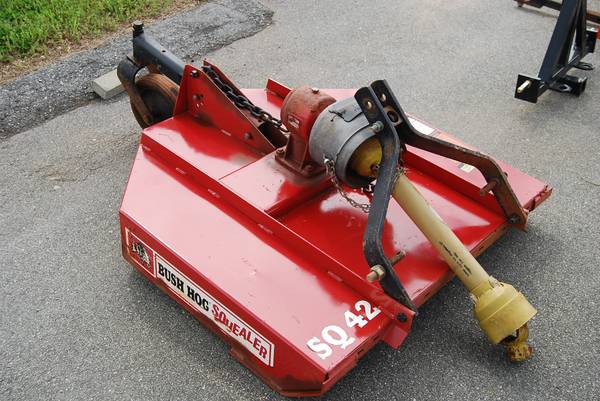

Sorry to infringe on the thread...but I too have been shopping for a 4' rotary cutter...due to my ignorance on the topic I recently discovered that smaller cutters are available...
Any opinions on this cutter...the asking price is $500....anyone know what they sell for new?
If you can get that mower for $500 (or less), then I say JUMP ON IT before someone else does. It looks almost new (and medium duty too), and you would probably be getting it for half price, or even less than half the price of a new unit just like it.
I just sold a 5ft Ro-Cut light duty bush hog mower (made by Taylor-Pittsburgh) yesterday for $500 and it wasn't near as nice as that one is.
I don't know. That looks like a well-used cutter that has a fresh coat of paint. Look at the tailwheel. It's got paint on it. It also looks like the support frame for the tailwheel got a half-azzed paint job.
To the OP, I'd check that cutter out carefully. Check the gearbox for oil. Check the blade pan / blade carrier underneath it to see if it has oil on it, which is a sign of a leaking seal. See what condition the blades and underside of the deck are in. It could be a good buy, or it could be a problem child with a fresh coat of paint.

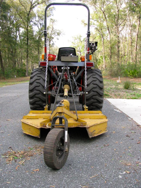

I had a 4' King Kutter rotary cutter and it was indestructible.
Of all the implements KK make they enjoy the best reputations for their rotary cutters and roto-tillers.

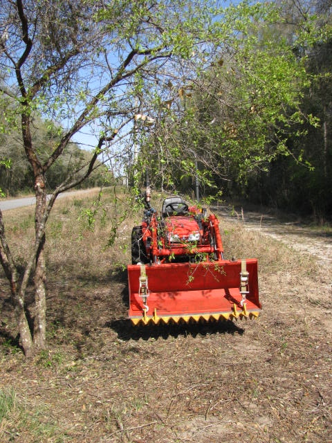

I pulled the KK 48" behind a Kubota B-series with 25-hp PTO. It cut 1-1/2" saplings without strain. May have cut 2" stuff going slow, but for the larger size stuff I ripped it out roots and all with a Ratchet Rake on the bucket.
