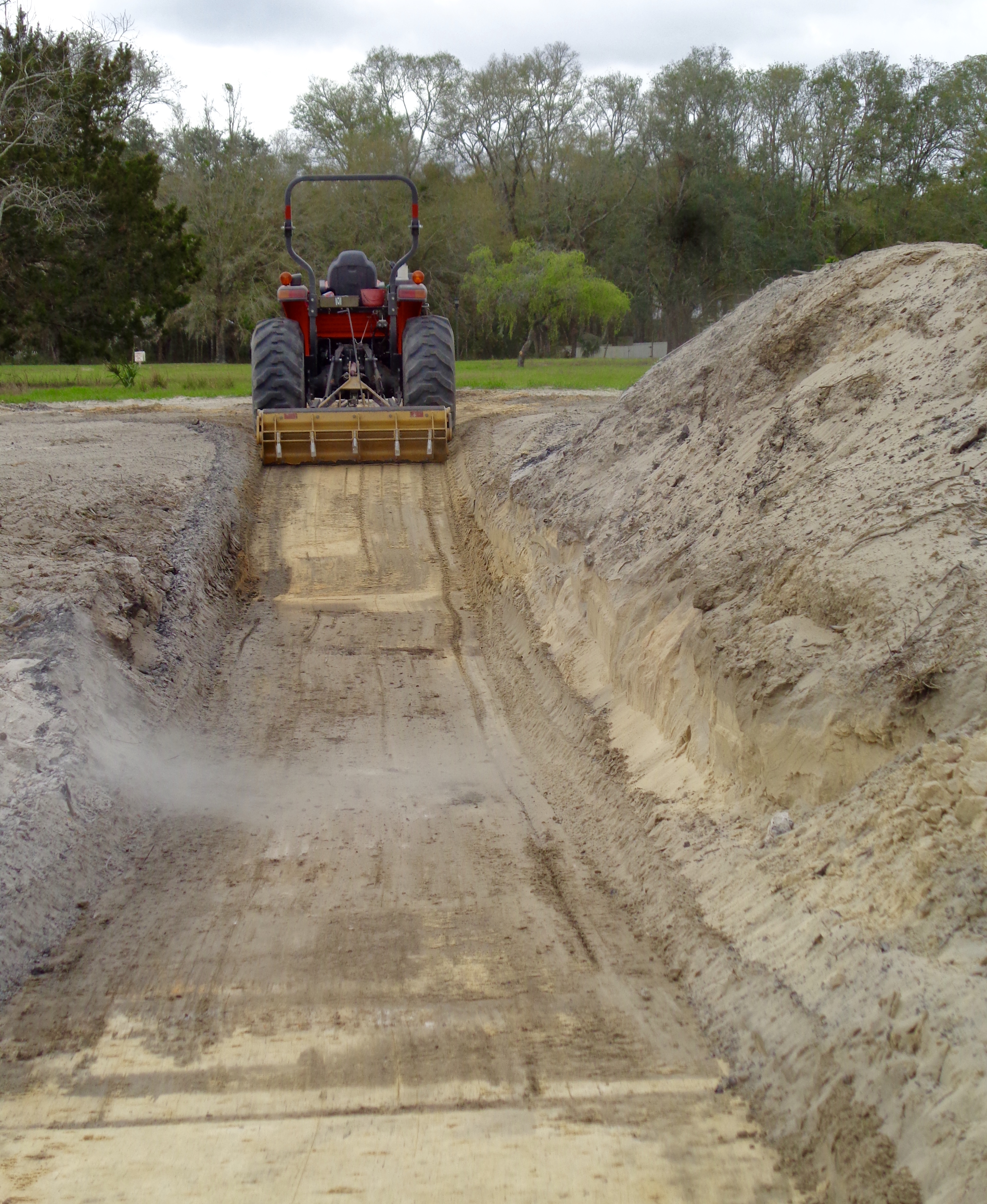

Box Blades optimally are slightly wider than tractor's rear tires.
If narrower, you cannot pull down the same "aisle" repeatedly because space for the rear tires is not cleared.
Weight is your friend in ground contact tasks.
Box Blades need to be 100 pounds weight per foot of width in order to cut soil well. (Construction Box Blades are 200 pounds per foot of width.)
Many 48" Box Blades are sold to newbies on basis of price. Often they do not cut, or cut 1/4" per draw. Sometimes they break. Only the heaviest 48" Box Blades approach 100 pounds per foot of width.
Moist soil cuts much easier than dry soil.
Learning to operate a Box Blade efficiently takes time.
A Box Blade is the implement most frequently employed as Three Point Hitch counterbalance to loader bucket loads.
A light Box Blades is not heavy enough to keep rear wheels securely on the ground during a max lift of dirt or other material with the loader bucket.
I trust you have functioning 4-WD.
Width of Rollover Box Blade in Photo 60"
Weight of Rollover Box Blade in Photo 630 pounds
Soil is pure sand at depth in the Photo.
