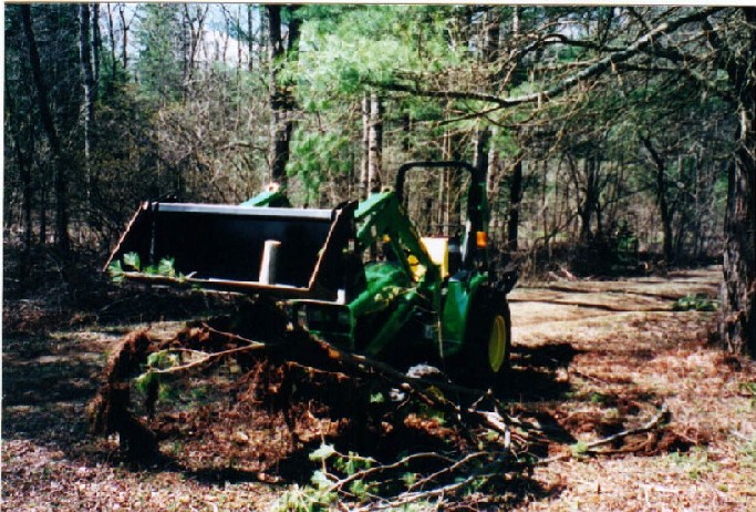

What are the biggest size stumps you have removed with the 4in1? These that you're showing are awfully big. Were you able to pluck these right out of the ground? If so, then these 4in1s truly pack a punch.

Bob, That latest picture was the largest stump I have removed so far and that one had to be Dug out (big hole required) with the BH. The 4 in 1 handled it nicely but I have learned to transport that or larger bolders in reverse... (this way if something comes loose and drops in front of you it won't be hit with the tractor) See previous post on this subject!
The picture attached I "plucked the stump out"... It was only about 3-4" diameter with shallow roots (didn't notice what kind of tree it was when I cut it down last fall) and with the help of a saturated ground came out real easy. I have done about 10 others of that size with the same results... some were a little more difficult but they all were plucked out!
Recommendation: when you take a tree down... leave the stump 2-3' high... this will give you some leverage (pushing/pulling to loosen) and something to grab when it is time for that "Pluck"!
Also try to grab it as close to the middle of the bucket as possible... this will distribute the loads evenly between the loader arms (no sense in bending anything!).

Thanks for the advice Jim. This 4in1 really is amazing. Can't wait to try it out on my stumps.

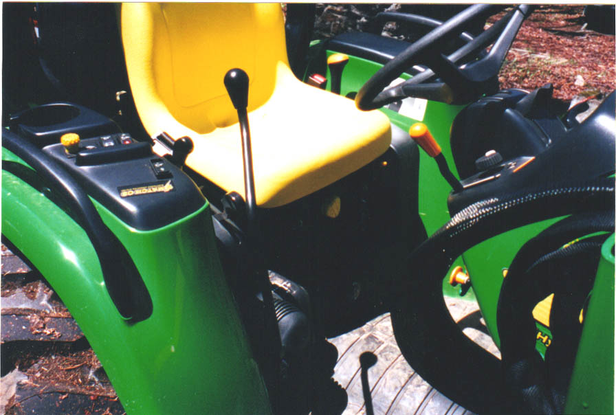

JC4HD...My private email covered this, but for the sake of the forum (and because someone else may want to respond as well), please describe the use of the 4 in 1 bucket. Today the dealer I intend to use tried to talk me out of a JD 4 in 1. He described the operation of the bucket and made it sound as if there is a second lever on the right fender that was really a diverter. He said it was a little of a hassel to operate.
He recommended a 3rd party bucket where the knob on the control stick was replaced with a knob that had a button on it which controlled an electric diverter.
Do all of the 4 in 1s work on a diverter concept? I thought the second lever I was reading about was a control for the bucket.

Ok Al here is how mine (and I think Bob Ancar's) work... I have the JD 4in1 bucket with seperate operating lever for the "Jaws" that is mounted by the base of the FEL control lever in a factory provided cutout. It (the jaws via the lever) is powered by the rear power beyond kit through and controlled bya a third control valve (aka the seperate operating lever) which required hoses run from the rear up to the quick disconnects in front. Instead of 4 hoses for the loader... there are 6... so I keep the quick disconnect feature of the loader without disrupting the hose routing to the rear. I really like the setup. I think what you are talking about is a button on the top of the control lever for the loader which requires some sort of solenoid diverter arrangement and additional plumbing. While it sounds like (and probably is) a nice setup... and it might be a little more conveinent to operate than mine... but now that I am used to it I have no complaints about my setup! As a matter of fact the operation has become second nature. Also I understand it the button arrangementyour talking about costs about $700 more than my setup and is actually a diverter as is not the case with mine. Since mine is powered from the rear I can use all three functions at once... lift, roll, and open or close. With the button arrangement (I was told by a very good source) it diverts the hydralics from one of the circuits on the fel so while opening or closing the bucket you would loose one of the other functions... certainly something you would want to check into.
I'll try to attach a picture showing a different angle of the third lever location (at base of fel control stick by the right front corner of the seat) on the 4310.
Also note... I have really tested that bucket and have yet to bend anything... pulling stumps, lifting some awfully heavy rocks, pulling brush, and cutting the sod with the clam... it's a good HD bucket.
I am not a technician so hopefully I have captured the plumbing and operation of the JD setup. I am sure if you had any further questions Mark Brucker at KC Canary in Fultonville NY (where I purchased my 4310)would be glad to answer your or your dealers questions. He can be reached at: 518 853 3405. I'm sure you and other TBNer's have heard Bob Ancar and I sing his praises more than once before. By the way the cost of the 4in1 with all of the plumbing, valves and quick disconnects added only $1,200 to the price of the tractor... now that I've used the 4in1 for a while I consider it a steal!
Good Luck... I'm sure you'll love the 4in1 you decide on.

OOP's here's the picture I promised!
