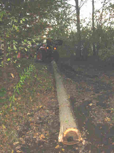

I'm very pleased with my B7500 HST 4x4 with the 302A loader. I have a small tree farm of 30 acres, and find the Kubota a very able machine. I'm attaching a picture of the Kubota hauling a log up the hill on my place. The hill is no problem for the B7500.
