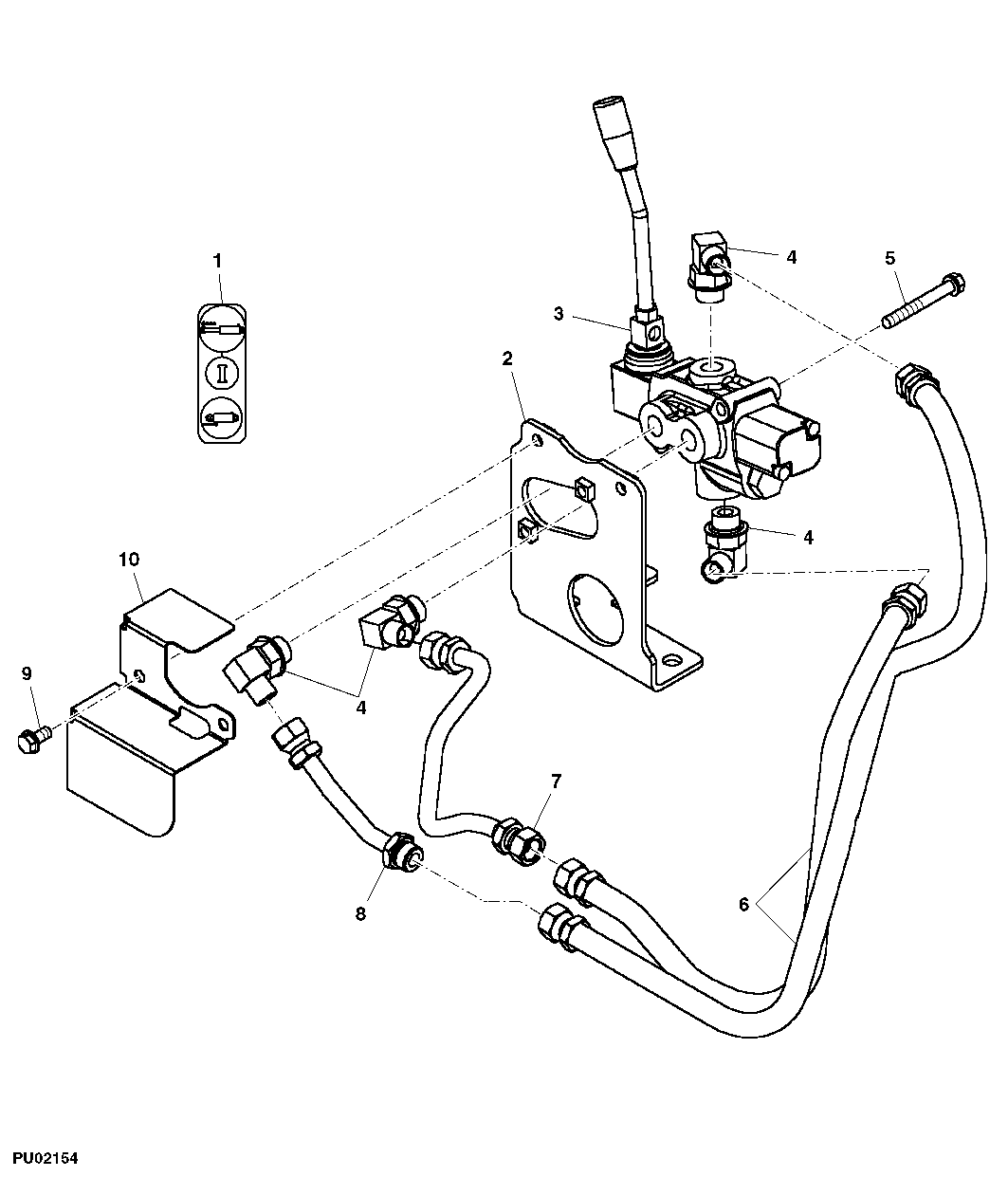

The third SCV kit (pictured below) comes with it's own valve, but I am not sure how it hooks up since the lines appear to go from the IN/OUT ports to the work ports in the diagram :confused2::confused:

Has anyone done this? I found this option on the deere site:
Third selective control valve kit
it says 'kit does not include a valve' -- i'm confused. What does this kit actually do?
I am stumped:mad:
I can't figure this out it JDParts...unless there is something new in the works since this was just updated in April?

However, this is towards the bottom and explains everything I think:
NOTE: Designed to work independently of the loader, the 3rd SCV kit does require LVB25603 power beyond kit to function.
EDIT: Duh, no, that still doesn't explain what the lever controls....

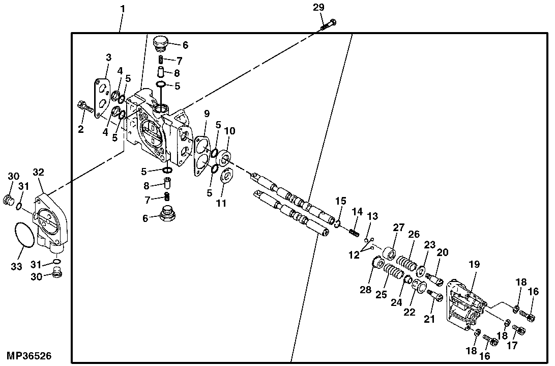

Look a the picture below, there is only two spools. It's the same basic setup as my 4110...

Kenny, like you said of the mobius picture, that has a valve. And the description of the kit says its supposed to hook to the Power Beyond. That makes perfect sense and would work.
So I think the link posted by Phunge is just wrong in that a valve is not included. The valve IS included. It kind of looks like someone at Deere just cut-copy-pasted the description of the kit from another tractor model.
What a mess.

I was thinking of doing this to my 2320 also and found this kit LVB26166. To me it appears to connect underneath the loader control valve, I checked on mine and its has two allen head set srews plugging two holes with I'm thinking is where it hooks up. I posted some pics of the set-up and beak down.
/ 3rd SCV for 2320 #13
Yes those two plugs on the SCV are for the power beyond kit also, so this new SCV will will only work if you never intend to have that or a backhoe. You will also have the remove the SCV to install the internal plug, #3 in the second diagram, it forces the fluid to go to the OUT port and through the new valve (or PB kit, it's the same plug used there also).
Brian at FitRite hydraulics may have a kit that offers more spools for a similar price, a lot has changed since 2010 when this thread was started.
