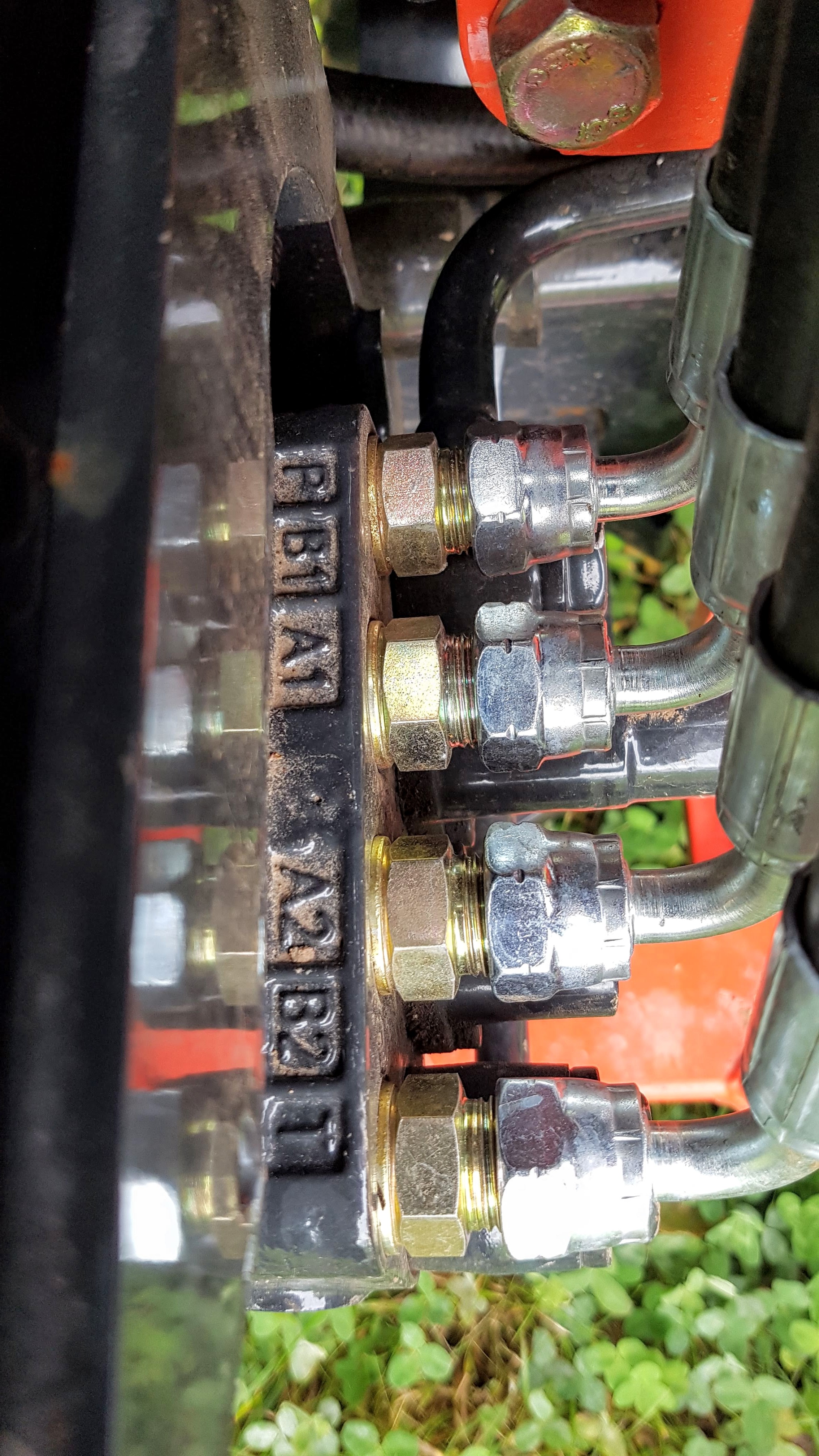

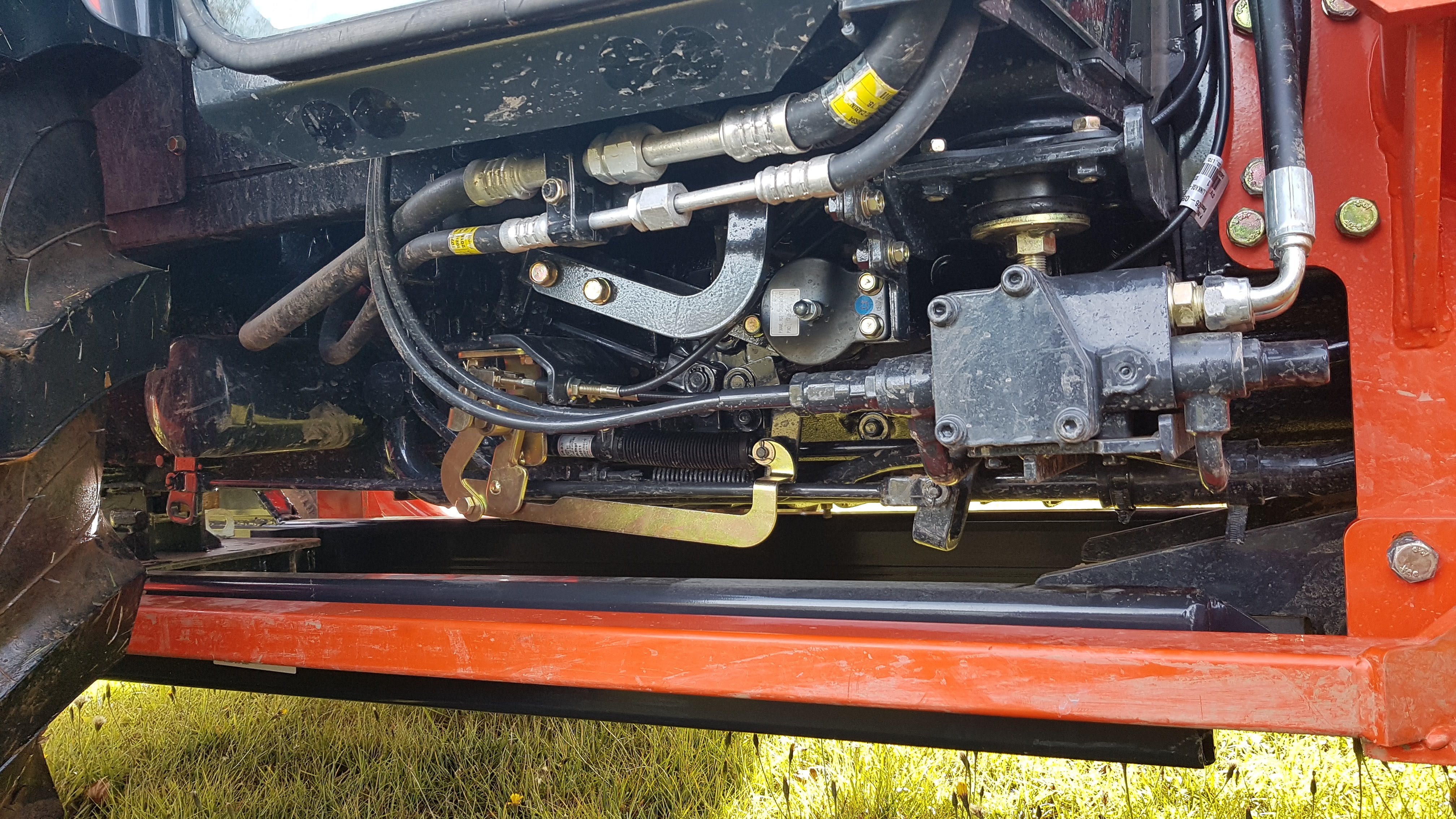

HI,
A few questions to those who have done this without a kit, I'm using parts I bought at Princess Auto (DO3) valve, some hoses they made up and I'm going to fit in a 30A DPDT rocker switch to the handle of my Kioti DK 4210SE, for the grapple. my question is a bit of a simple one, by sight, which connection on the SCV is the Power Beyond, I see the 4 lines to the loader, the Pump and the Tank lines, but was wondering which line is identified as the PB?
1. I have a backhoe installed (from factory rear port, don't want to use these for the grapple) so I'm guessing PB supplies this, so I can follow that line correct?
2. Also I remove that line runs from the SCV to the backhoe supply (rear ports) and run a line from that connection on the SCV to the DO3 valve (pump in) and run the DO3 outlet (T) tank port to where the PB tied into the rear remotes from the SCV to the backhoe supply?
3. I wasn't going to add a relay to the switch as it's a 30A DPDT but I always worry about these switches heating up with frequent use, but I can always add one on after the fact if this happens.

There should be 7 lines on the loader valve. Four work ports, in, tank, and PB.
Yes you put the new valve in between the loader's PB and the rear remote valve as you describe.
Some hydraulic valves don't have PB, just an in and out and work ports. Those need to have their out port rated for full system pressure if there are valves down stream from them.

7 ports is right if there is a PB port. If there is it is on the side we can't see. Not a Kioti guy but if there is no PB port then the FEL is the end of the line. You will then need to put the grapple system ahead of the P port and connect between the new valve PB and the existing P.
Here is where the shop manual is gold. It will have a diagram you an trace the system out. Based on other threads in the past the FEL being the end of the line is common.

If the DK series is anything like the CK series then somewhere off the loader valve will be a painted gray hard line running to the rear of the tractor (on the inboard side like Tractor Seabee said).
It will "bolt" in to the rear end housing somewhere (Banjo type fittings on both ends) - this is the PB from the loader and it runs the rear remotes (SCV's) and then the internal 3pt lift on the tractor.
You'll have to replace this hard line with hoses & fittings to get to the P and T ports on your D03 Sub-plate. (loader valve to sub-plate P and sub-plate T to rear of tractor).
