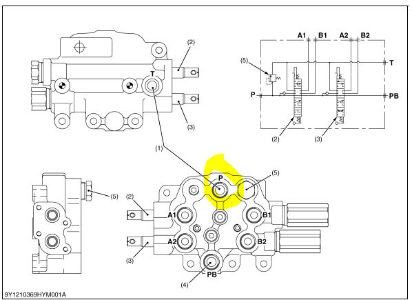

Hi,
I am posting here to seek information from people who might have got a similar issue.
Long story short I had my Kubota dealer install a Kubota 3rd funtcion kit on my L4740 hoping this would be an easy thing for them to do.
Boy was I ever wrong.
1st time they came, the Valve was missing from the kit.
2nd time they came with the wrong kit, they had the one for the Cabin model (L2227). The mechanic proceeded with the installation, stating that the pipes and connections were the same. Eventually when he got to the joystick.... he finally found out it was not the same thing.
3rd time he came back with the joystick and attached everything and left.
I went to try it out and to my surprise (or not that much really) the loader would not raise, the only way I could do this was by activating curl/tip at the same time and then the loader would lift or lower bucket..... doesn't make any sense.
They were supposed to come back today but when I called, the rep was sorry and said the mechanic had an issue with a previous appointment and they will come only next friday.
I checked my QD and they don t seem to be blocked.
Any idea what might be the problem? (else than my wonderful Kubota dealer.....).
Sorry for my English, it s not my primary language and honestly all this adventure over a 3 weeks span is really getting to me :(
Thanks in advance
-Dan

You mean to say they didn't fire up the tractor and check out the operation of the bucket and 3rd function system before they left? Unbelievable on their part!
I really can't help you out, but I would guess they had the hydraulic plumbing wrong.

/ 3rd Function kit intallation issue on a L4740 with a backhoe
Thanks to both of you.
I was working when they came in so I wasn`t there.....(big mistake it seems). I also was surprised that the mechanic did not check it before leaving. Fortunately I am off friday and if he comes I ll be watching for sure, ans they are not leaving until they test everything.
My assumption is also that something is incorrectly plumbed, I checked the assembly manual of my loader (fortunately I kept it since I bought the tractor) and the plumbing looks correct, however the manual doesn`t show the backhoe
plumber to the PB port of the loader valve.
The 3rd function is plumbed from the 'P' port to the hydraulic pump and the discharge (5 I believe) to the tank.
I ll try to take some pictures tomorrow and post them here.
Problem solved...... now I feel a little stupid.
The fender is still off the tractor and the problem was caused by the 3 point lever being pulled back too far (beyond the normal limit set by the slot when the cover is on the fender).
When I pushed it to it`s normal limit everything came back to normal. No leak down problem either it seems.
Thanks to you guys for hinting me in that direction.
