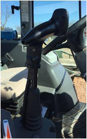

AWSubie, I don't want to hijack this thread, but I am doing a similar thing on my tractor. I looked at your parts list and went to greenpartsstore.com to see a picture of the part, but no luck... There are no pictures of the joystick grip. Can you post a couple of pictures of your handle/button setup?
Thanks!

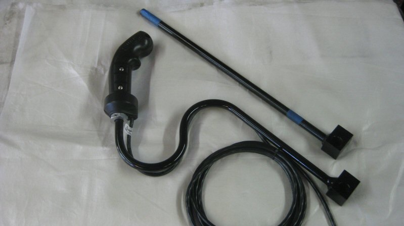

The kit appears to be reasonably priced with most everything you need. You would have to fabricate a mounting bracket. You should be able to get custom length hoses from discount hydraulics for <$100. It isn't clear how the control handle is supposed to be mounted though.
/ 3rd Function Help (kubota) #10
Easiest thing is to put 2 bends in the joystick lever to get the grip in the best position. Get rid of the S pictured and just have roughly a 45* and 90* bend. Gets the control grip in the perfect location. :thumbsup:

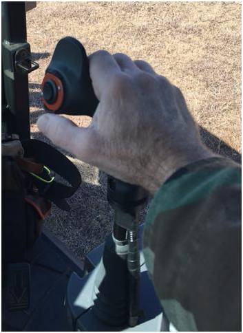

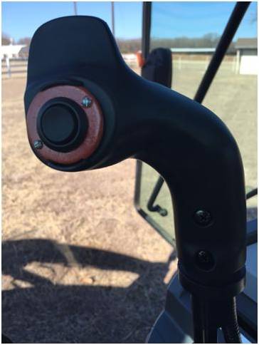

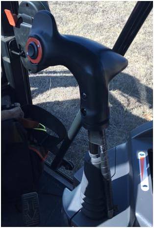

Deanocraft, here are pics of the John Deere Grip installed on a Kioti NX5010
/ 3rd Function Help (kubota) #12
Kit looks good, you might save a few dollars by sourcing everything on your own, but it’s really not worth it if your not sure what all you need anyway, plus having to build the brackets and such. As for mounting the handle, I used one similar on my kubota, I removed the knob and had to bend the a inch or two of the lever so the new handle was straight up and down, was very comfortable position.
