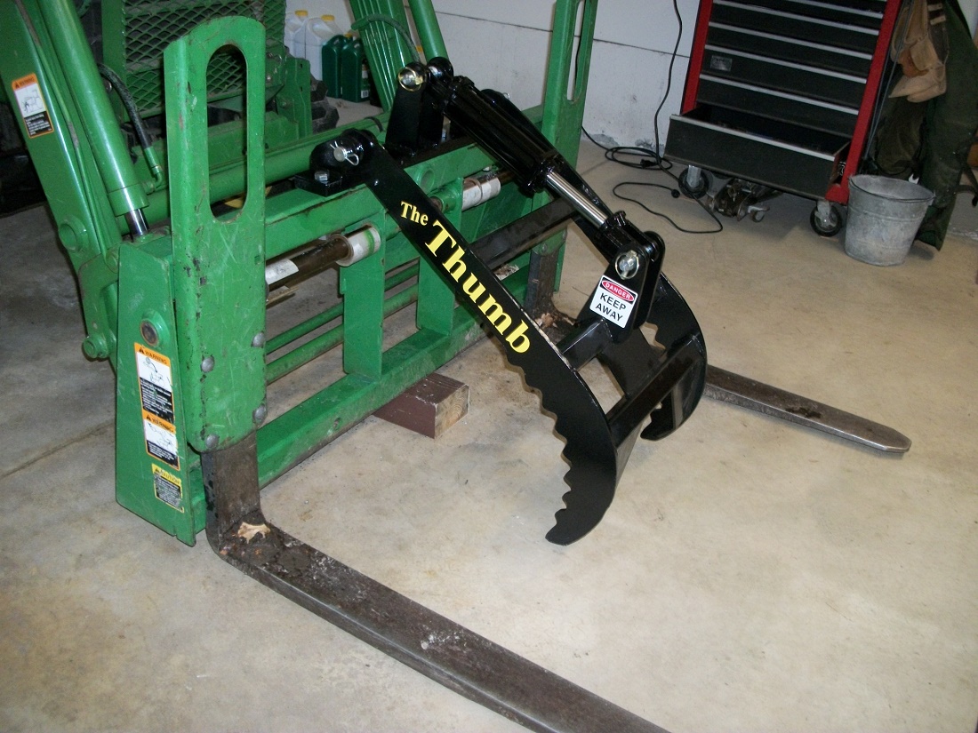

I just bought two male couplers JD part # AM105467 ($16.78) to couple with my 3rd SCV kit on my 4300. Would suspect yours would be the same.. This has the o-ring with 3/8 npt female.
Have added a thumb to my FEL forks and ran lines back to the rear 3rd SCV.

The part number you referenced is a 3/8" coupler. NPT do not use O-rings. It is an ORB fitting, size SAE 8 with 3/4-16 threads.
   / 3rd function coupler size? #4
Z
That is correct.. my bad. No o-ring.
