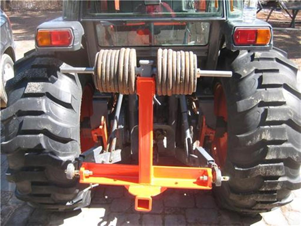

I need some rear weight to offset my 10LA loader on my TZ25.
The manual gives several options, this is an overview of those options;
Calcium Chloride filled tires @ 214lbs (107lbs ea wheel) + 475lbs on the 3pt hitch
OR
Rear wheel weights 150lbs (75lbs ea wheel) + 475lbs on the 3pt hitch
The weight I already have is a water - antifreeze mix which should be about 140lbs (70lbs each wheel) and 110lb wheel weights (55lbs ea wheel).

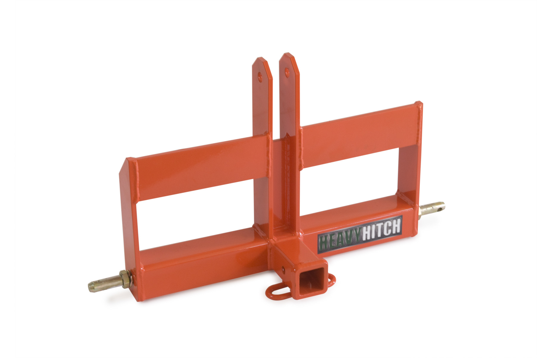

I want more than just a ballast box on the back, a usable hitch similar to or even the Heavy Hitch is what I am leaning towards. The problem with the Heavy Hitch is it is built for 336lbs (8 42lb suitcase weights) which leaves it about 150lbs light on the 3pt hitch and 100lbs light overall when considering my wheel weights.
So what other options are there? Is there another hitch similar to the Heavy Hitch that will take a little more weight?

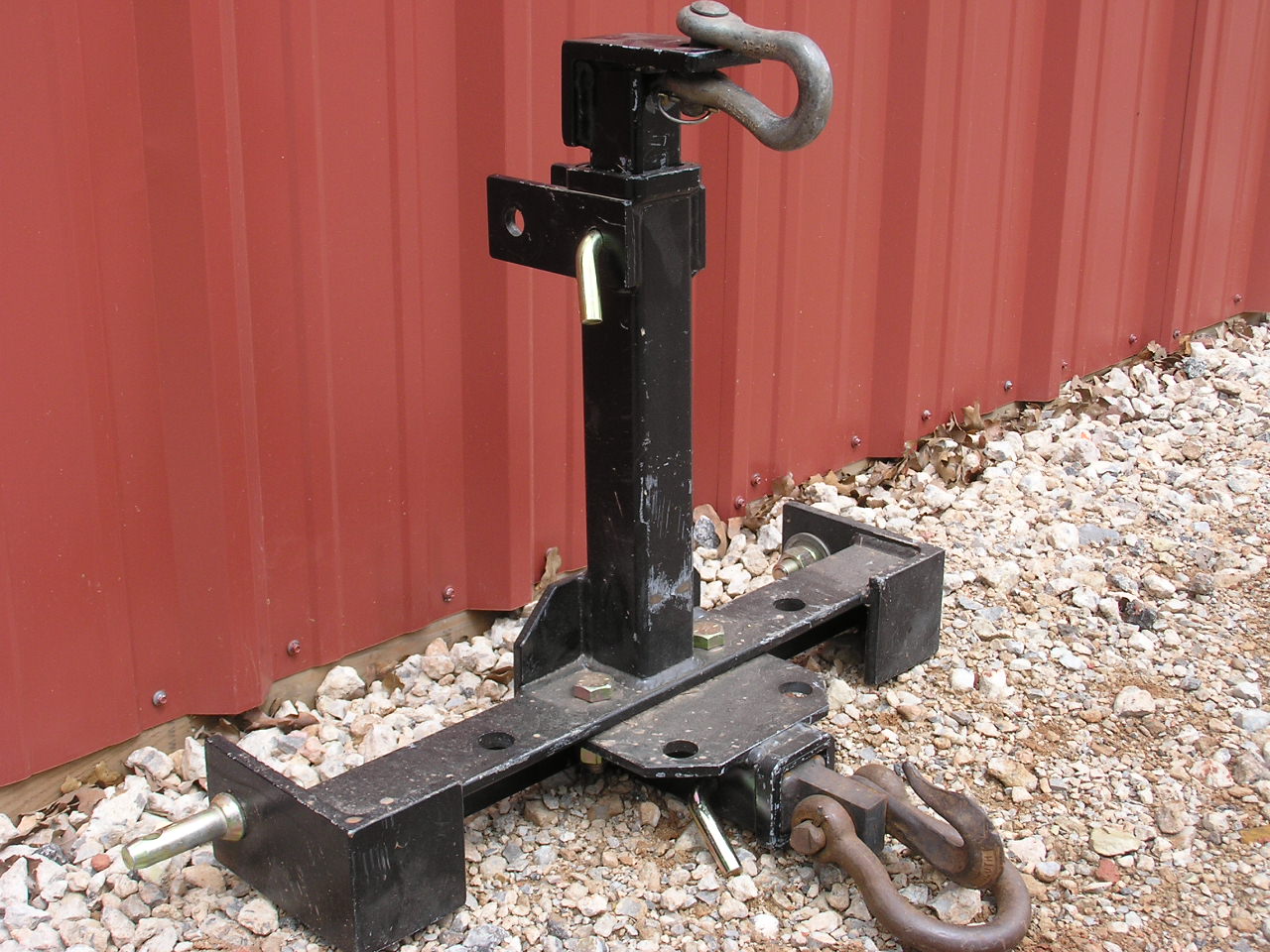

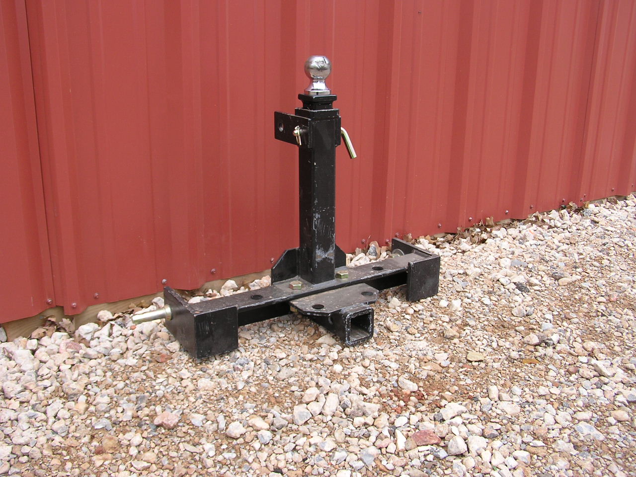

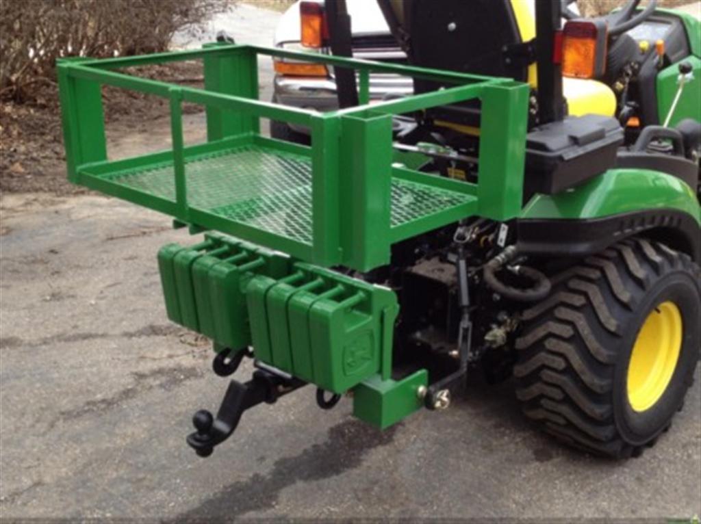

Lots of options here: OMNI Mfg LLC
909672 (Large) (1).jpg 4770535 (Large).jpg 4770538 (Large).jpg 4770540 (Large).jpg
I have the Transformer, Very versatile.

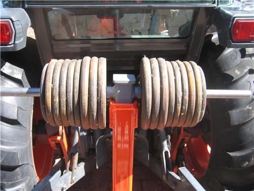

Xfaxman, I was wondering if you could direct me to where you can buy that bracket that you use the fitness weights on, or is it custom? I had that idea last week and was getting ready to weld something up, but I'm curious if its for sale somewhere.
/ 3pt Weight Bracket Options, Heavy Hitch, etc #8
The picture came from Omni Mfg several years ago, it fits their Combo Hitch or Transformer Hitch.
If you click the hitch, then click more images, it is there now as a close-up:
Contact Omni and check the price.
Thank you got getting back to me. I did search the site before I reached out, but didn't see it for sale any where and didn't know if I was missing something. I will reach out to them tomorrow and see if it's something they actually sell, or was it just a picture showing a possible use. Thanks again

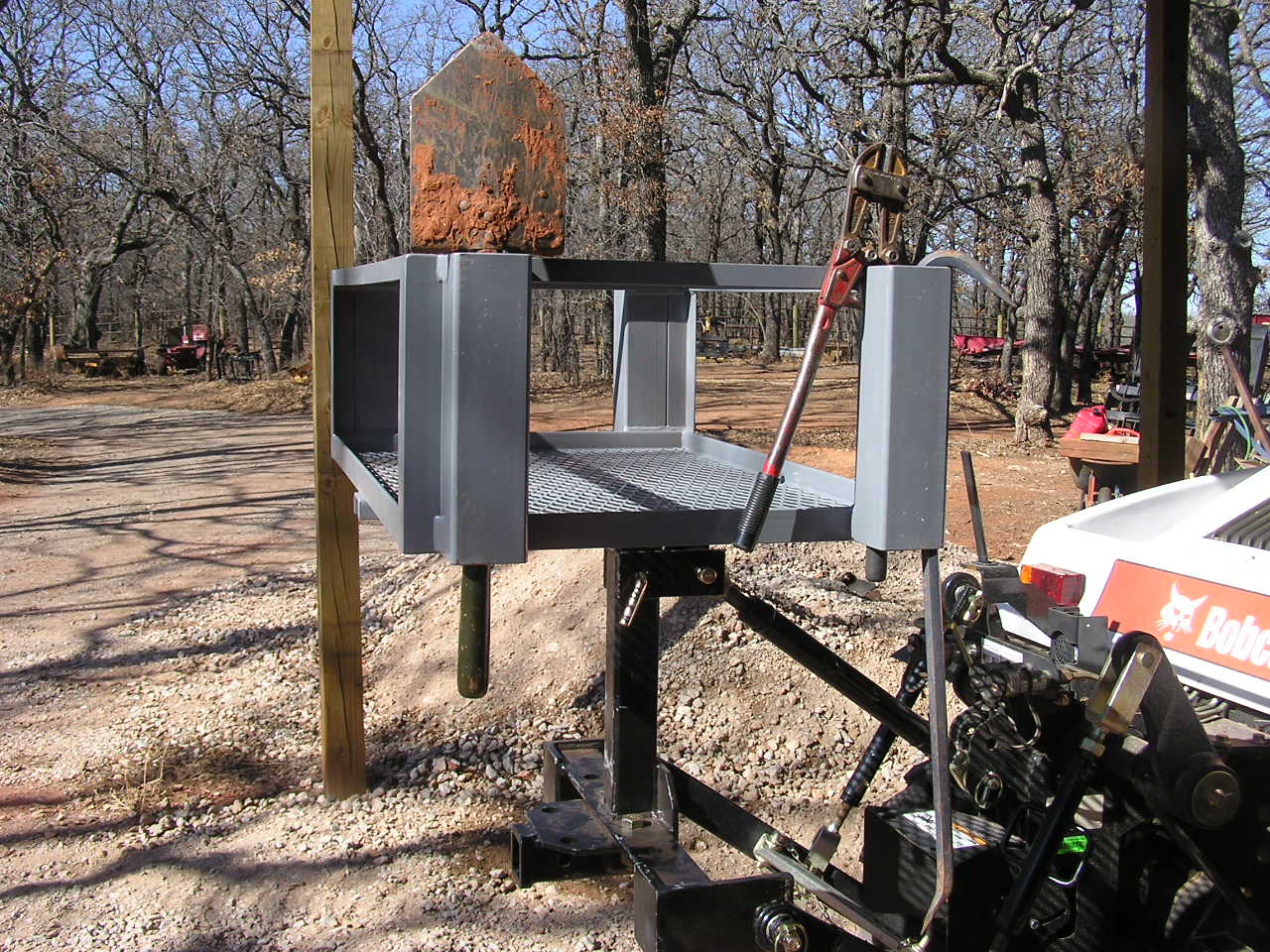

Just make something.... In my area barbell weights are hard to come by and expensive....
Dale

Have you checked into the HeavyHitch on Heavy Hitch.com? they have 4 different models that use suitcase weights.
