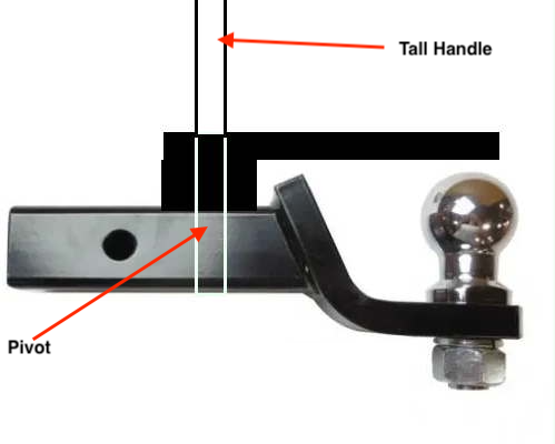

If I had flat land and trailers to shuffle around (not haul), I would build something like this to keep trailers from bouncing off the ball with the coupler unlatched.
A hitch insert with a strap passing about a 1/4 inch over the ball. The strap free to rotate by the action of a tall handle for the operator to reach. Maybe some short pins to make a lift, turn, and lock motion.

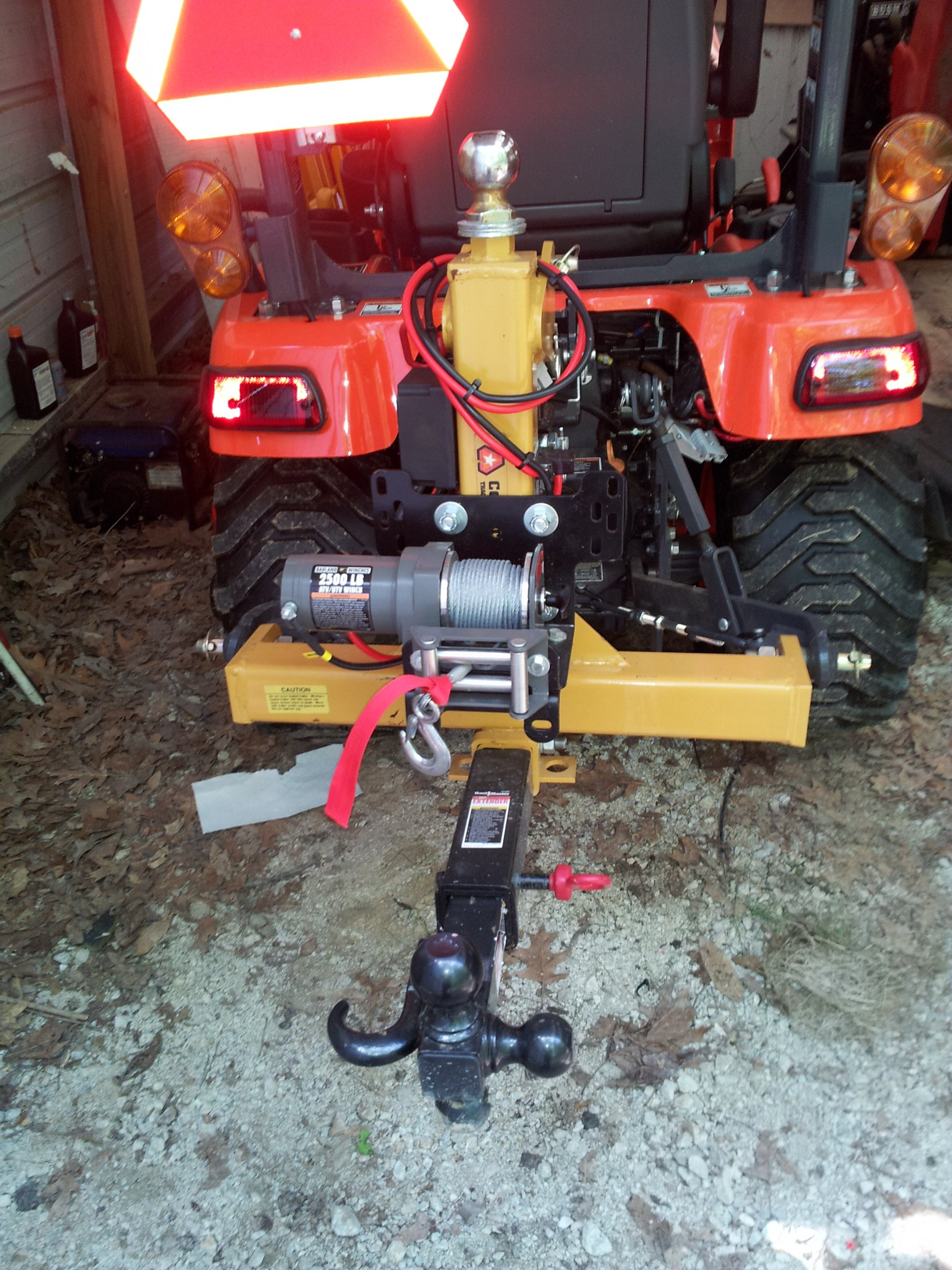

The king Kutter trailer movers come with a chain that you are supposed to use to anchor the hitch down. You can use the 3pt to scoop the trailer up and the chain to keep the hitch down.
However trailers should have tongue weight for proper balance when towing (9-15%) this would keep the tongue down for just jocking trailers around. If your loading and unloading trailers, or doing some more serious work, chaining it down, or using a stay strap to hold it down.
