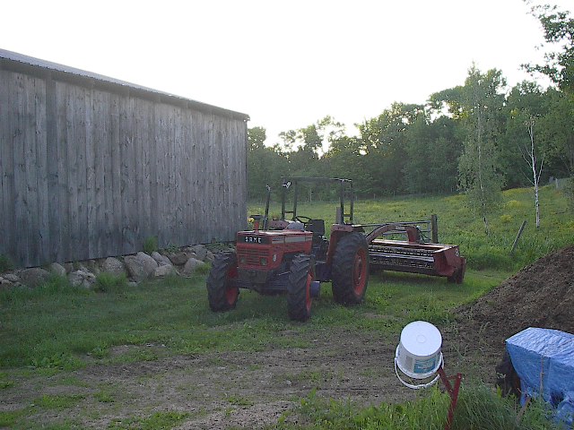

How wide is it?24 in wide could not get a 48 in through a 36 in gate or get into other tight places or go between rows in the garden!
My 3 point tiller is 48'' wide.My 3pt tiller was 5 ft wide!
I can haul the tilled up dirt away much faster with the 48'' fel on the BX23 than I can till it up with the 48'' tiller .and I can haul away tilled dirt and your BX23 with my JD 510 backhoe with a 80 in bucket!
There is just no way a 16 to 24 inch wide walk behind tiller can keep up with the BX23.[/QU YOUR RIGHT! But he asked for help in choosing what kind of tiller and I gave my opinion on the facts.You can buy a used Troy Built for 350-400 bucks electric start.and from the description he gave I thought this would be a sound choice to begin with for cheap money.
and there is no way your BX23 can keep up to a SAME DRAGO cutting grass .
Let's compare apples to apples.
