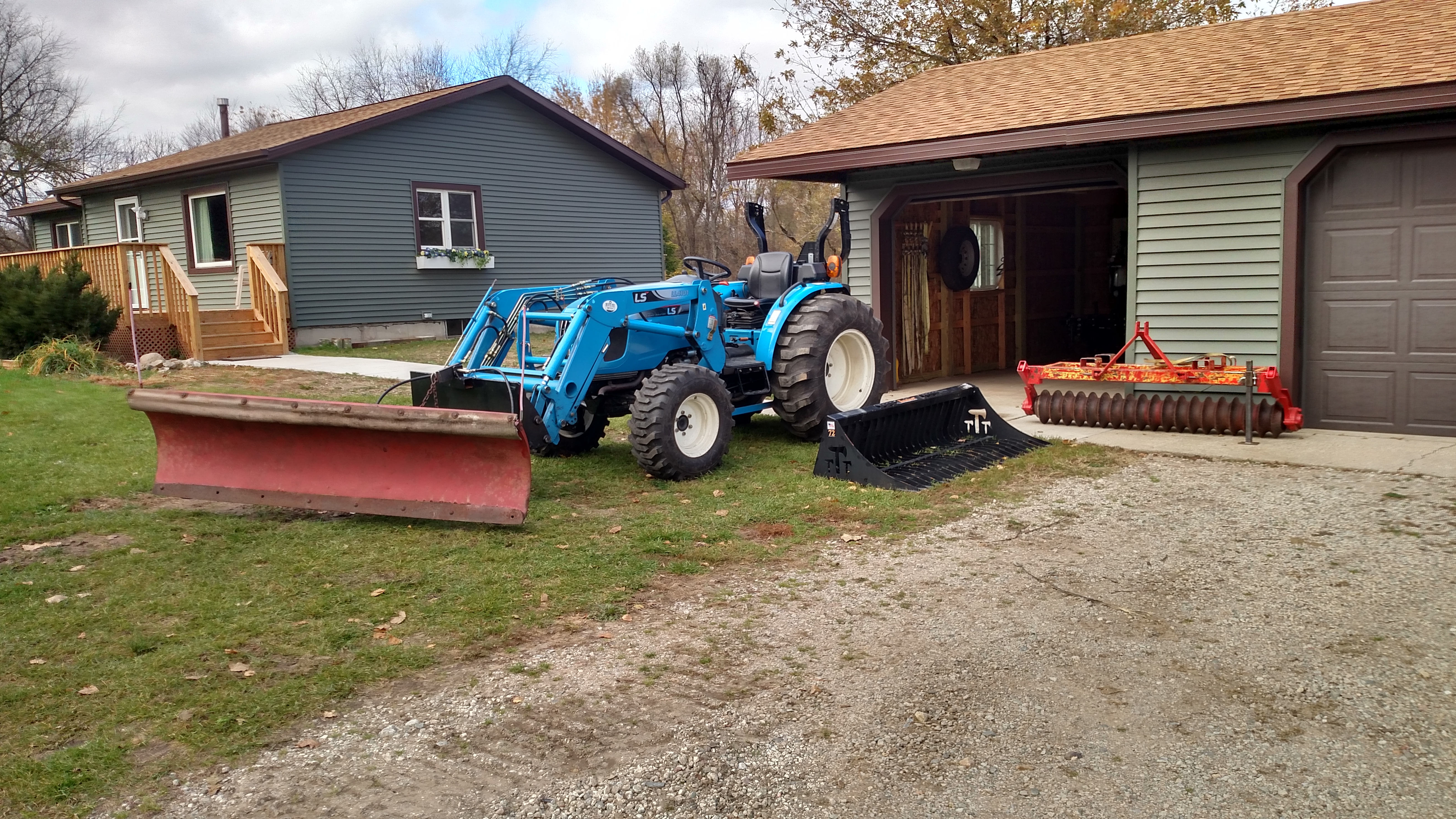

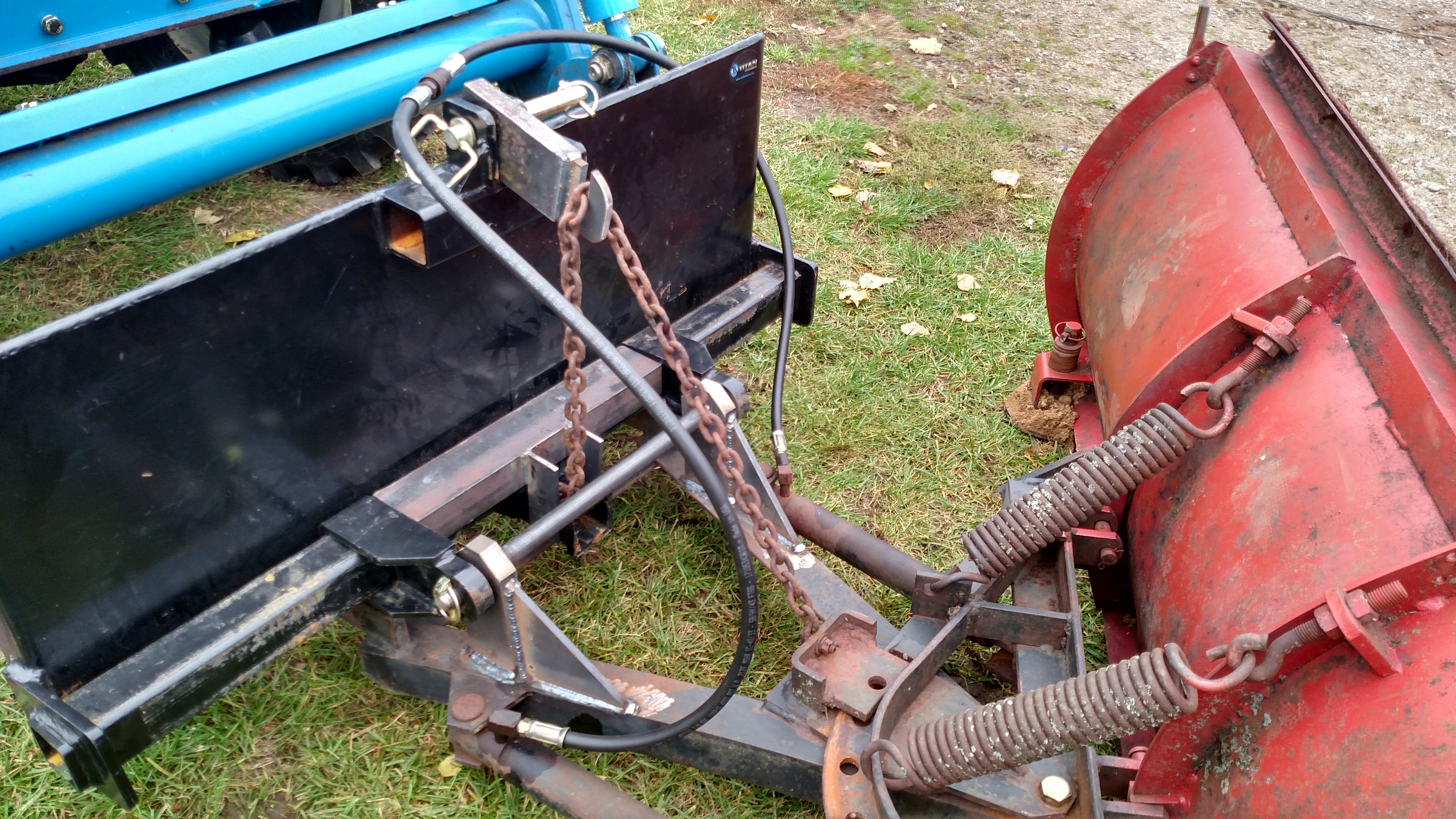

not really totally a three point still have the chain but sure could rig something up, Anyhow used a titan
quick attach 3 pt adapter plate, came off plow A frame with some ears, with gussets and welded a solid bar
across both ears for lift arms and a notched peace for the chain turned out pretty good still need to get the
   / 3pt snow plow #2
That looks good;float the plow.Very similar to the way I did mine.
   / 3pt snow plow
yes float the plow just like intended still sticks out a bit but is about a foot shorter im happy with it just see
how it works with the first snow. and im ready for it or not lol don't need to rush it
   / 3pt snow plow #4
May want to run some weight on the back,that cultipacker would work.
I use a 7ft.rear blade also;nice to pull snow away from buildings.
   / 3pt snow plow
you are rite about some weight would like to load the tires but I haul it around a lot
and its already a load. cultipacker would do the trick also chains
