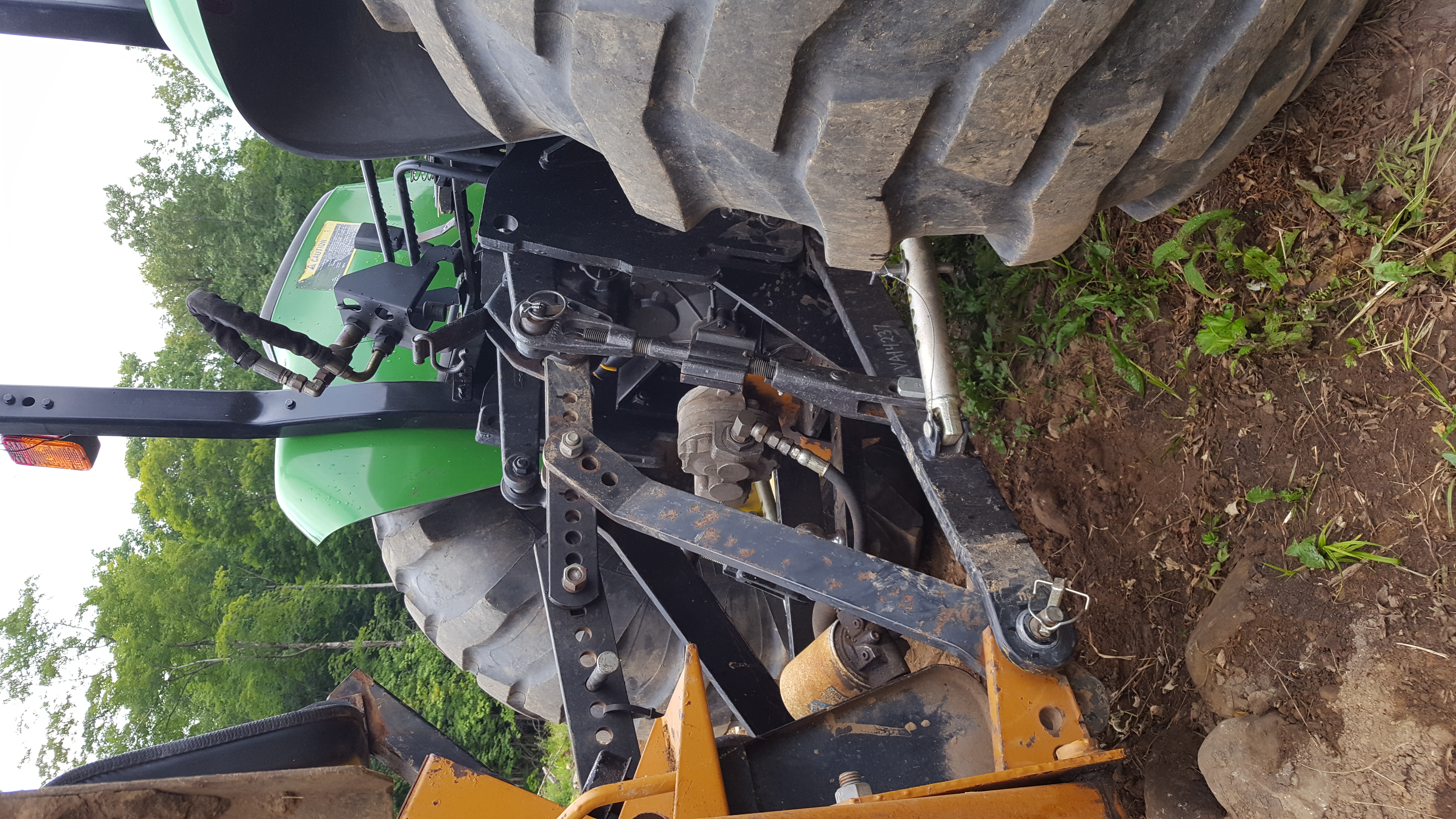

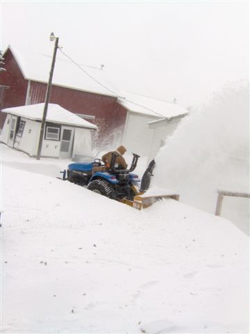

I feel the rear mount push blower has proven it works. I have more confidence it will get the job done. And I feel I will be able to handle larger amounts of snow. I don't want to gamble on a pull behind. My tractor width of 79", forces me to power a larger blower than my tractor might not handle well. And another thing is price! That always plays into it.
Sorry for that terrible pic.
/ 3pt Rear Snow blower #43
Thanks for the photo I requested. Nice backhoe setup with a pto driven pump.
So much better than running one of the tractor's own hydraulics.
If the 3 pt lower arms were free of the backhoe would they go lower to the ground and if so could you guess a height above the ground that they would be so .that dimension can be compared to the attachment points of the two blowers you are looking at.
There is a hydraulic hose looped near the roll bar. Do you need it looped and what does it do as the ends are the only rear remote looking connection?

I never used or played with the rear connections. I was going to go with a crank control on the blower.
Thanks for the pic. Good job.
I should be able to give you a better estimate on the lower arms tomorrow.

Dave, I can drop my lower arms down to about 9" - 10".
I looked at both blower and from what I see the lift points are lower than the center of the fan, which, at 22" dia, is likely 12-13" above the ground so I don't see a problem with either blower being lifted up high by your 3 pt arms

This pic will show how high the lower arms will go.
