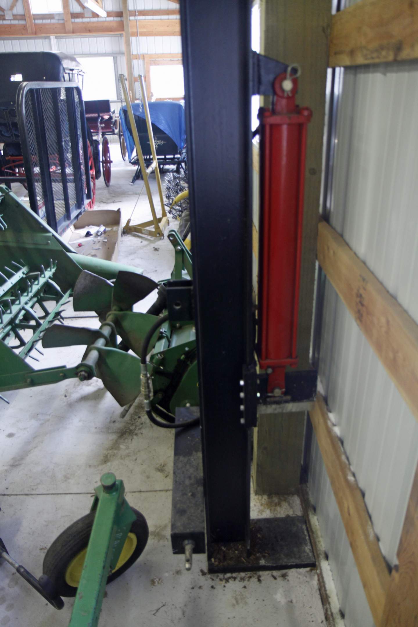

   / 3pt log splitter storage #5
can yours stand vertical? like mine. mine only takes up about 2 sq ft
I really do not think that it will stand up like that, but I am going to take a look tonight, that would helpful. I also like the idea of a cart on wheel, so I can roll it around.

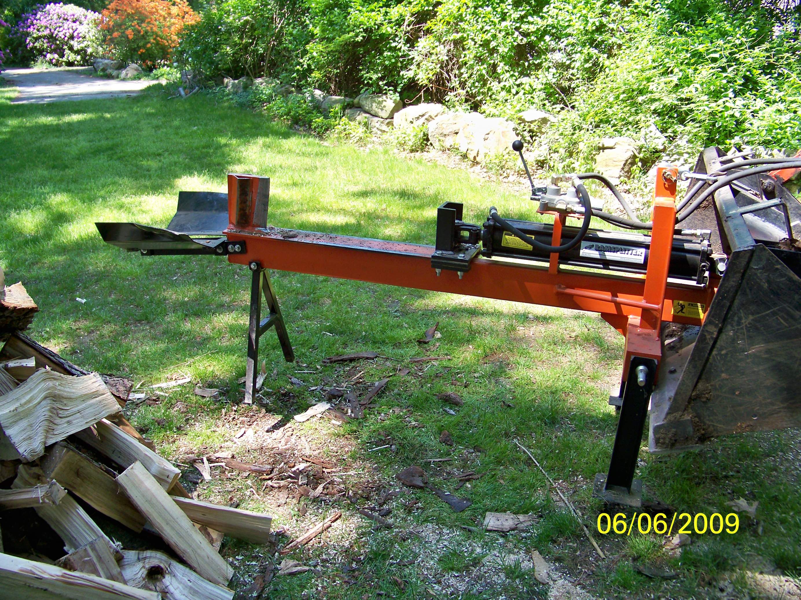

   / 3pt log splitter storage #9
When I got my rampsplitter in 08 I had them make two legs for the back that mount on the 3PT pins and one Y stand pinned on the front. The Y pin is removable so I can lower to the ground for bigger logs.
This setup is easily slid on the concrete floor - I store it on one side of barn - to hook up I slide it out, pin on the center hook, connect the HYD hoses and I am splitting. I have the B21 TLB so I use the BH connection for the Hyd lines - also means I can leave the BH attached.
Takes about 3 minutes to slide out, hook up and go.
Carl
Sweet, that is the one I have. I may call them about that, or learn to weld. :)
