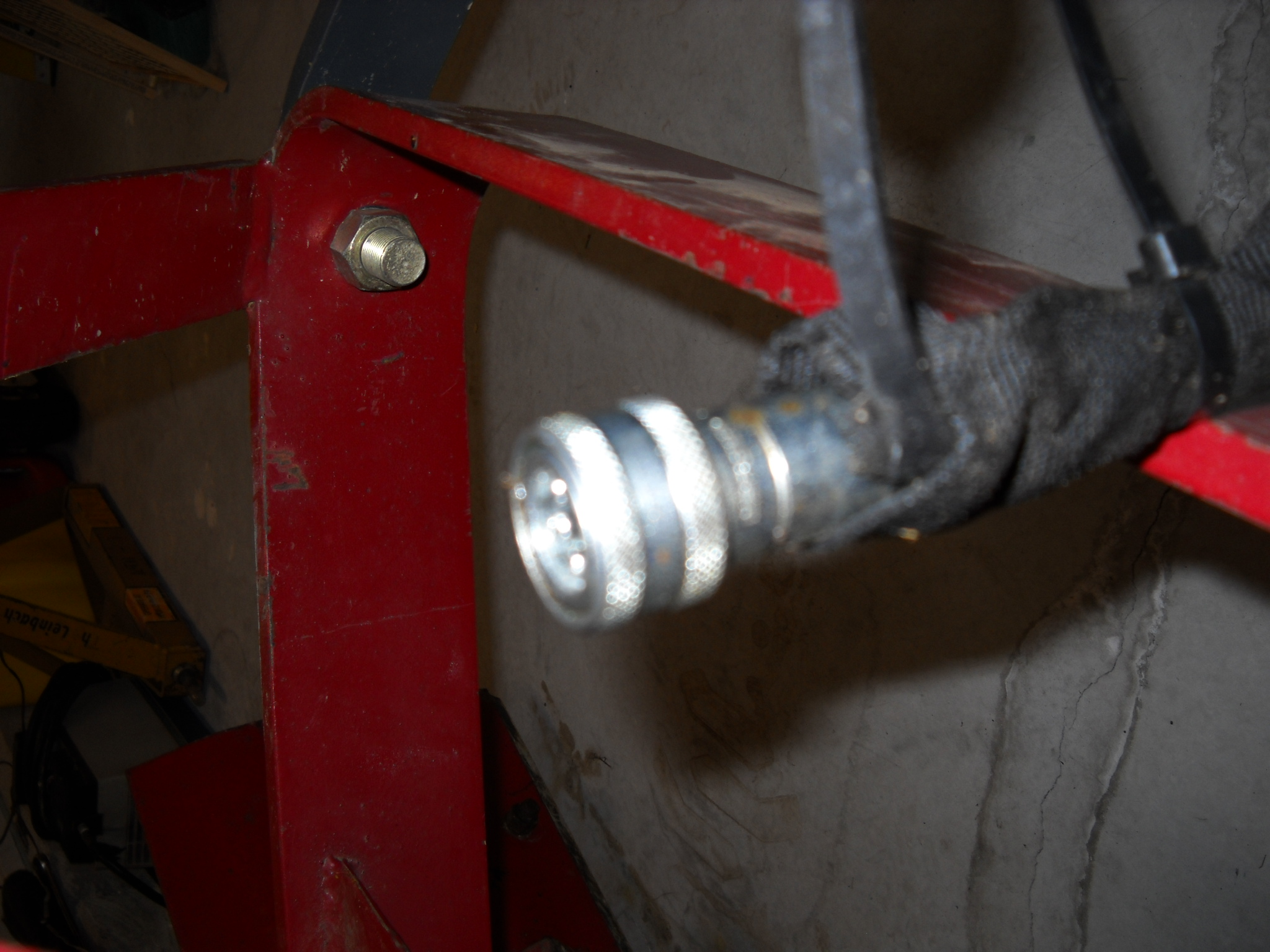

I got the splitter out of the wooden crate is was packed in (the thing is a beast!) and mounted it on the 3PH. Picked up a 5' and 4' hose at Tractor Supply. Probably could have gotten by with a 4' and 3' hose. Their hydraulic fitting selection was limited so I went to the Kubota dealer for the quick disconnect fittings. After attaching them to the hoses I realized they were not the right QD fittings. Drove all the way back to the Kubota dealer to get the right ones but they didn't have any. Too late on a Saturday to go anywhere else so it will have to wait. Hopefully I'll be able to find the right ones.
The QD fitting I bought was slightly different than what is on my tractor. The fitting on the bottom in the picture is the one I bought today. The one on top is from my tractor.
/ 3Pt log splitter off backhoe lines #23
The upper one is an "ISO 7241 series B".
The lower one is an "ISO 5675".
There is also an ""ISO 7241 series A", too. My Kioti and Bobcat uses them.
My JD uses series B. I have seen the 5675s, but never had them on any
of my tractors. Is Kubota using them now? My older Kubs used some
metric size, I don't remember. All three of these standard QDs are made
by all the major makers, as far as I know (Parker, Eaton, Pioneer, etc.). I
would NOT buy any of them at your tractor dealer. It turns out, they did
not even know the right type for your tractor, and they are prob 2x or 3x
as much as at DiscountHydHose.com.

Thank you! The first time I went to the Kubota dealer I didn't have the QD fitting with me. When I went back I took the male fitting off of the tractor to show him. He seemed a little puzzled. Strange since that is where I bought the tractor. They only had the male in stock and said there was no spot on the shelf for the female fitting. They have always been helpful in the past but not so much this time. I'll check out the JD dealer tomorrow morning. If he doesn't have it I'll order it online.

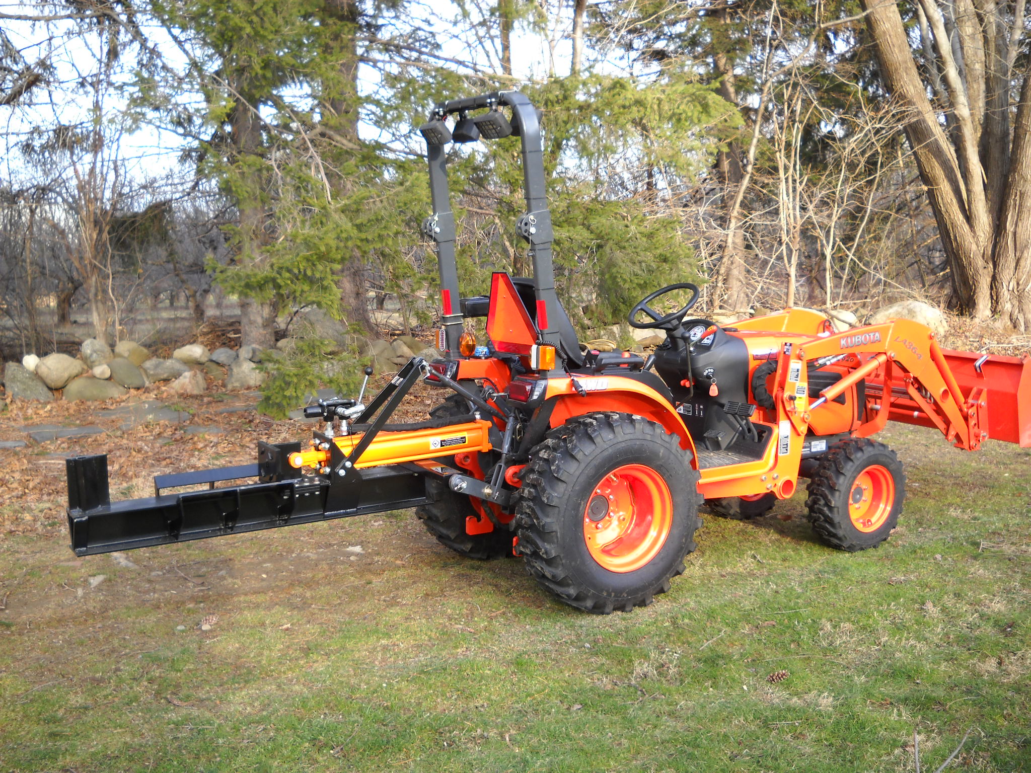

Took the day off today and finally got the HF log splitter hooked up. Went to the JD dealer to find the right QD coupler. They don't carry it:mad:. Went to the New Holland dealer - same:mad::mad:. So I 'borrowed' the fittings from my backhoe. I'll order new ones online and put them on the backhoe.
The splitter was easy to assemble and hook up. The only problem I had was that I didn't tighten one of the connections enough and had to clean up some hydraulic fluid off the barn floor. It works fine. I had no problems spliting the logs I had. It's not the fastest but I like that - keeps me from rushing and hurting myself.
Oh, on the Kubota L5030 with backhoe hydraulic connections you do not lose use of the 3PH when the splitter is attached. I can lower the splitter to load a larger log onto to the cradle.
I am very happy with the splitter. The low cost made it even better.
