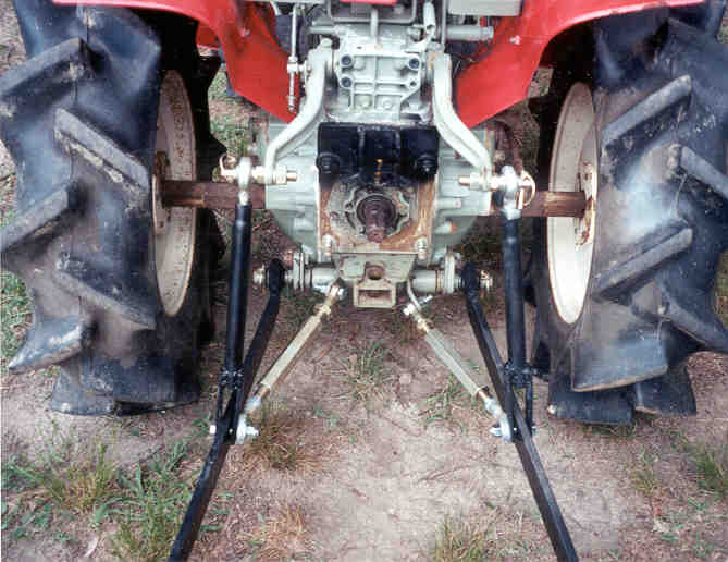

I meant converting grey market tractors with 2 pt tillers to a standard Cat 1 3 pt. I will be constructing all brackets from scratch and was wondering what others are doing
   / 3pt hitch #4
I converted my 2-point Yanmar (tiller equipped) to a 3-point. Made all of the parts myself but you can also buy many 3-point parts from dealers. I have some photos + drawings which I could post or send you if you are interested.

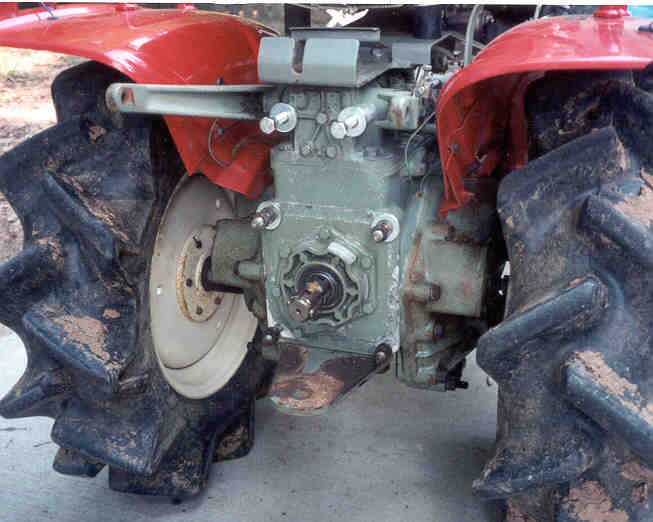

I can post some of the basic photos I have of hitches but this forum seems to have a restrictive size limit on posting drawings & photos. I have some detailed plans & marked-up photos of hitches & parts but they exceed the forum's size limit so I can't post them. I tried but they could not be posted. If you want to see the detailed stuff we will have to use snail-mail and photocopies. Which I am willing to do if you want to see them and if you are willing to pay the postage. Contact me via the private message feature and I'll try to help you. One photo attached to this message. It is rear end of my tractor when I first removed the tiller: dirty, rusty, two lift arms but no three point hitch.

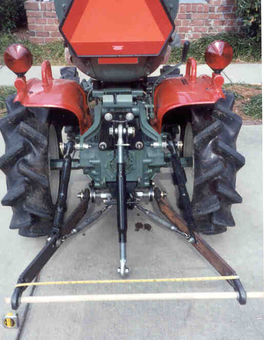

Photo of a 3-point on either a YM-1300 or 1500 at a roadside dealer's lot. This is what you often see locally fabricated to fit older YMs after the powered tiller is pulled off.

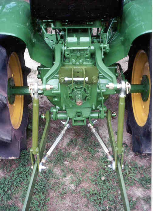

Here is another hitch. A lot of the dealers like to paint the older YMs "JD Green".
