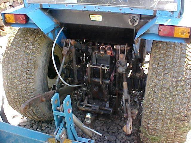

Mike,
Do you have a drawbar pickup hitch installed for a trailer.
On mine, the pickup hitch arms lift the drawbar hitch the last 0.5" of travel on the arms to operate the locking trip mechanism. I then have to drop the arms a fraction for the drawbar weight to be taken off the arms.
The attached photo might clarify my configuration
Nigel

   / 3PT Hitch valve doenst seem right. TC33D (New)
I dont have the the pick-up hitch you describe. I can see what will have to be adjusted and I think it will be easy but will call dealer and have them make sure. This tractor seems to have adjustments for everything but getting at them is the hard part. /forums/images/graemlins/grin.gif

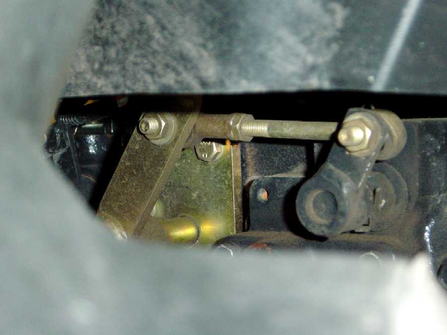

Roto,
There is a adjustment rod under the fender behind the rear tire. If you turn the adjusment nut to lengthen this rod it will fix the problem with the relief valve spitting off.
I have attached a pic so you can identify it. this pic was taken from in front of the tire.
hope this helps,
Thanks guys! The adjustment is shown in the owners manuel. I overlooked it the first time i went through it. It needed adjustment. Thanks again!
