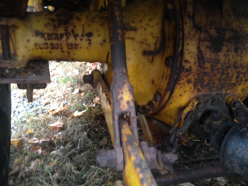

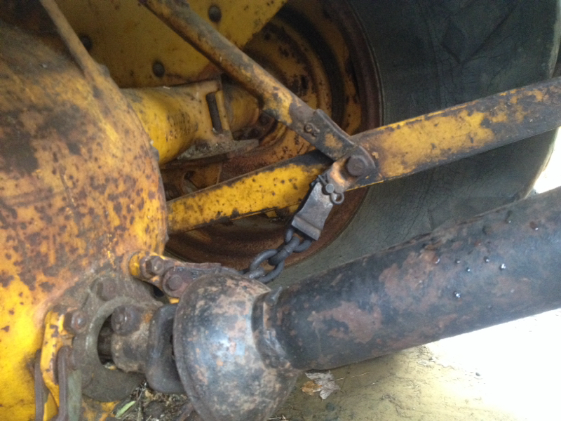

Ok, it's pouring rain here so I ran out real fast to snap a few poor quality pics. It looks like I have brackets on the bottom of my loader frame and there are circular wear patterns where the pins to mount stabilizers once lived.
Yesterday's tractors doesn't sell the heavy duty bars separately, standard duty are about $16/ea and the pins to mount them are about $3/ea so that's $38. The heavy duty set is $63, and comes with brackets I probably won't need/use.
Thoughts? Should I just get the heavy duty ones anyway (that's what I'm leaning towards)
Pics- if you look at the second pic and enlarge it, you'll see a large hole, then to the left in the pic (forward on the machine) you'll see the rusty brownish color surrounding the hole where I believe the pins would attach for the stabilzers. Looks as easy as bolt the pins in, and install the stabilizers.

Standard duty bars will do what you want them to do.
Buy the pins & bars & go to work.

Yes, I think I can just see the hole in the 2nd pic, just in the background where the lift arm goes behind the axle housing and rear casing. In that area your loader frame looks quite different to mine. That makes your job a lot easier - just fitting forward mount pins and bars. :thumbsup:
Whichever bars you choose all depends on what they will have to contend with - standard bars will be sufficient unless you work frequently in rough or uneven ground, whilst carrying very heavy implements. Given that they are available separately, I'd tend to agree with LD's statement above. Should one break - which I'd say, even though they're non-genuine parts, is unlikely - place a small wager on their quality and go with that.
Remember, it is essential the length matches the lift arm length - measure the centre-to-centre length and ensure they match, or they just will not fit. Sounds like you might need an umbrella :D

My property is uneven, but not so much that it worries me. It's not very rough, and I don't drive quickly with heavy implements so I agree with you both that the standard duty bars should be sufficient.
I ran out and measured, they're about 33.5" center to center, the individual bars are 33.125" center to center, but one side is oblong so I should be good. I've ordered them along with some pins so hopefully by next weekend they'll show up and I can install them.
I'll update with pics once they show up and give my opinion after handling them.
