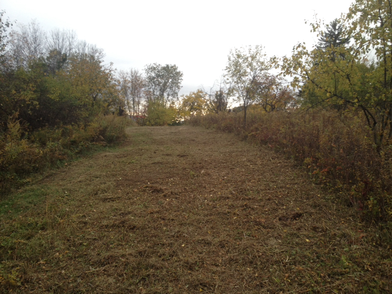

I'll snap a pic of my setup this weekend so we can remove all doubt as to what I'm working with here. In the meantime, here's a pic of the machine while I was mowing my field late yesterday, and an experiment with scalping 4'+ high brush down to 1/2"! (Slow moving but looks great!) I increased cut height to the max of 5" after the second pic was taken. In the first pic you can see it's much rougher in the foreground, that's 5" cut height and looks more like a brush hog/slasher style cut

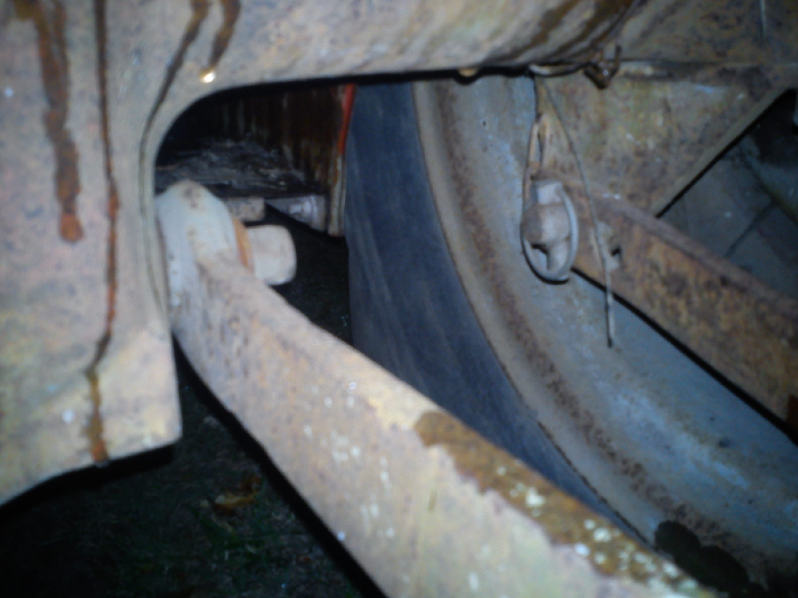

Here is what I have.
To show original equipment - our 135 is an agricultural spec tractor and thus equipped with swaybars ex factory.
Note the 3rd hole I mentioned earlier to suit 31.5" lift arms on earlier models.

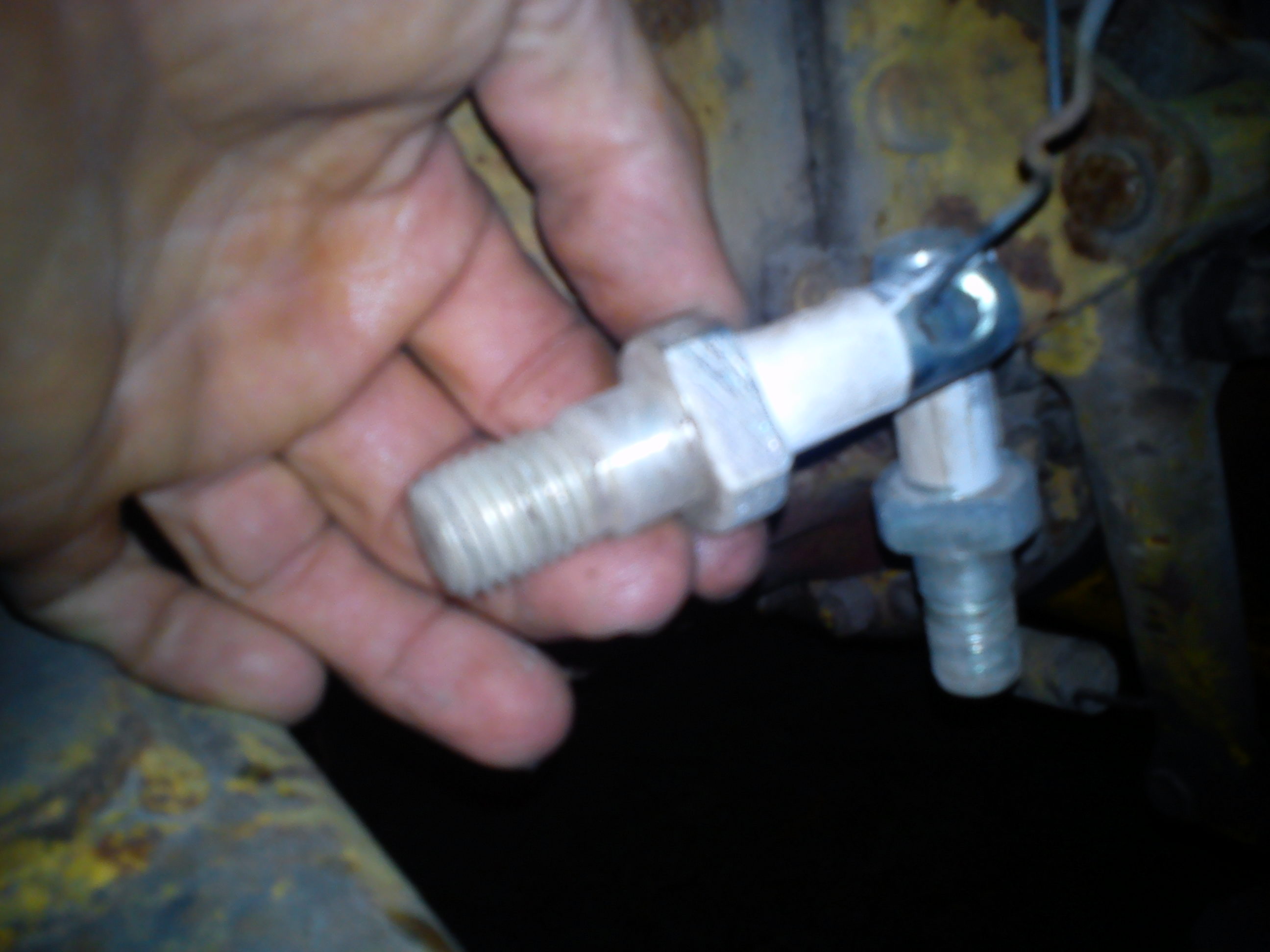

Here is my set-up on the loader - currently a case of "Necessity is the mother of invention" :thumbsup: to an extent, because the lack of stabilisers and check-chains was directly the cause of my breaking the RH lift arm mount. I had temporarily fashioned check-chains - which attach to brackets on the studs around the PTO shaft - which I thought were sufficient, but overlooked that they are not as tight when the arms are at mid-height. I was unfortunate to not realise that, but won't forget it in a hurry! :ashamed:
After renewing that mount and repairing the brake on that side (co-incidentally the one that didn't work) I found the lift arms were the same length as our 35. The loader frame where it attaches to the rear axles has a series of 5/8" holes drilled in the inside edges, one of which lines up almost exactly with the lift arm mounts. A pair of strong 5/8" bolts, two pieces of 5/8" ID 7/8" OD steel tube about 7/16" long allowed me to bolt them as shown below. Bolts are tight against the tubing so holes don't elongate and works very nicely. Last pic shows proper bolt-in mounts with 5/8" shanks - yet to be fitted. :rolleyes:
If your loader frame is similar, this may be your best solution. On my machine the factory mount brackets cannot be installed if the loader frame is fitted. Hope this helps. :drink:
