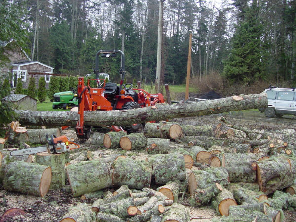

Greg, Do you have any pics of your BH ? I would like a BH for my B7500 when I can afford one.
Donny
   / 3pt Backhoe #14
Don716,
There are a couple of pictures of it in a current thread on Owning/Operating- "Tree Removal". I've also attached another photo of it.
Greg
