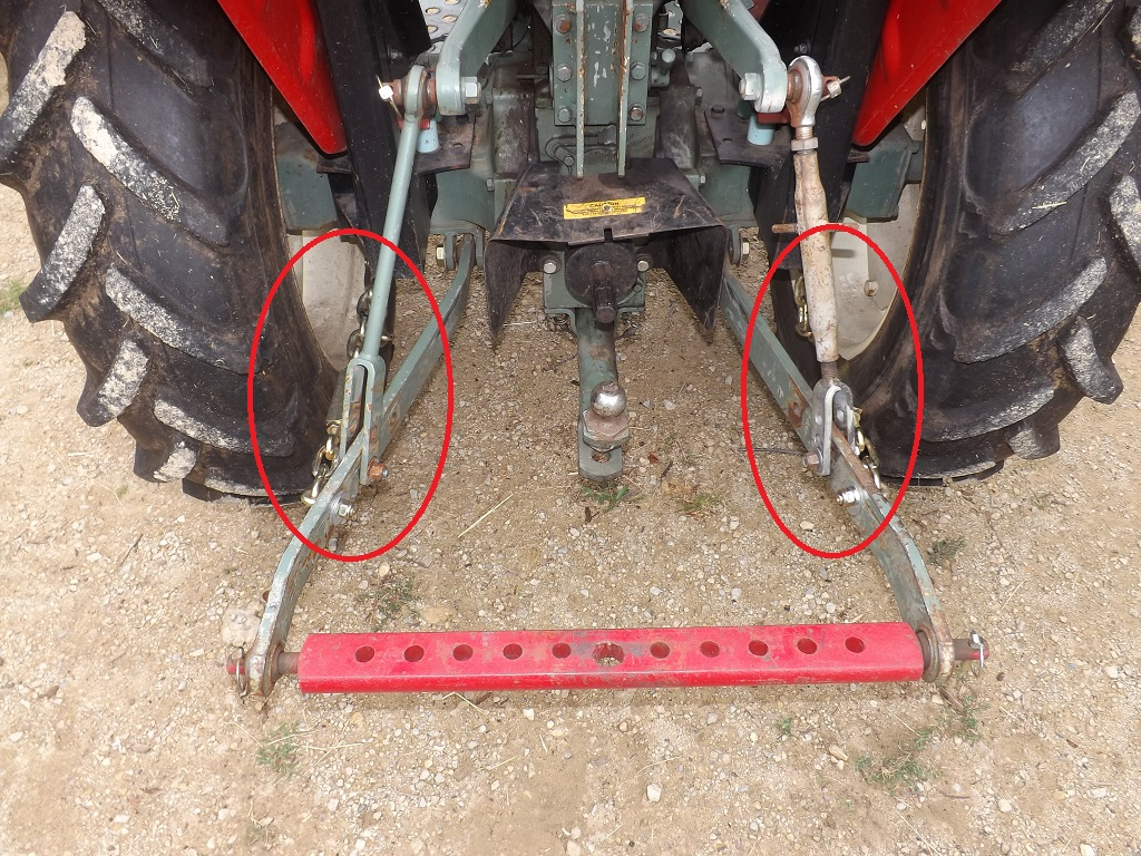

Mar 14, 2023 / 3pt Auger #1 C ClintStein New member Joined Mar 14, 2023 Messages 3 Tractor John Deere 5065E why does my auger sway left and right when trying to dig?
Mar 17, 2023 / 3pt Auger #2 bmaverick Super Member Joined Sep 17, 2013 Messages 7,345 Location Beloit-WI Tractor Yanmar YM2610 ■YANMAR GURU■ EXTRAORDINAIRE ClintStein said: why does my auger sway left and right when trying to dig? Click to expand... Because the lower 3PT arms don't have the chains tight enough to prevent swaying.

Mar 17, 2023 / 3pt Auger #3 D diesel85 Veteran Member Joined Jun 7, 2017 Messages 1,209 Location Vernon, NY Tractor Kubota BX2200 Yes, you need to make sure your check chains are nice and tight for that application. Same goes for things like snow blowers.
