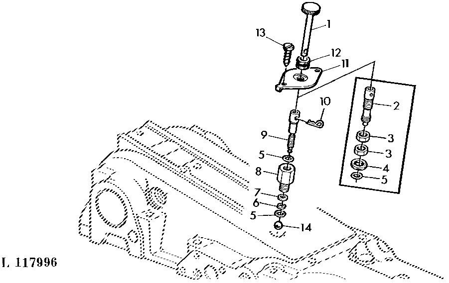

Have you checked the adjustment of the 3pt "drop rate" knob? Should be a knurled yellow knob that controls how fast the 3pt will drop. If it's too tight; can also affect the time to raise the arms, too.
'Course, when it's cold; everything is slower to respond cause the hyd oil is thicker. Depends upon just how cold it is..

Is the drop rate knob just in front of the seat, if so my 2140 is missing that knob but I can turn without it.
By cold I mean the ambient air temperature is about 10 degrees Celsius here in N.Z in the mornings, Autumn at the moment. My other tractors are fine, they respond instantly but this just seems like there is an issue.

Have you checked the adjustment of the 3pt "drop rate" knob? Should be a knurled yellow knob that controls how fast the 3pt will drop. If it's too tight; can also affect the time to raise the arms, too.AKfish
Rate of drop screw on a 2140 has no affect on raising 3pt only lowering speed. parts key #14(ball)sits over return orifice but not pressure orifice

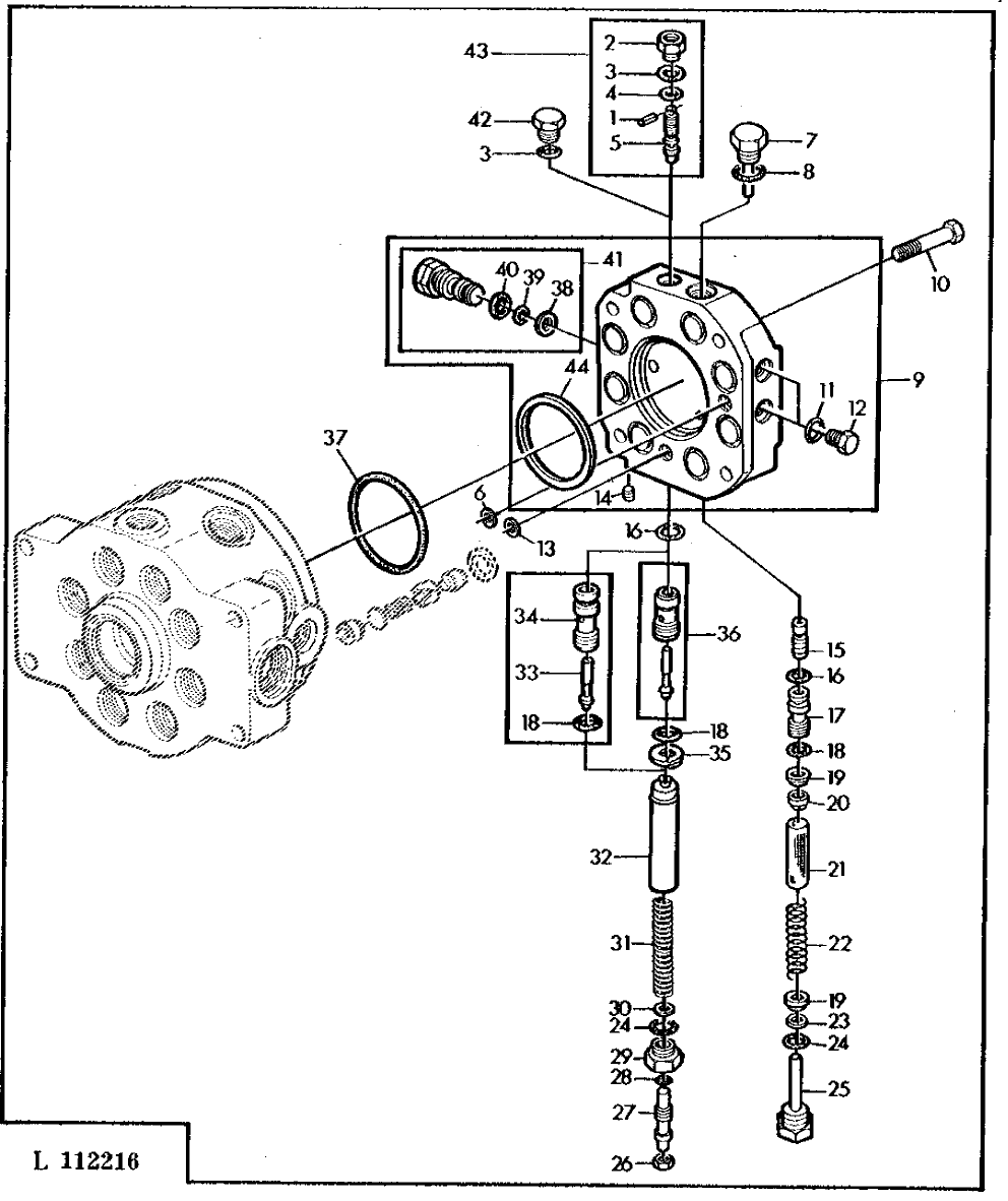

Have you checked/cleaned the filter screen(R27173,parts key #21) in frt hyd pump??? I'd also recommend checking stand-by pressure. Should be 2250 psi. I'd also recommend setting L/D control lever in "D"

#11
JD 2140
No haven't checked or cleaned it before, will have a look at it today.
Sorry but what do you mean by setting L/D control lever in "D" ?
/ 3point linkage arms slow #12
Lever(parts key #1) should have 3 marked settings. L-LD-D
