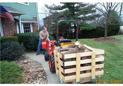

/ 3ph wood hauler?? #5
WiJC.. Attached is a picture of a TSC carryall that I use for transporting firewood. It has removable sides so it is easy to load and unload. I made a dolly for it so I can leave it loaded and roll it around my garage. The dolly also makes it easy to install and remove.
John
