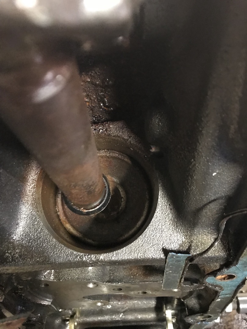

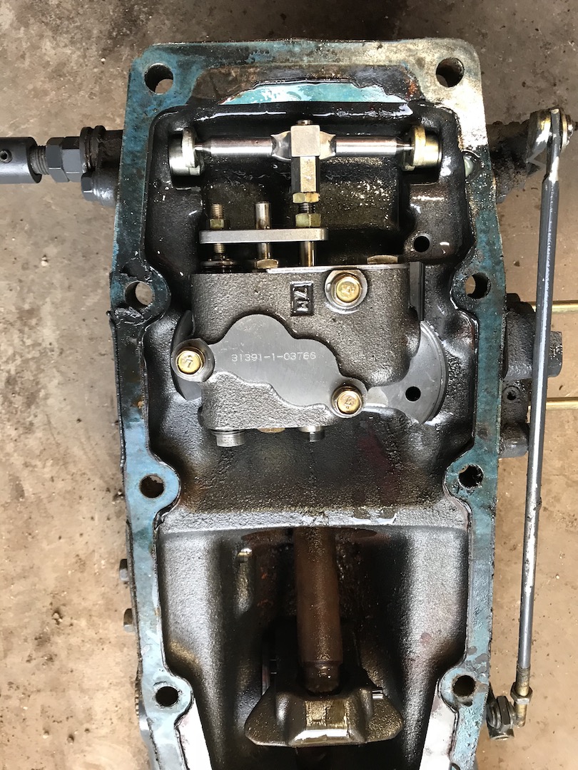

Tractor is a L2600DT. Fluid is good but the 3PH won't raise. I have removed the tranny cover and inspected the control valve. When the valve is removed, I can blow compressed air into one of the ports and it does raise the lift arms while on the bench. But when I do this with the control valve on, it does not.

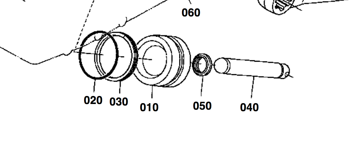

Also, looking at the parts diagram, I don't have the hydraulic piston and 2 orings in the picture attached. This is from the l2600DT parts book. Should I?
