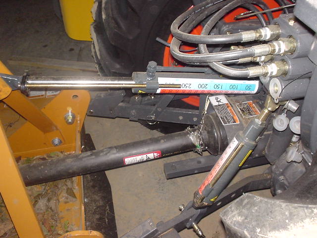

I ordered my L4330 with the Kubota/Gearmore T&T, returned them for credit, and replaced them with some aftermarket ones that were better for several reasons. These aftermarket ones have a length adjustment on the sidelink that lets you coarse adjust the overall length for various size tractors. That way you aren't using up the limited cylinder stroke. Instead of the eyelet being directly welded to the cylinder's rod, it's part of an "eyebolt" that threads into a threaded cylinder rod. see picture.

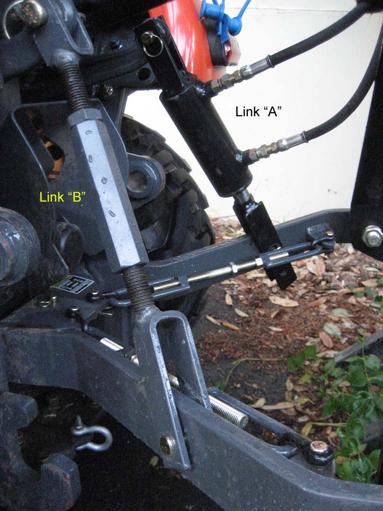

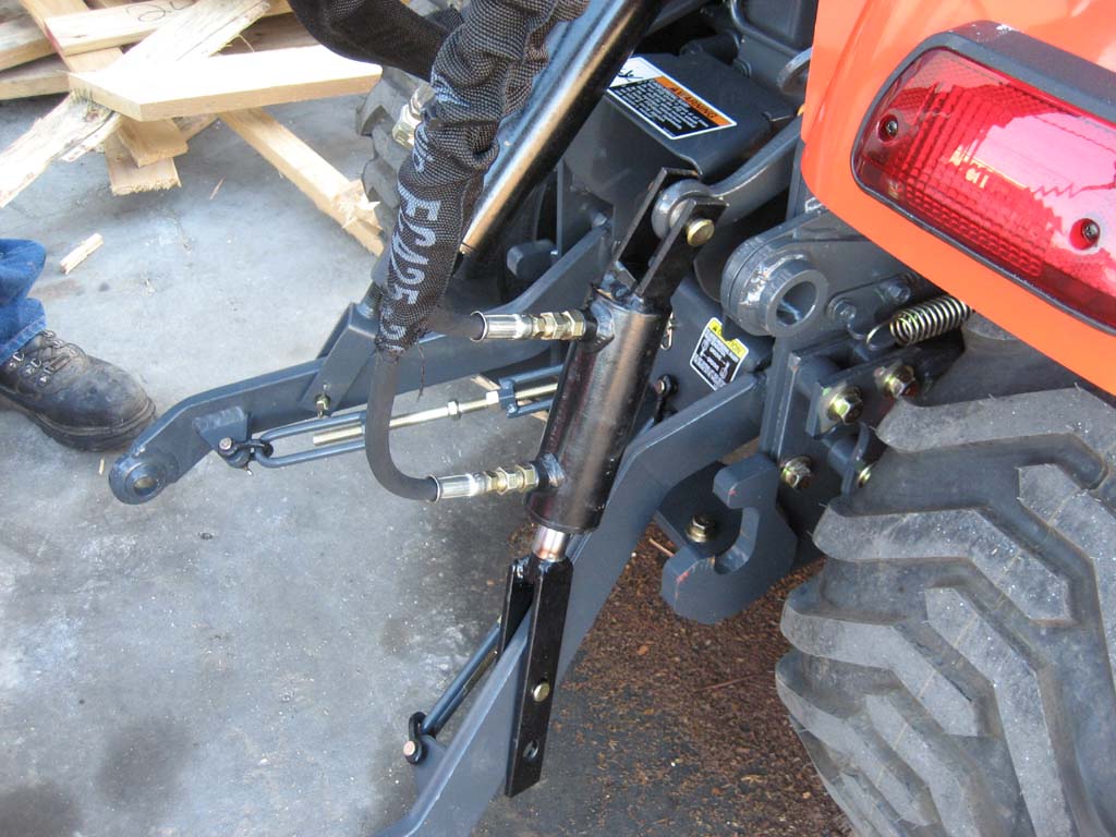

jmc: I had exactly the same thought when I asked "What about if I need to tilt the left side of the box down?" and he replied "Just turn around an go the other way.". Excuse me! This is the Santa Cruz Mountains we're talking about, not a bloody soccer field! My property has geographic features than often dictate travelling in one direction only.
I'm attaching a couple of pics of the adjustable and hydraulic links. You can see the attachment point on the top of the side cylinder is substantially further from the cylinder body than on the factory adjustable link. I think it could be about an inch closer. Also, there is room to move the lower attachment point upward by at least an inch. Should be able to get the hydraulic link about 2 inches shorter with just a little drilling and welding.
I took some measurements today at lunch and I think there is enough clearance that if the cylinders attachment holes in the clevises welded to the cylinder are relocated (maybe with some welding to re-enforce the remaining metal), I can get the mid-point of the cylinder travel pretty close to the standard fixed length link, then by using the factory adjustable link I can fine tune the level position. Then I would have pretty close to equal travel in both directions.
In looking at your pictures, I noticed the bottom fork on your hydraulic sidelink is almost bottomed out against the lower lift arm due to the angle as the lift arm goes to its lowest position. However, the upper fork going to the link ball could be redrilled to make the whole sidelink at least 1" shorter without causing any interference at any angle. That would be an easy fix and probably the first one I would try.
/ 3PH top-and-tilt setup and use #10
Be careful with moving the hole in the clevis too far up the side. The reason for the gap between the top of the clevis and the hole is to allow the lift arm clearance for moving up and down. If the hole is too high in the clevis, the clevis will bottom out on the lift arm as the angle changes.
Take your three point through a full up and down cycle and see how much clearance you need before re-drilling the holes.

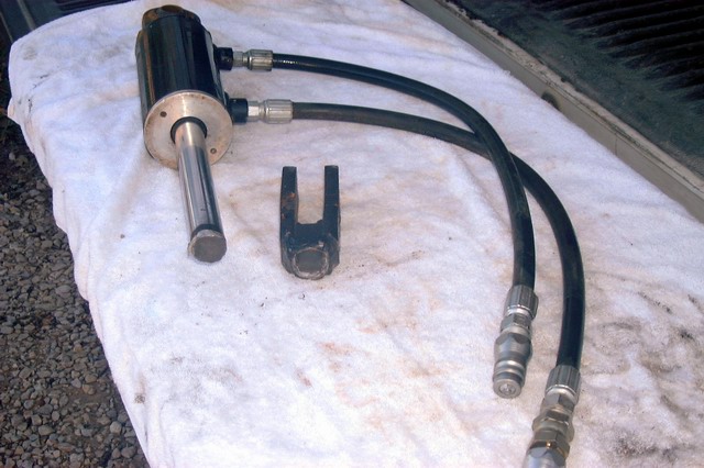

Exactly! The attached photo is what happens when the clevis bottoms out.:eek:
