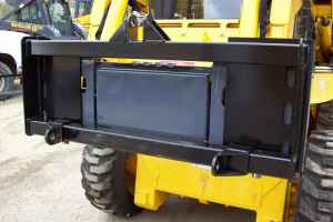

Anyone have any pics of these? I want to try and build one for various reasons. One reason is to put my front blade on the rear for snow plowing, another is to be able to use my forks, grapple or bucket on the rear while using another attachment on the front. ATI has a picture of one on their website but its not big enough to really see any details. I'm trying to copy off something instaed of trial and error as I usually do. Any thoughts, comments or pictures would be appreciated.
Thanks
Steve

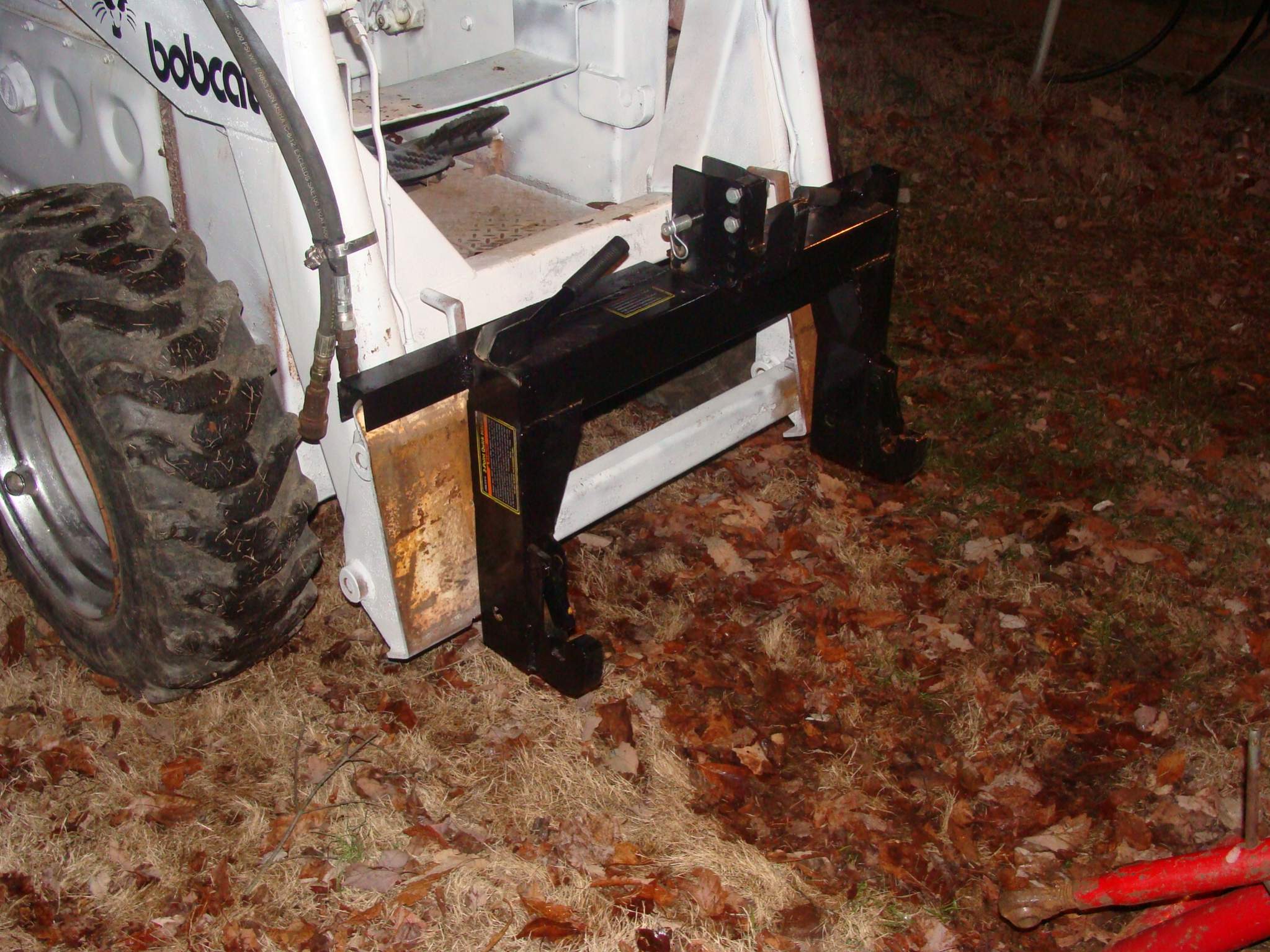

I use this in reverse, I have a 3pt to skid adapter which I use to mount 3pt equipment on my FEL. I salvaged it off a backhoe I converted back to a 3pt mount. I can snap some pics of it if you want but it's not pretty... Here are some you can find on ebay;

Like this or the other way around?

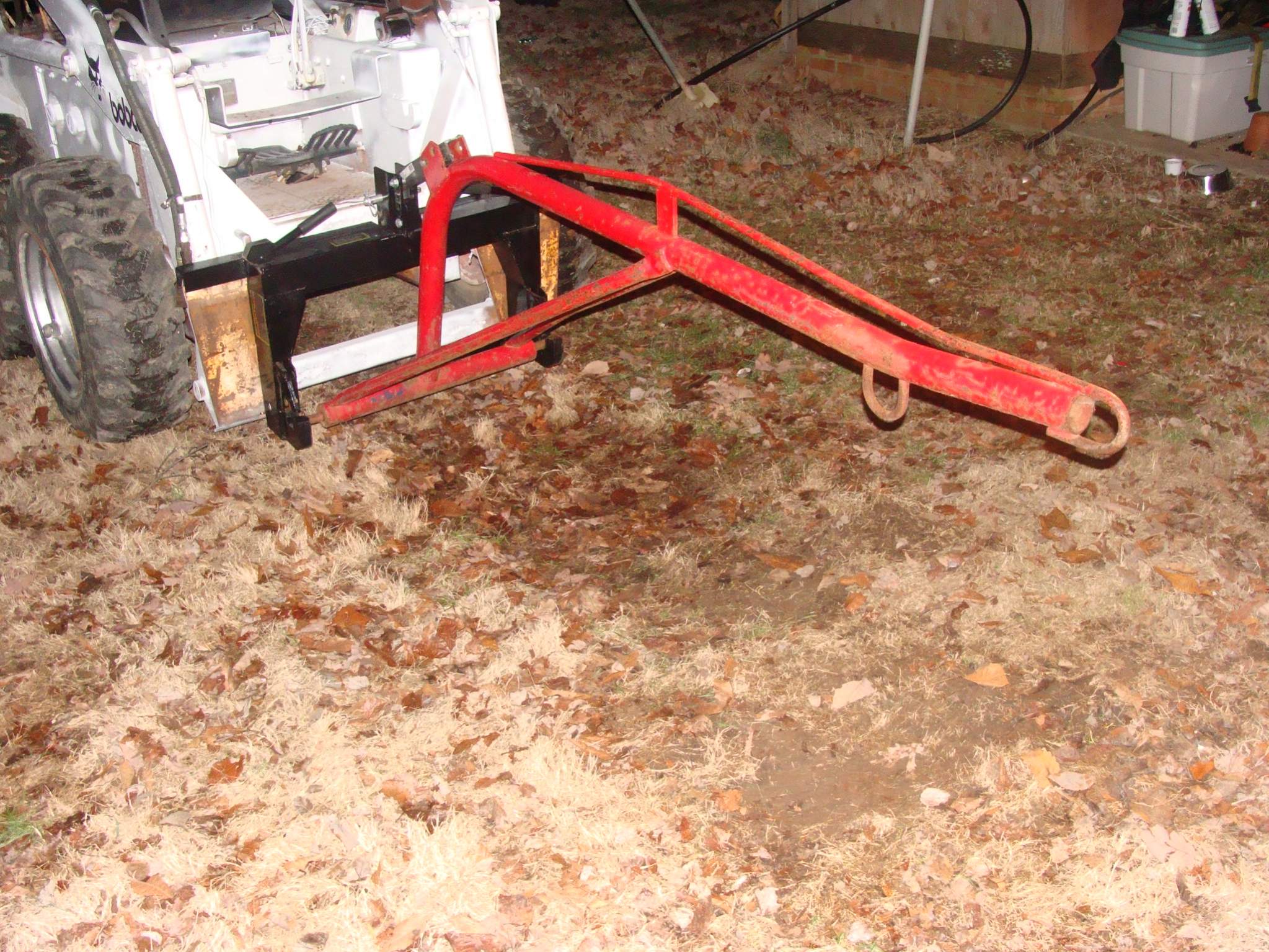

I can't take any credit for building this, I can take credit for abusing it and not painting it, but it works well for me in multiple applications. Right now the adapter is attached to my carry-alls.

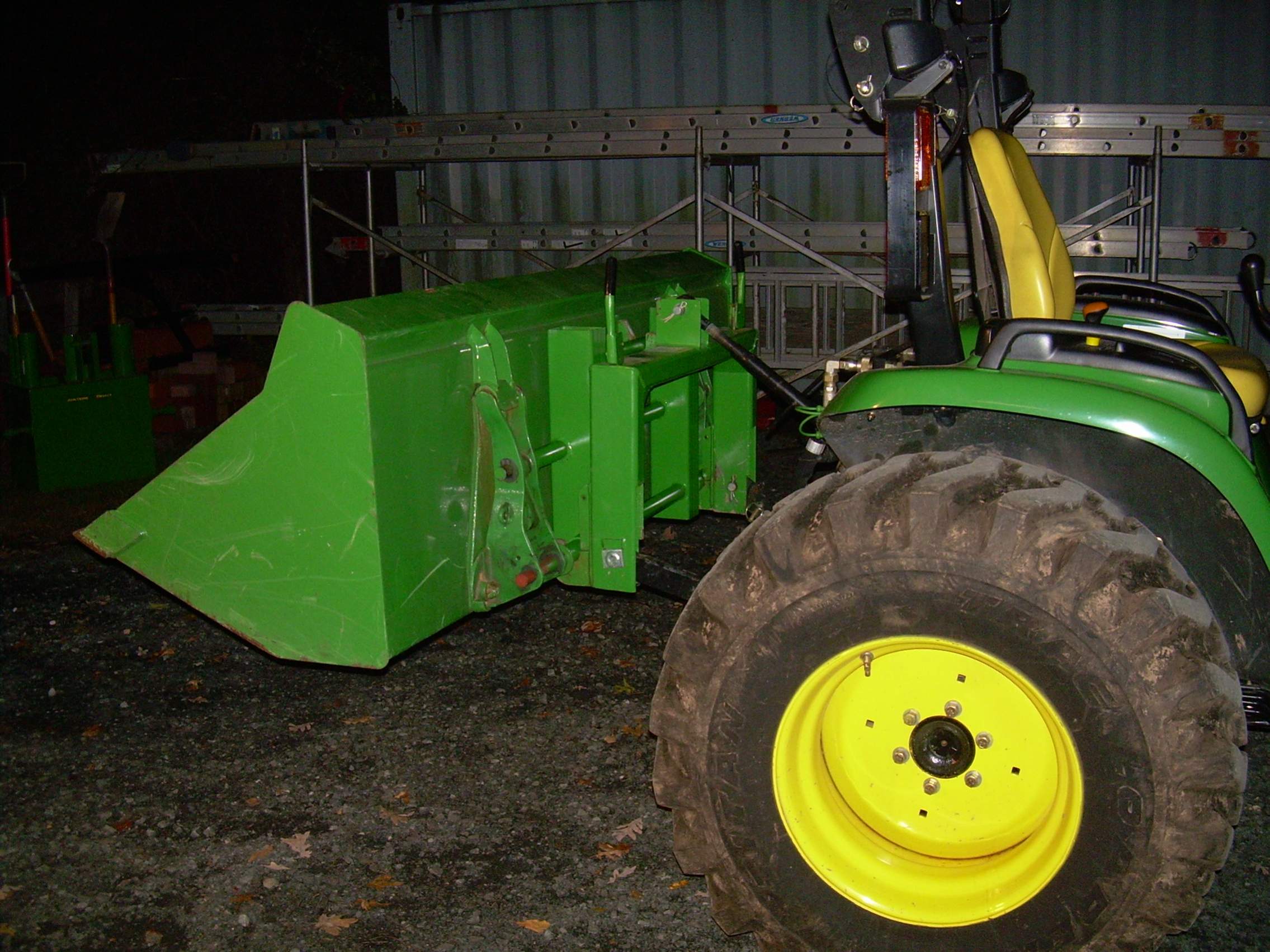

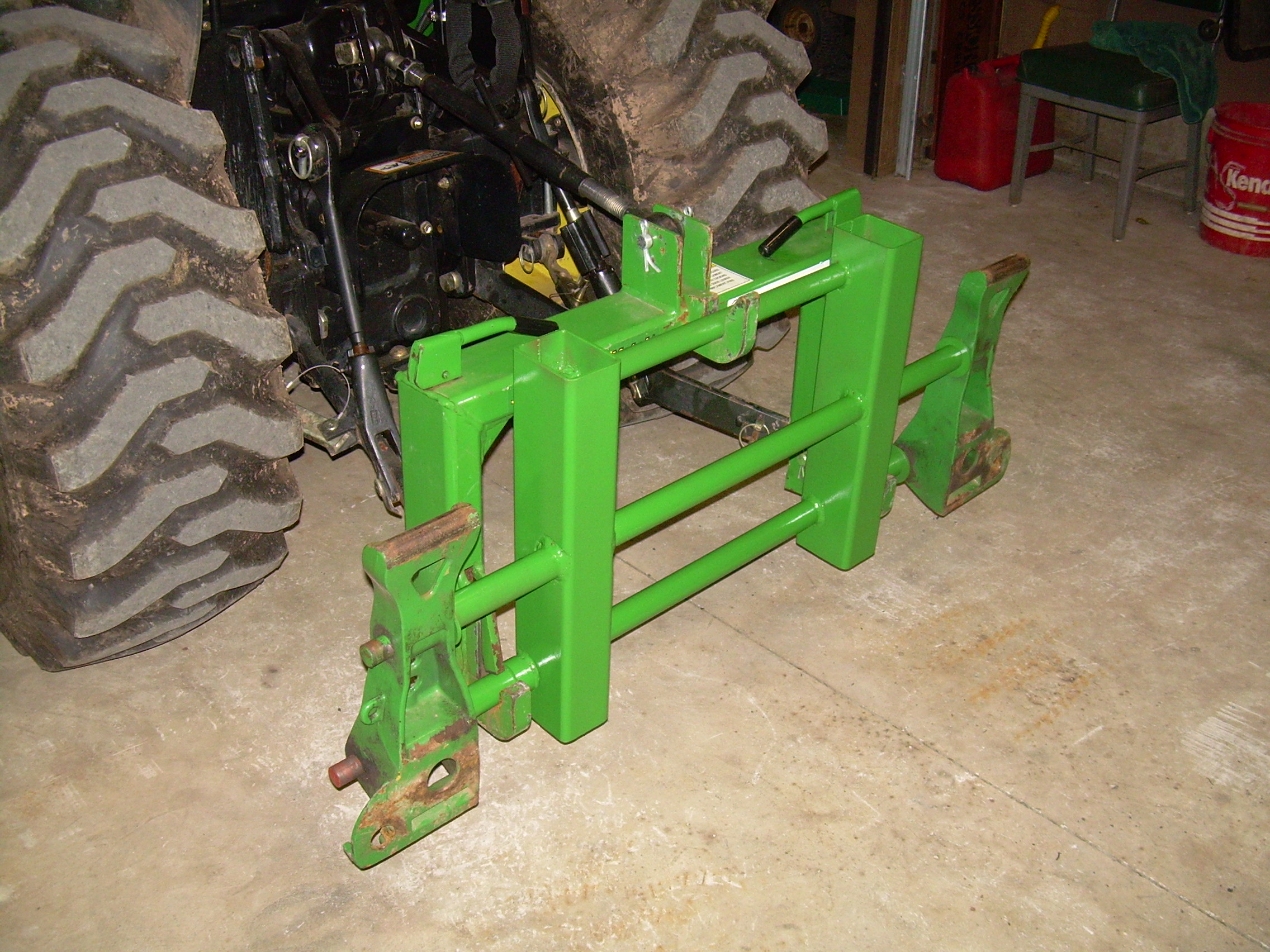

I don't have the skid attachment system but I did make one to work with JD system.
I thought it would come in handy for forks and plow also.

That's the baby, it's just the wrong color and shape! :eek:
Thanks for sharing the pics.
Steve

I made mine kinda just as an experiment as I already modded my forks and snow plow to go directly onto the 3pt QH. I had a spare set of those JD type carriers
Was just thinking of a quick way to do it if you don't need it to quick attach to the 3pt. Just take a cheap harbor freight quick hitch, cut off the J-hooks, now you have a frame that will mount to your 3pt. next get those skid steer implement holders and depending on the spacing you might be able to weld them right on the frame, but likely you would need to do some plate work on the frame first to mount those holders.
You will want a HTL to compliment such an adaptor,
Forks on the rear are far easier to use than on a loader, also higher capacity as long as you don't need to put something up high.
The snow plow is also a serious consideration, I had mine on the 3pt last year and it was great having loader and power angle plow on at the same time. what I found was I was using the plow more than the loader that's why this year I came up with that front frame mounted plow lifted by loader contraption.
The grapple and bucket may not lift high enough to effectively unload even with a dedicated longer travel HTL. but that big bucket on the back does provide some added trunk space if needed.
Like if you were going out to do some heavy clearing with your grapple on the front, you could stow all your other tools in the trunk like saws etc.
