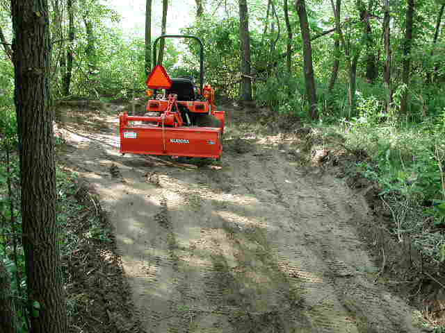

whats the model # on the 52 Kubota tiller? My dealer said it was only 37" for the BX. I assume this is one for a bigger tractor that you use on the BX?
Rogue
/ 3ph Tiller for BX #7
It is a BL52C which is actually 49" cutting width. I got this one because it is wider than the tire width and doesn't leave any tire tracks.
I've used it to bust moderately clay soils with heavy sod/clover and it ate it up with minimal loading of the tractor running at 3/4 throttle. Our garden is very sandy loam soil and the tiller goes down to 10" in this stuff and minces the soil into a very fine texture it spins so fast.
I'll hate to admit it, but I've also used it to chew up 3" ash stumps by slowly lowering the tiller on it which quickly shreaded the stumps with little more than a slight burp.
This is one tough puppy!
Apparantly this tiller was offered for the BX the 1st year than they switched to the smaller 40" model. The 52 is offered for the B7500 & B2410 & 2710 & 2910.
While I haven't heard to many tillers, this one is by far the quietest one of the bunch.
