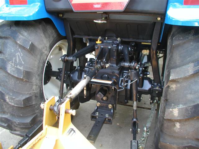

How many categories for 3 ph are there? And what's the difference between them? Is a category 1 the most common?

Thanks for the replies...Bird it looks like Roy & John got the info out the same site. While I'm on the subject, my top link jam nut became stripped, so I replaced it....I suppose it does not matter if the jam nut goes on the implement side or the tractor side of the barrel of the top link?? Maybe I need a jamb nut on both ends?? /forums/images/graemlins/confused.gif
   / 3ph categories ? #7
I can't see that it would make any difference which end the jam nut is on, or whether you had one on both ends, except for the time it would take to tighten two instead of one. Of course mine came with the single jam nut on the implement end and I never had one strip. I never tried to tighten them real tight, but did always use a wrench to get it pretty snug. I found that I could not get it tight enough by hand to keep it from working loose.
   / 3ph categories ? #8
"I suppose it does not matter if the jam nut goes on the implement side or the tractor side of the barrel of the top link?? "
Depending on the type of jam-nut.. (some look like tear-drops) it's possible that it could get caught on the implement side top link hitch when raising or lowering.
