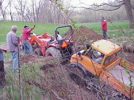

I did wish for a bigger tractor once - I got my Unimog in a predicament and couldn't pull it out with the tractor. But that is hopefully a one time event. See attached.

Yeah, the mog is a big beast. 7500 lbs or so.....
