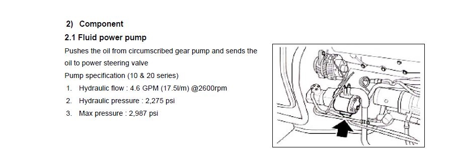

Hi all,
I have a 2007 3820i with a BL20A FEL.
Does anyone know the recommended hydraulic pressure setting.
I think mine is off and new to adjust.
Thanks
/ 3820i Hydraulic pressure setting #2
