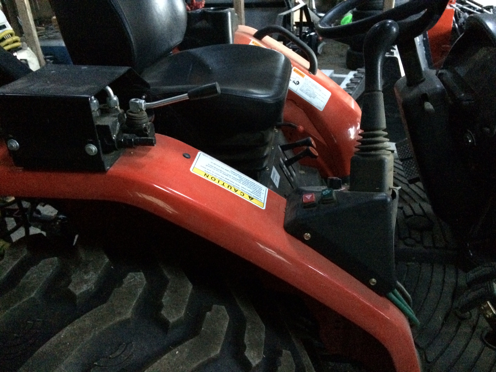

I'm still operating my EA grapple using a 3rd rear SCV which is mounted on the fender. Not as good as a diverter/3rd function but the lever's a lot closer to the joystick than the factory remote levers next to the seat.
What is a SCV? Would you mind posting a pic of your install - lever, fender, etc?
Selective Control Valve. Often called a remote.
Here's a pic of the third SCV on the fender. The valve is one of those that lets you put the handle at different positions.
