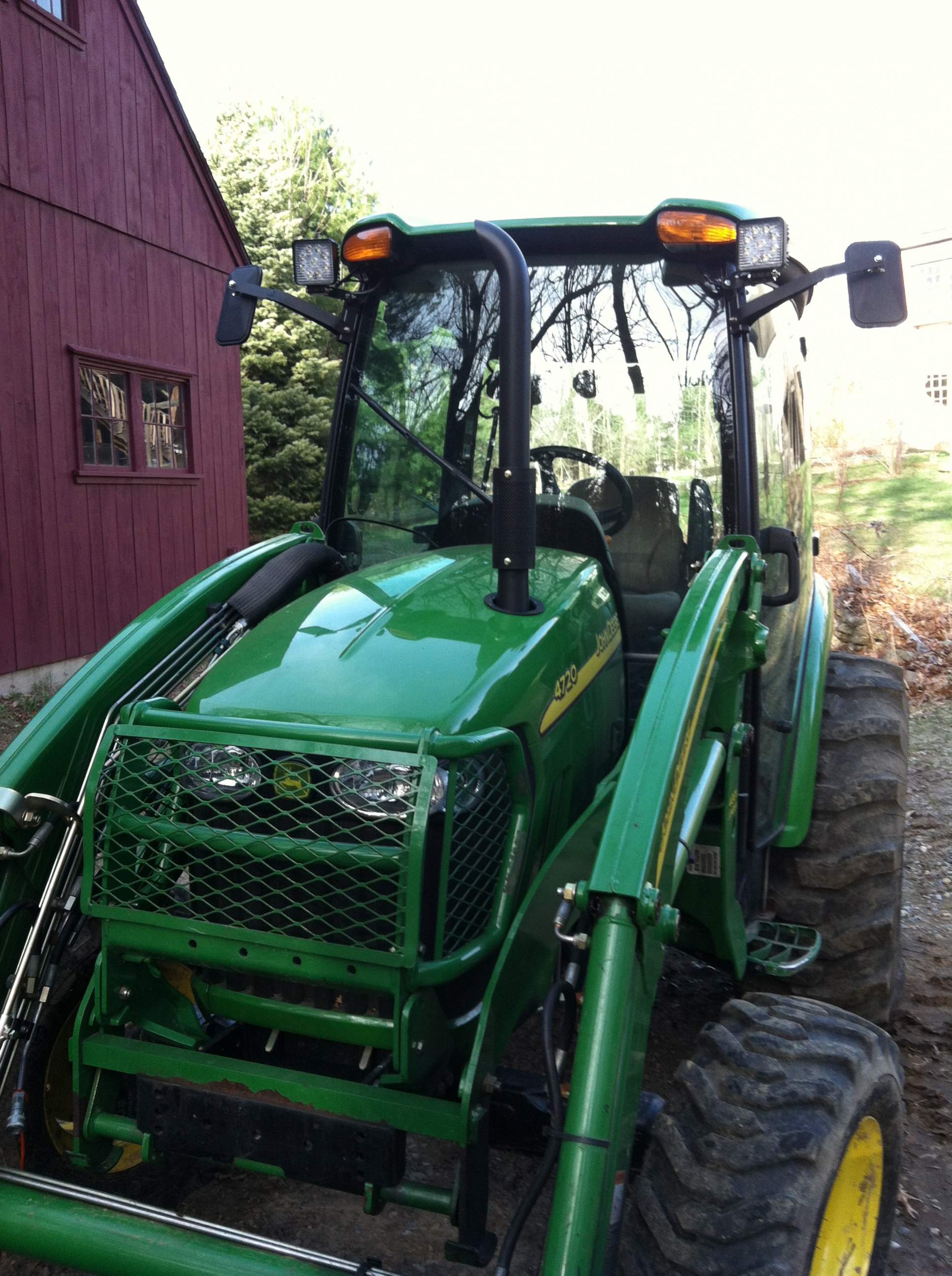

Well finally got around to installing vert. pipe on my 4720. Toughest part was drilling the cut out. After trying to position hole saw over cut out marks and having it skip round I located center point with a compass and then drilled a small divot in center. Instruction sheet says by the way.."drill 3.6" hole"! Not too many 3.6" hole saws out there. The rubber hood gasket wouldthen not fit (3.5" saw!), so I used a Roto-Zip to enlarge just a bit.
Actual installation of the pipe takes about 5 min. So now that I have a little "line of defense" for
branches when I'm in the woods, I'll probably back into one and nail the back glass!

Looks pretty good on your 4720. Had similar experience with drilling the hole on my 3720 hood.

Well gee that seems to a bit high for the 3x20 series, but hey it does look good and it works.

I have ordered a 4105 with a loader, and on my current tractor (JD790 with a 419 loader) I have a vertical exhaust. I am thinking that I want to keep with the vertical exhaust, but I am curious if it is high enough in an open cab environment to keep the exhaust out of my face. Do you know the height of the exhaust?
Thank you and nice tractor you have.
Joshua
If your referring to my tractor, thank you.
I just measured 27 inches from the good to the top of the exhaust pipe tip
/ 3720 Vertical Exhaust?? #51
Yes nice tractor to BigMike50, and thank you for providing me with the length of exhaust pipe.
