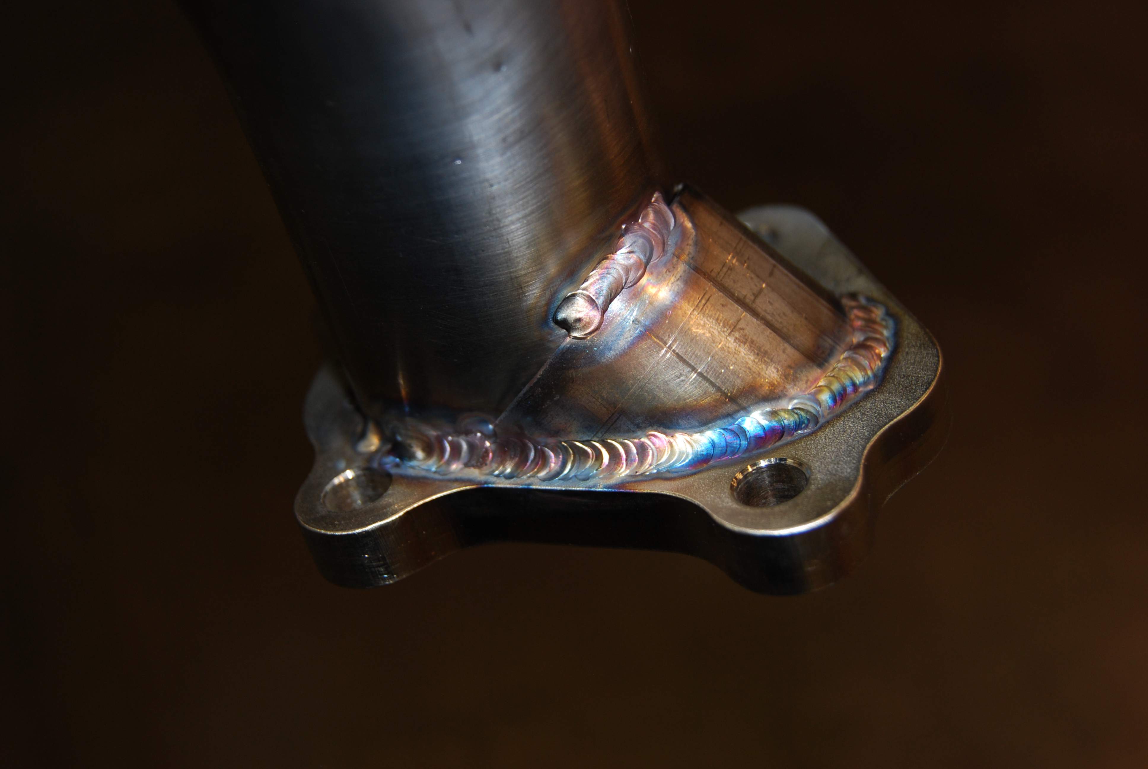

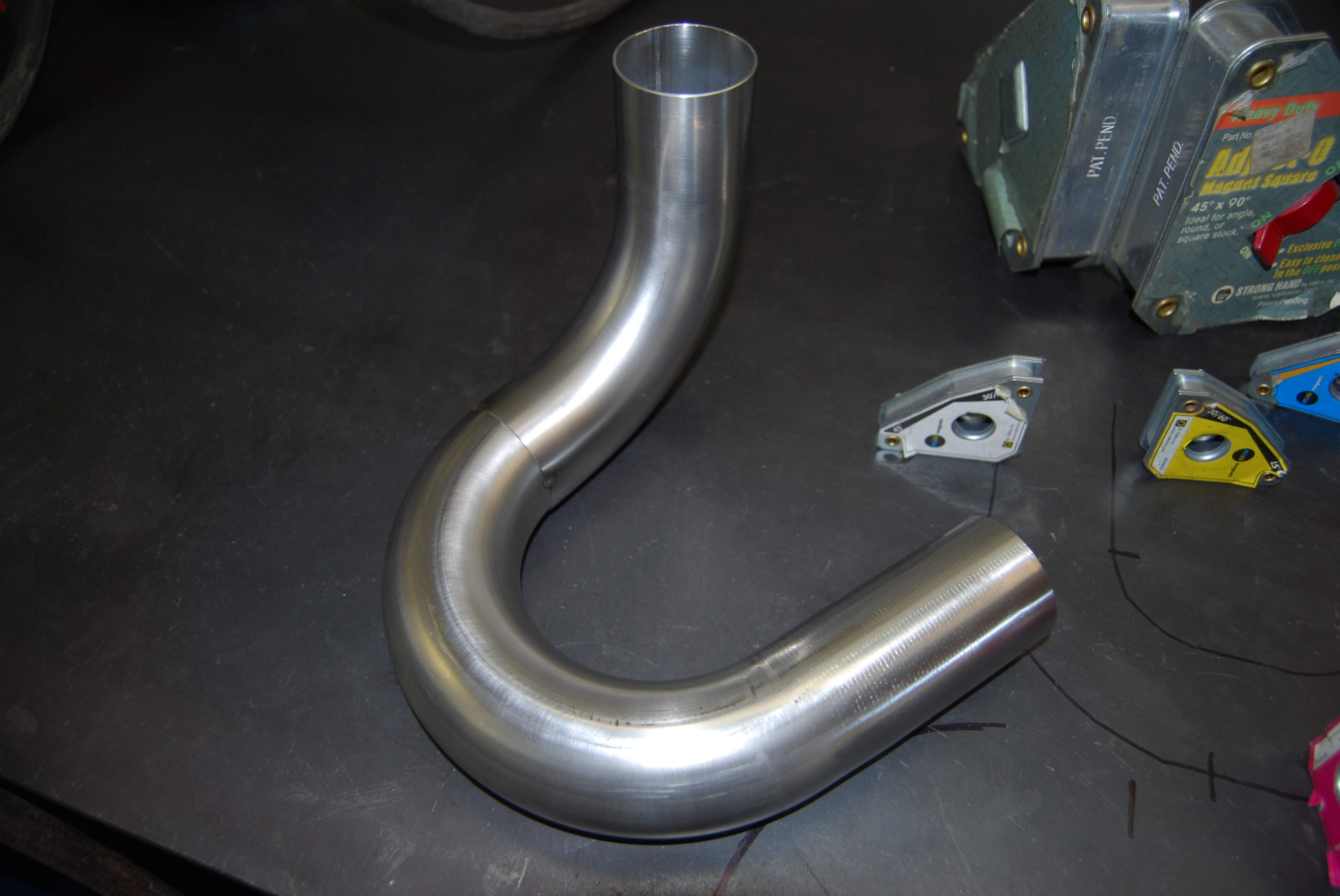

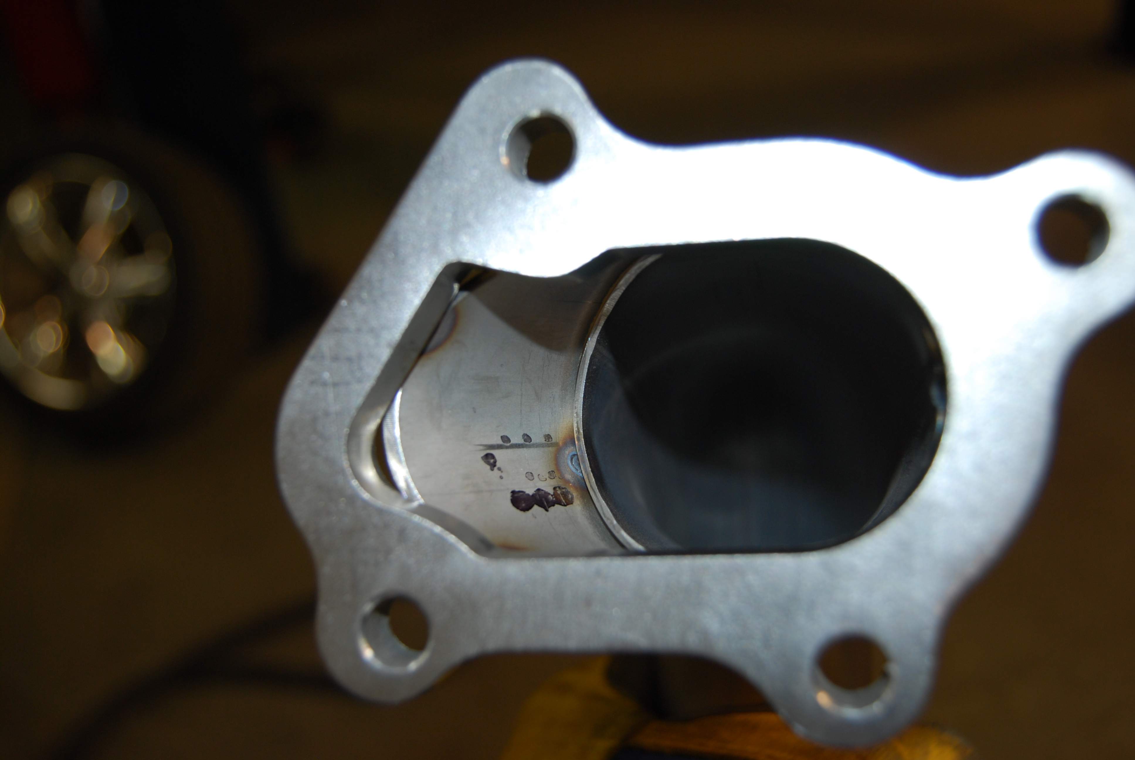

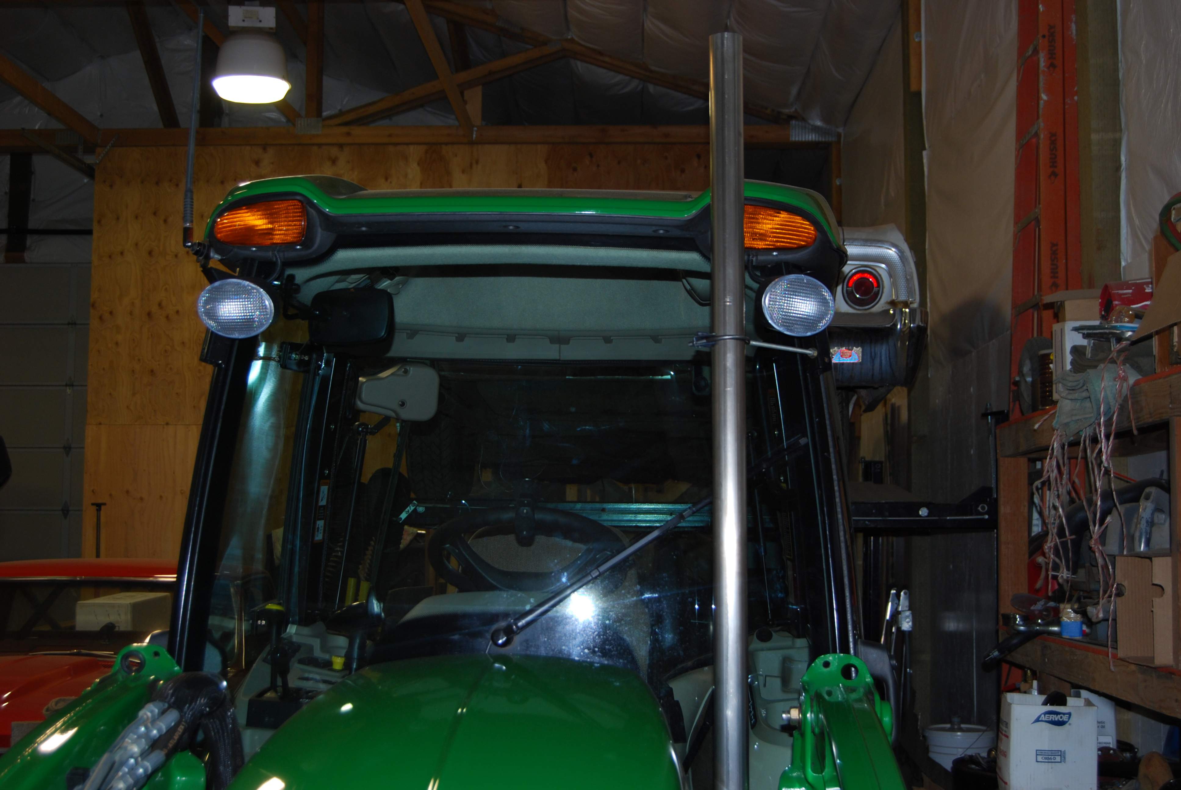

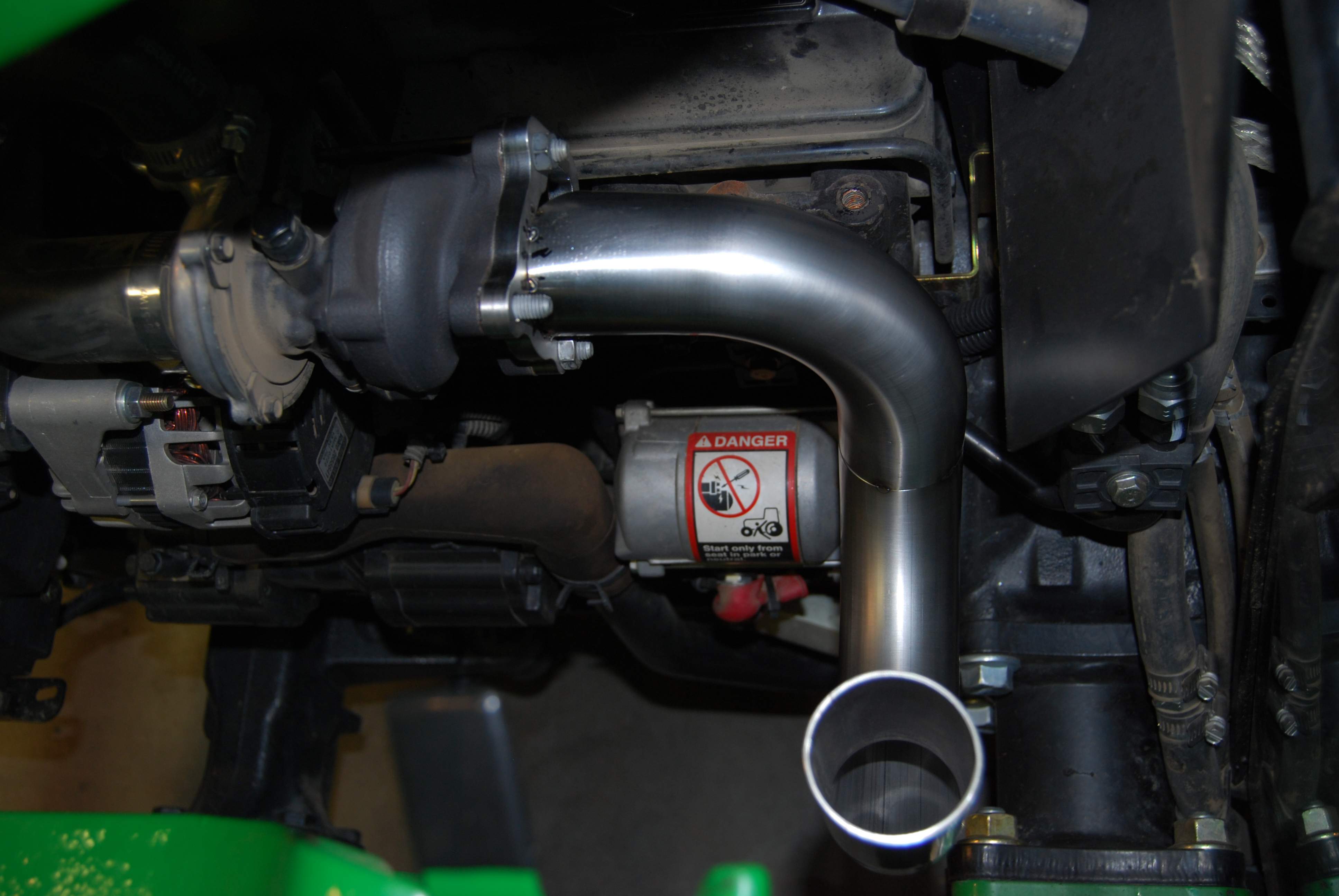

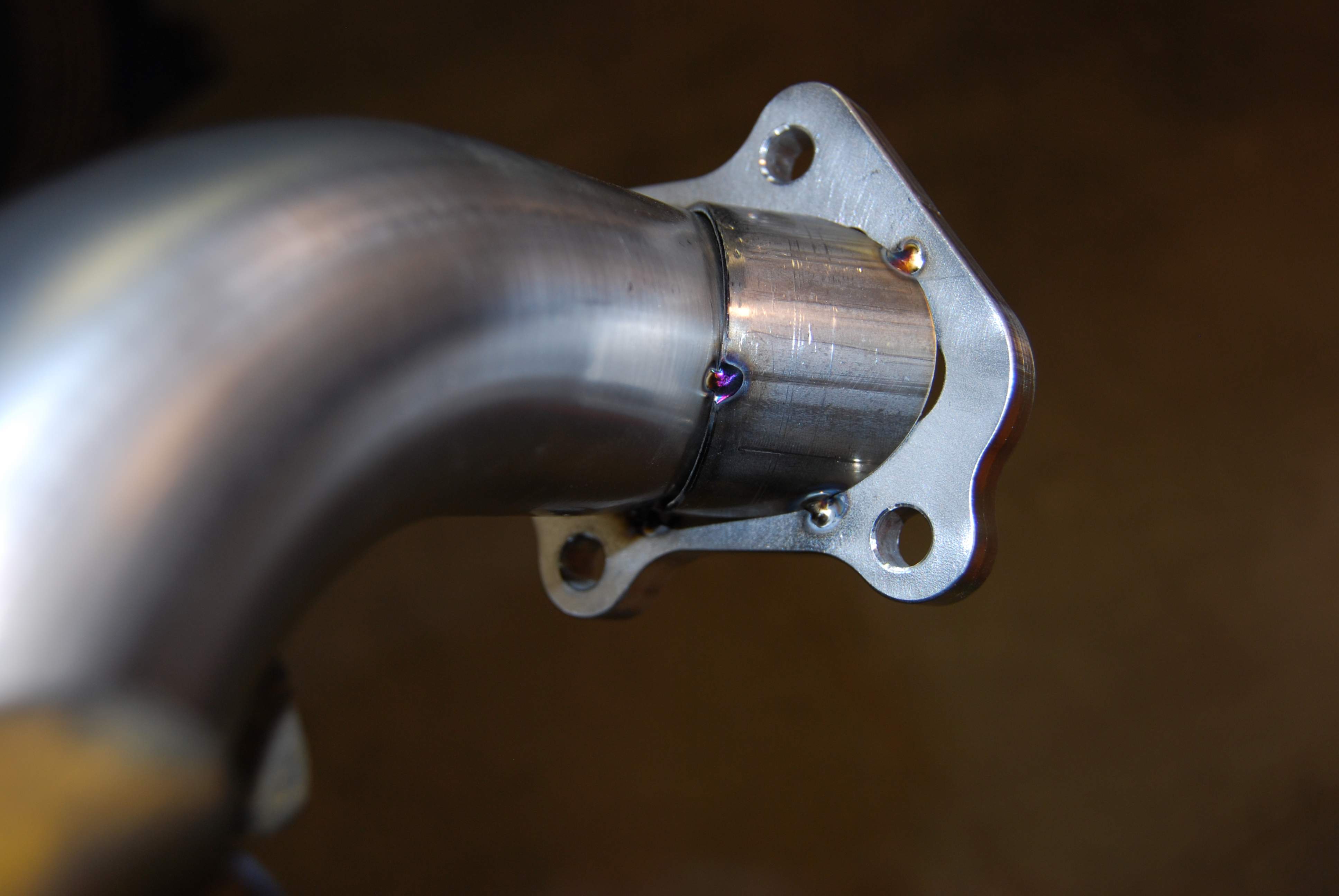

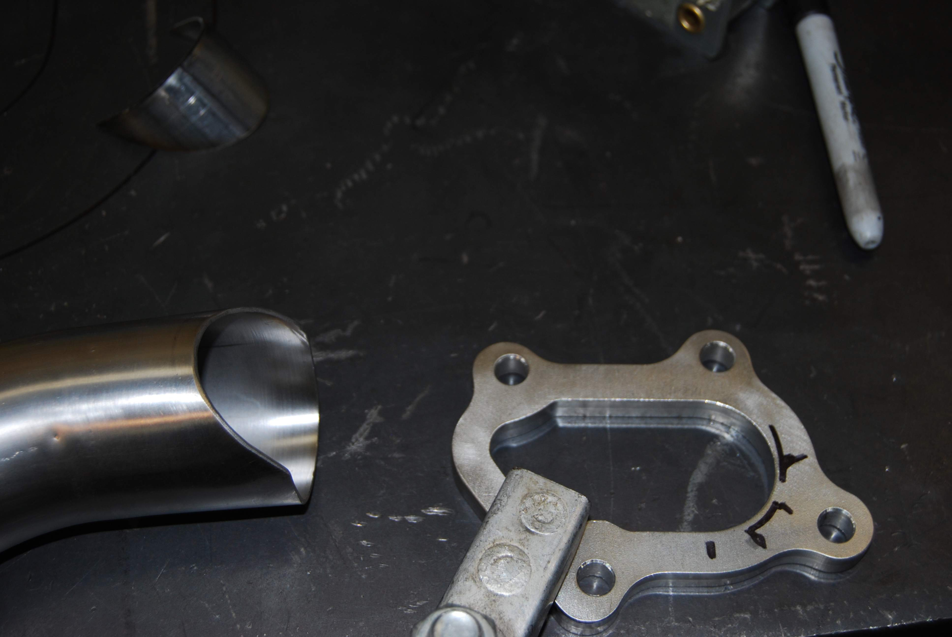

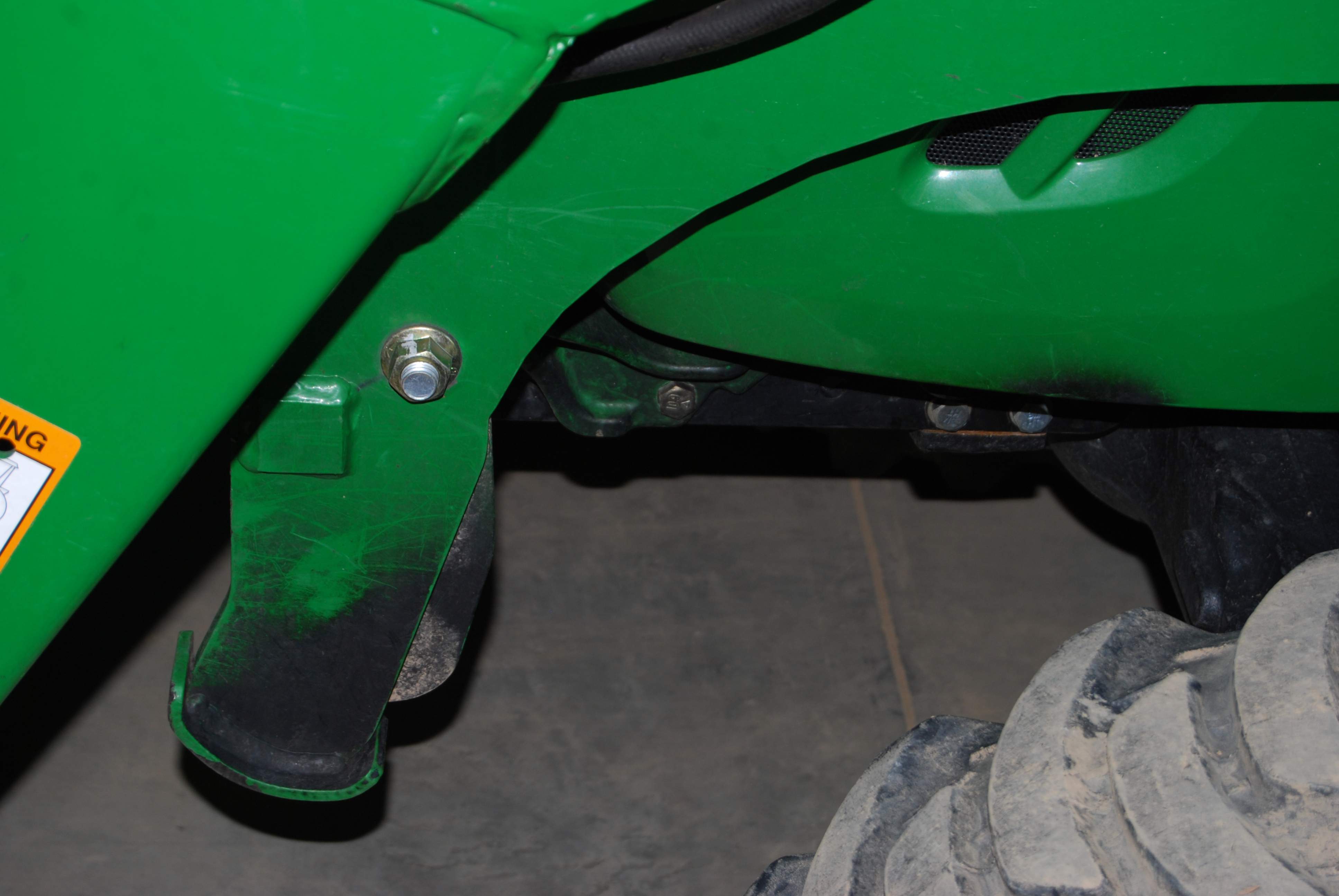

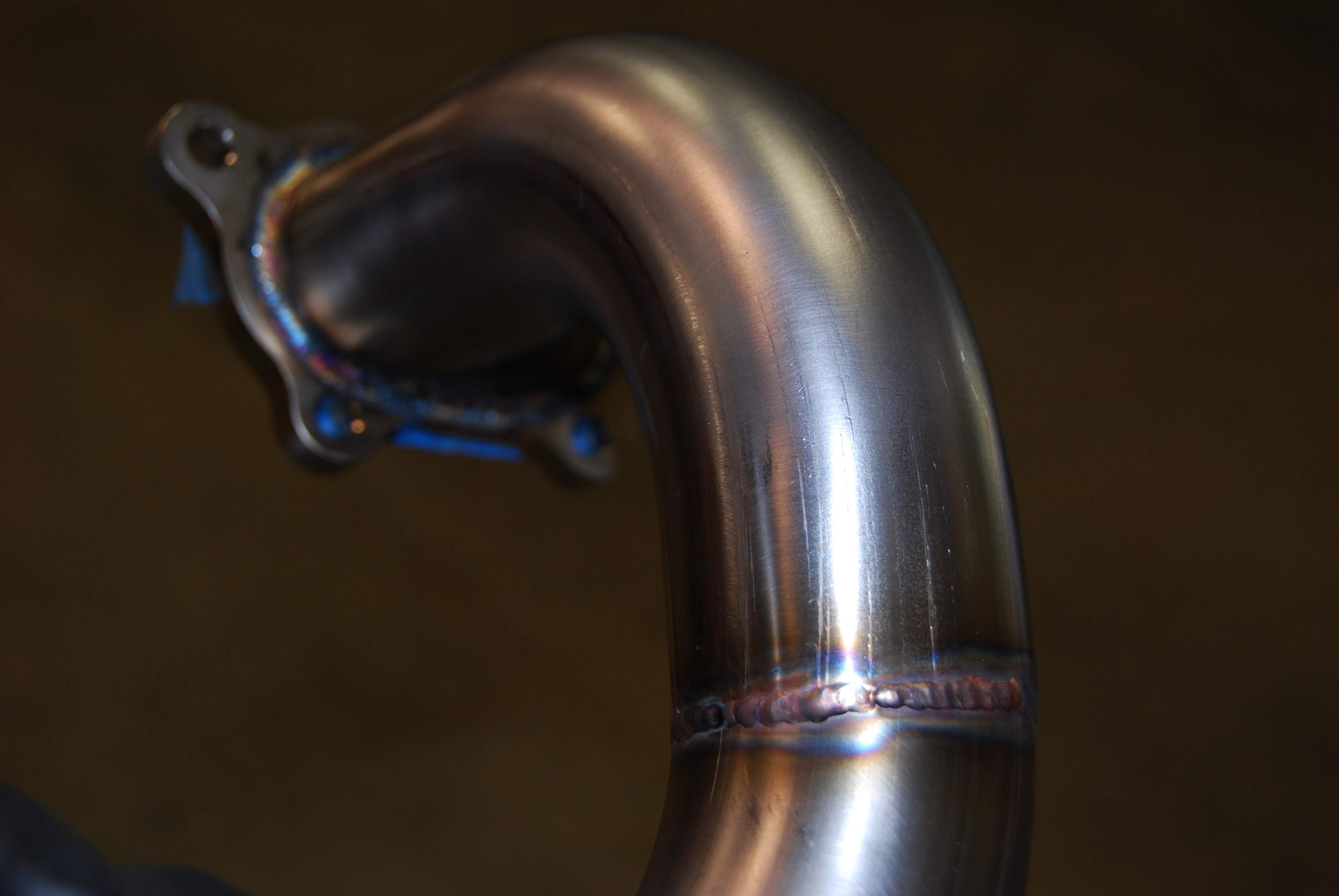

So, what brought all of this on was the fact I was tired of sucking exhaust every time I got out to put something in the bucket or switching between bucket, root grapple and pallet forks. I am also tired of soot building up on the lower part of the hood and front loader. I have some fabrication skills and equipment, so I decided to build a vertical exhaust. The other reason I built one instead of buying from John Deere is that I didn't want to cut a hole in my hood. This way it doesn't block my view at all and I can return it to stock if I ever want to for some reason. I had a flange laser cut from 304 Stainless to match the shape of the original pipe adapter on the turbo. The hole through the original flange is only 1.5", I had the flange made so I can run a full 2" pipe all the way out. John Deere Vert Exh 011.jpg

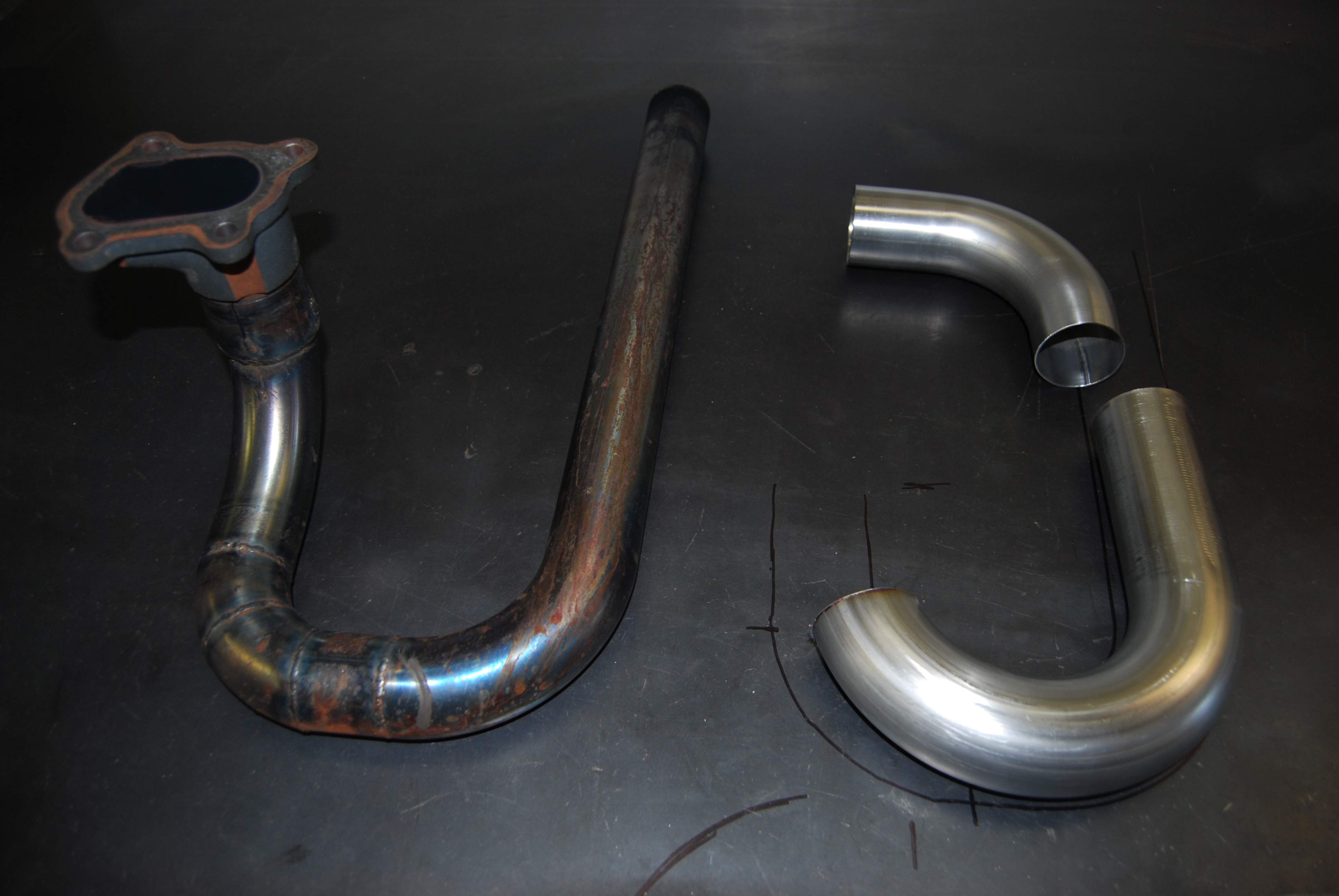

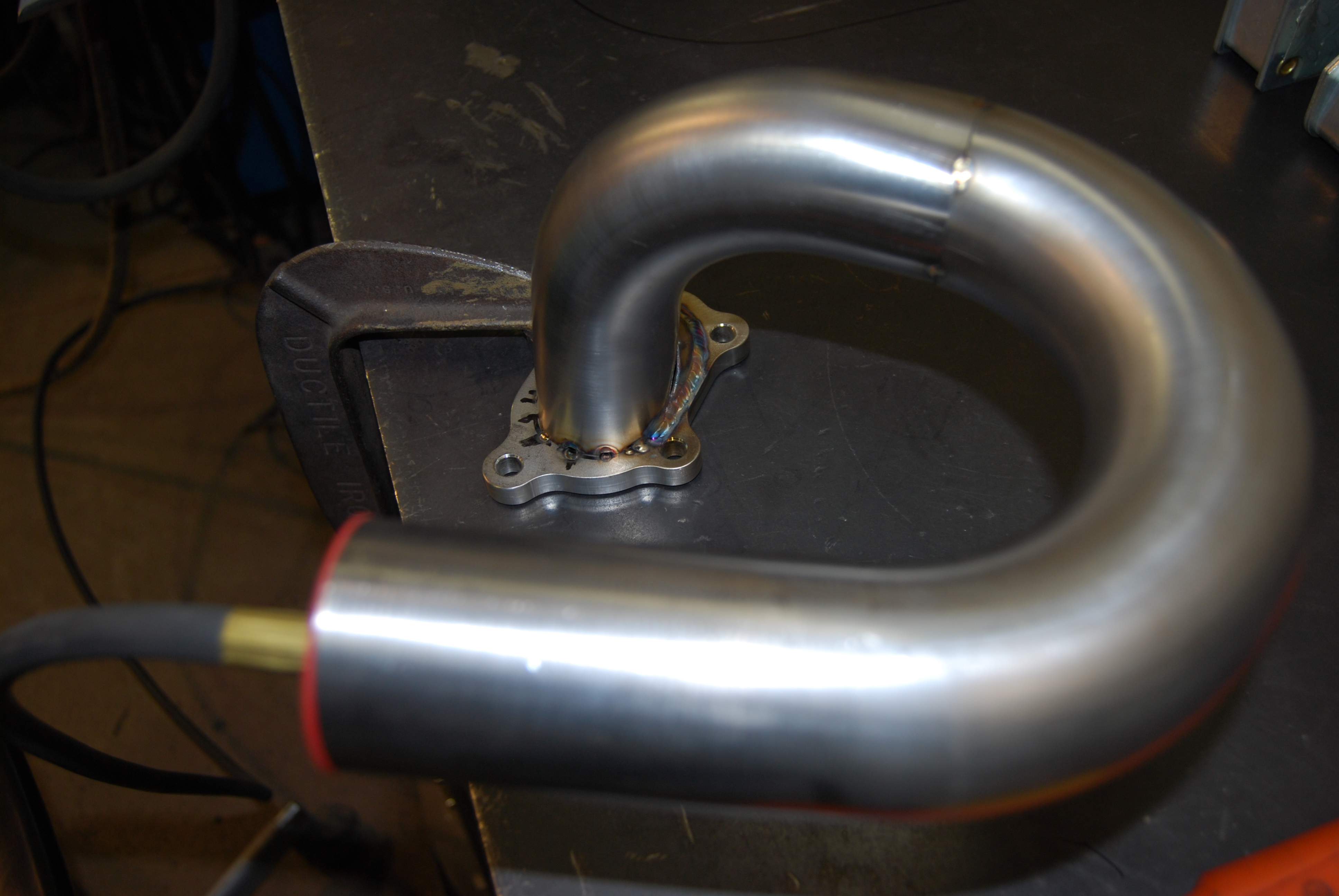

Before I had the stainless flange made a built a test pipe out of scrap steel tubing left over from a header build to see if it was in my line of site too much and to get an idea of fit and sound without spending any money. In the last pic you can see the test pipe and the beginning of the stainless system.John Deere Vert Exh 023.jpg

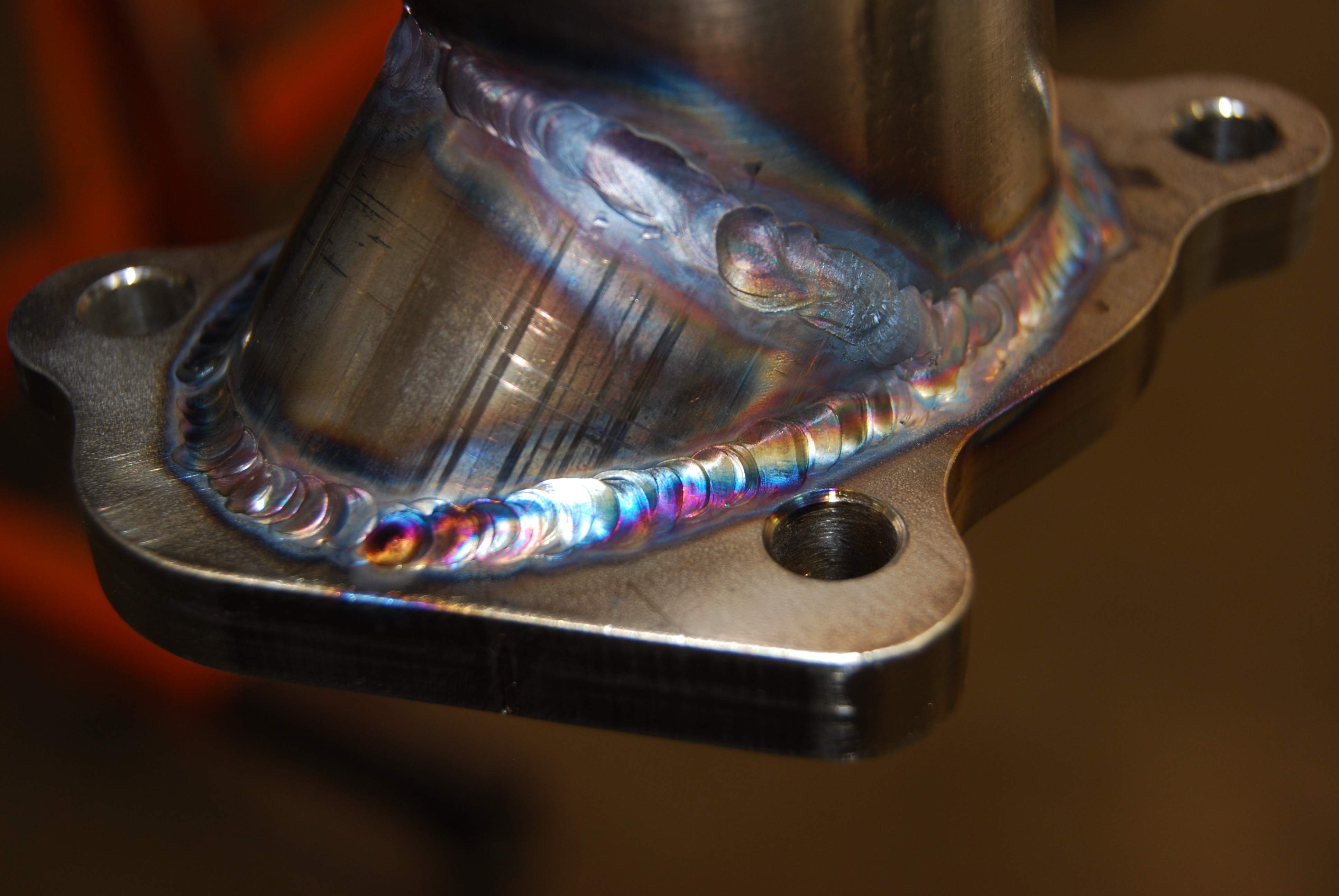

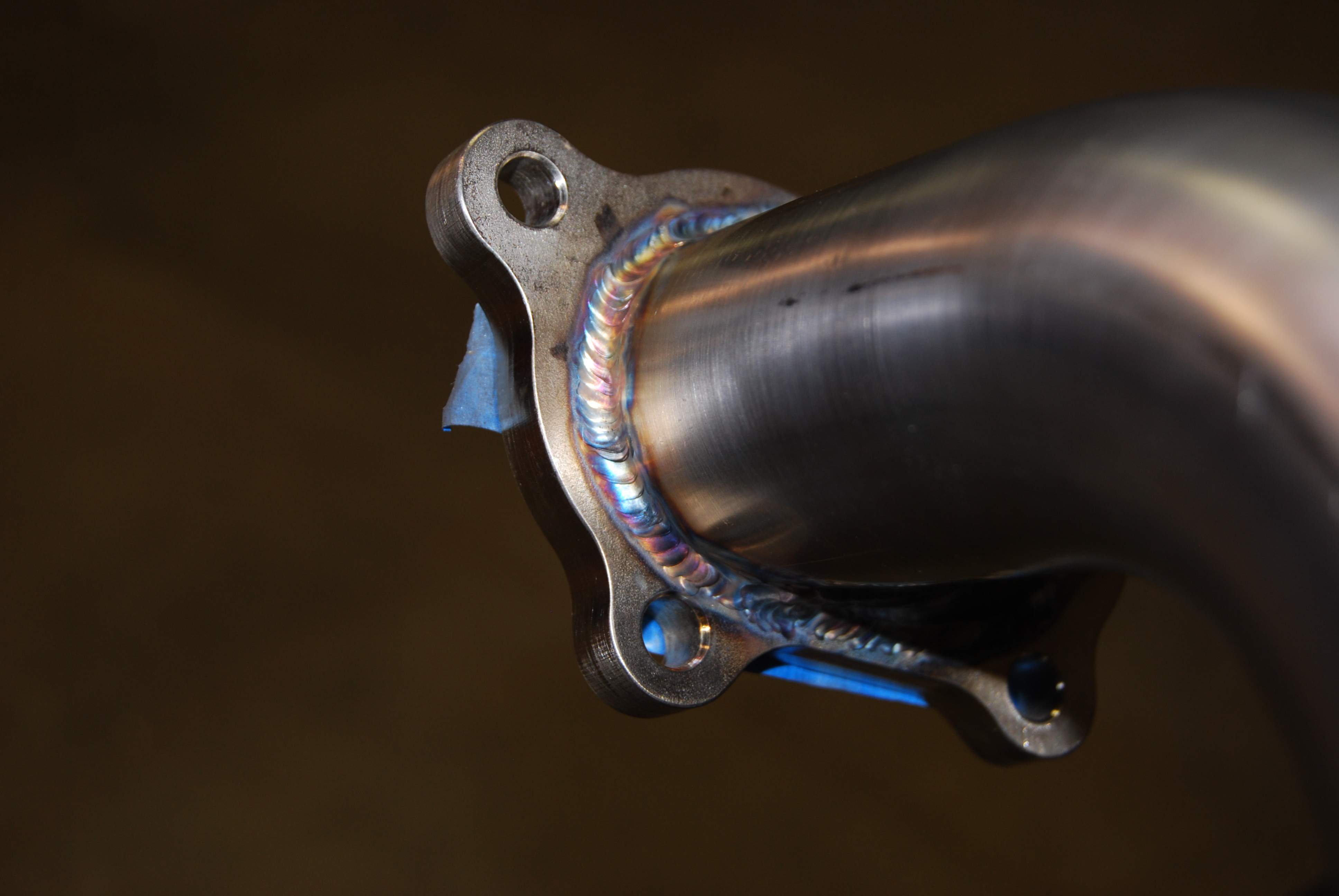

As I went I welded and filled the gap in the flange with a scrap of tubing, I fish mouth cut the end of the pipe at the flange so I could get full flow from the turbo and the pipe is slightly oval shaped at the flange.

I must have not inserted the photos completely, I'll add some more here.John Deere Vert Exh 003.jpgJohn Deere Vert Exh 003.jpgJohn Deere Vert Exh 006.jpg
/ 3720 Stainless Vertical Exhaust
John Deere Vert Exh 014.jpgJohn Deere Vert Exh 018.jpgJohn Deere Vert Exh 019.jpgJohn Deere Vert Exh 020.jpgJohn Deere Vert Exh 021.jpgJohn Deere Vert Exh 023.jpgJohn Deere Vert Exh 024.jpgJohn Deere Vert Exh 028.jpgJohn Deere Vert Exh 030.jpgJohn Deere Vert Exh 031.jpg

No problem, sorry for the trouble with pics, still new with uploading. I use my own projects like this for practice for the jobs I do for clients in my business, some of my friends think I am crazy when it comes to this stuff but the more I do something the better I get at it. This is some of the first stainless tube welding I have done, I did a lot of aluminum last summer and I know that helped.

Any chance you can post pics of the completed job and how you support the pipe. I want to try the same with my Kubota but can't decide how to go about it. I need ideas.:D
