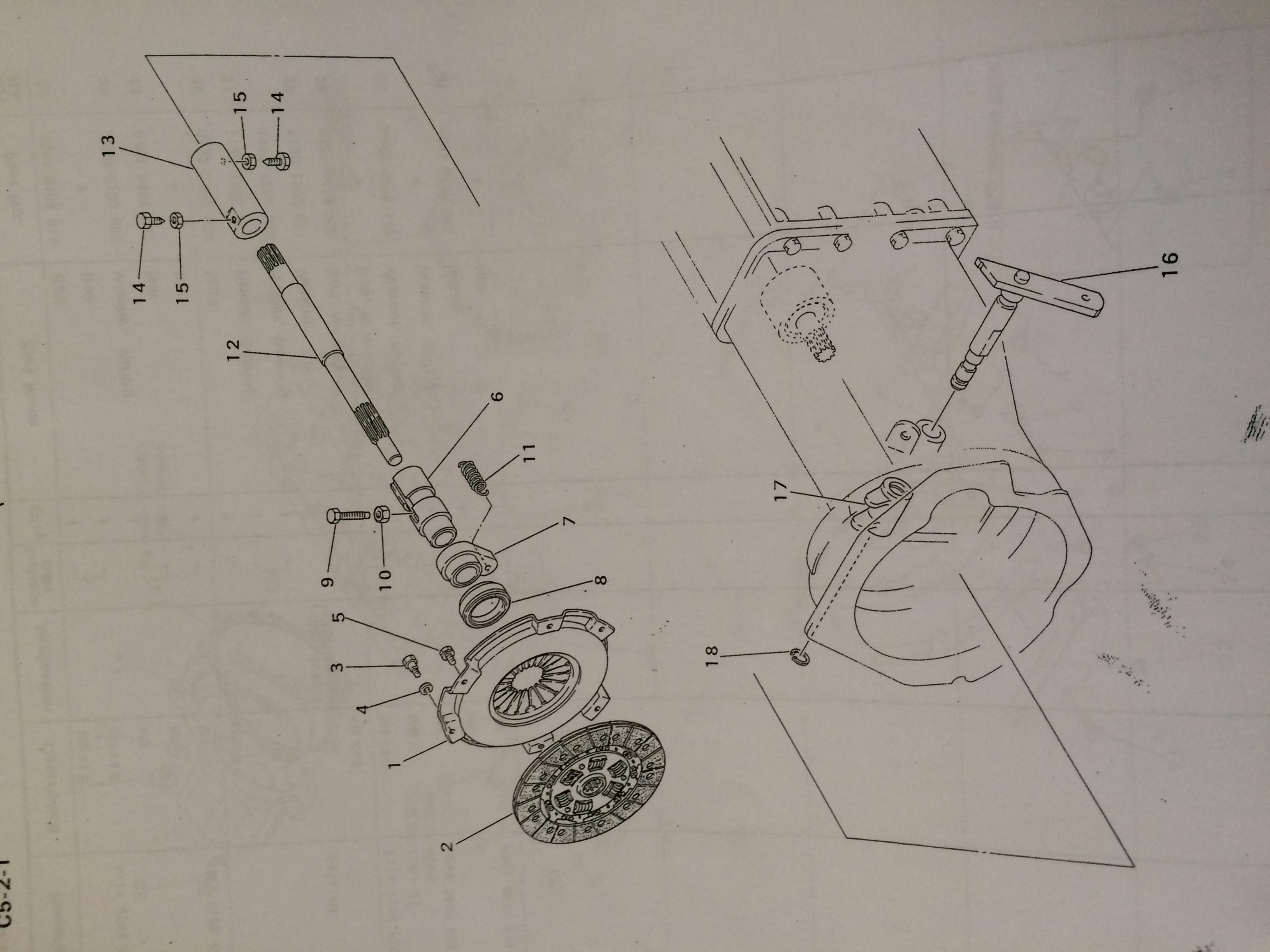

All new clutch pack with bearings/ bushings. Tractor back together, press clutch pedal,shifts into gear, tractor will not move, readjust clutch linkage, tractor wants to move but won't . Can not find adjustment on linkage to correct this. Fluids are good, hydraulics work well. I'm stumped???

Tractor can be pushed in neutral, locked when tranny in gear...like it should......wtf. Pressure plate wrong way.....looks like it can only go one way. Spline hub faces away from flywheel

Any chance folks that I have put the clutch boss in backwards? Tractor pressure plate is forced half on/off. Clutch can't stroke to release and holds the fingers slightly when reassembled. Opinions,comments suggestions welcomed.thanks

IMG_0772[1].jpg See if this diagram helps. ----------------------- John :drink:

It does to a degree, not exactly my tractors internals but basically the same. Of course most of them would be. Comes down to me putting the tob bearing boss in backwards and/or torquing the lock down bolt to tight to the shaft and not allowing it to travel on the drive shaft. Your thoughts?

What exactly does the bolt on the boss do? There is no milled tract for it to travel in. Anyone have a photo of what the boss looks like on the satoh s370 beaver. That alone might be helpful. Thx
