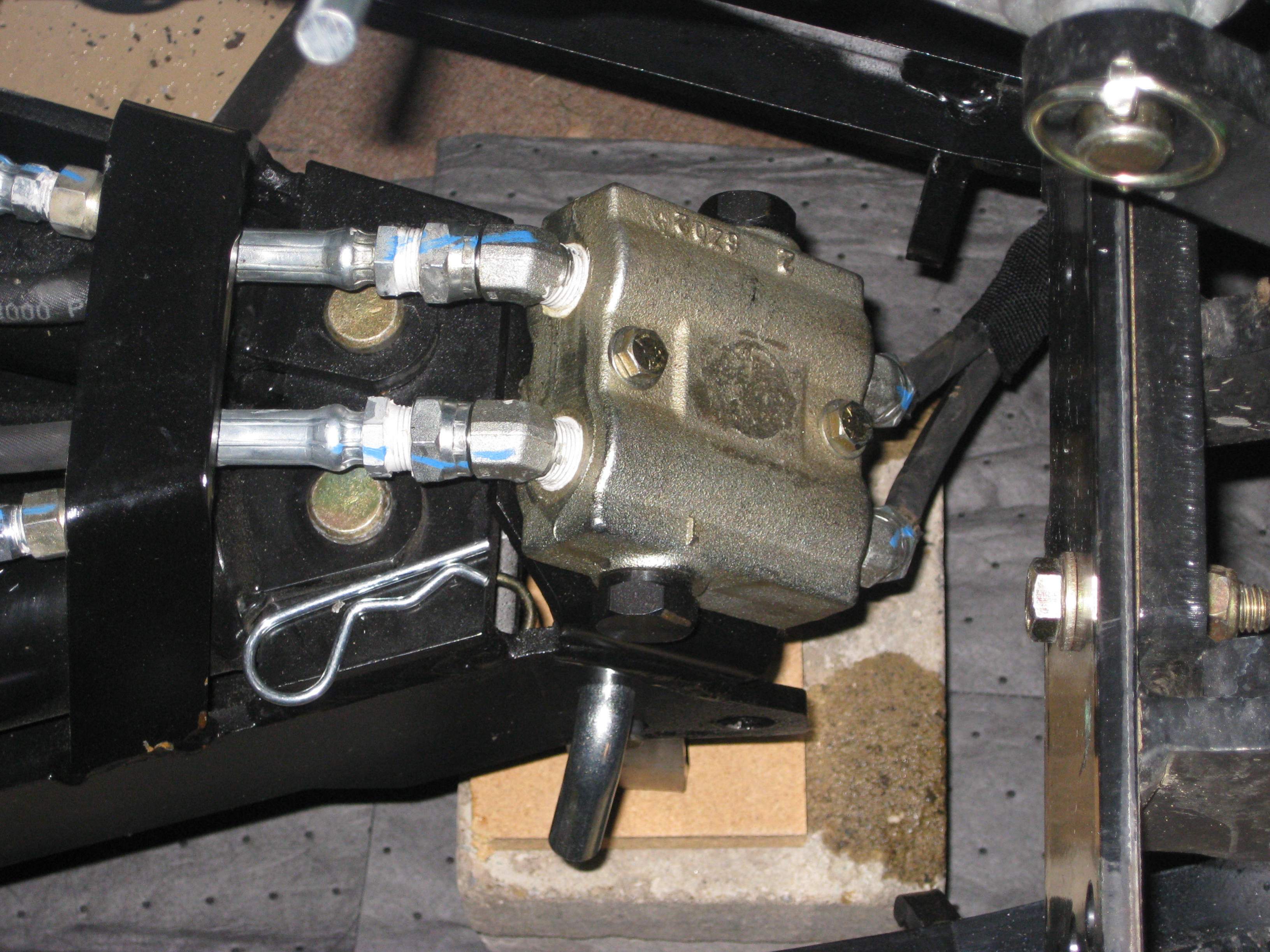

Hoses to the angle cylinders run down the right side of the frame over the axle to the quick disconnects at the right side of the cab. They are not retained via any hose loops and I used some tie straps to keep them away from moving parts. The loft cylinder hoses are positively secured to the frame or engine block as i recall.

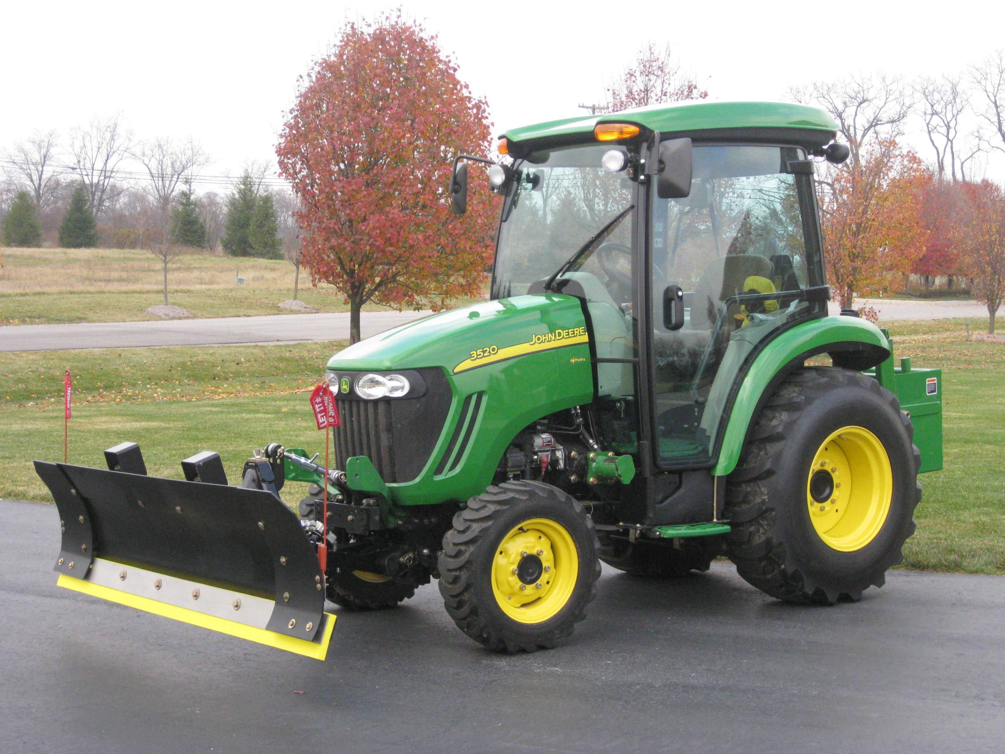

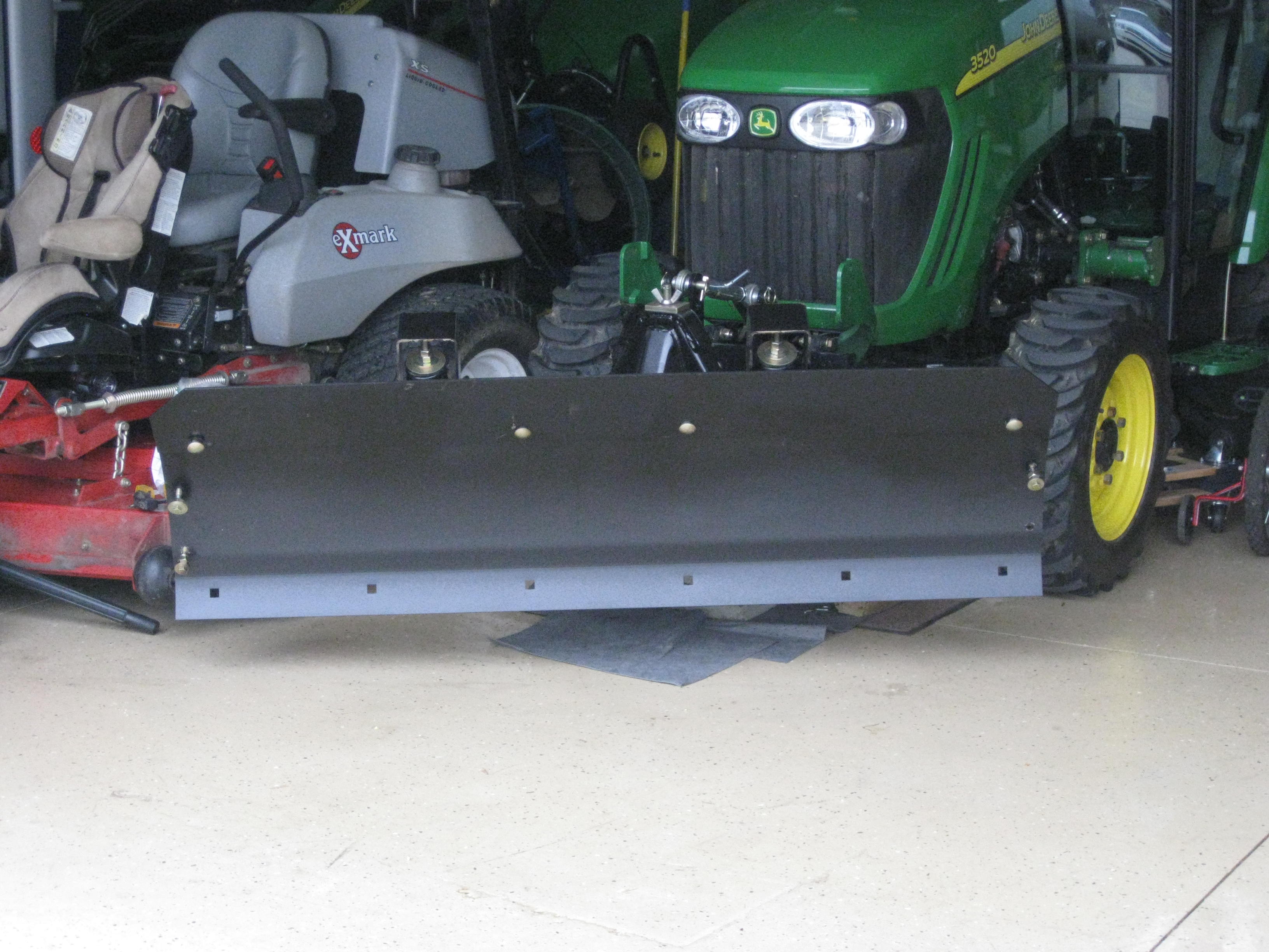

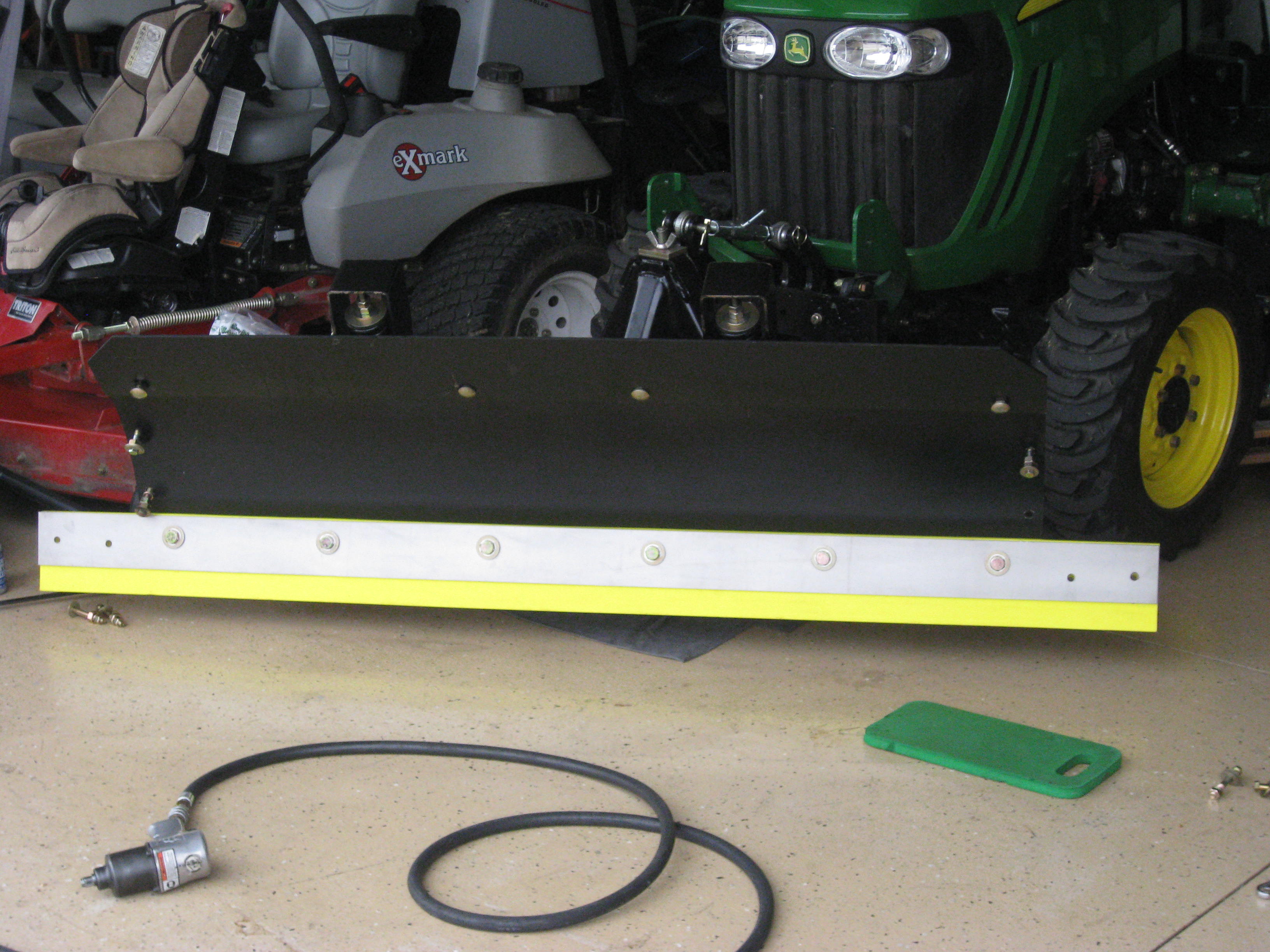

Hi Acolar, was wondering how you like your poly edge blade? Does it scrape clean?
I just ordered one from Fall Line for my new 366 blade. There doesn't seem to be a good
way of storing the hyd. hoses when the front quick hitch is not being used.

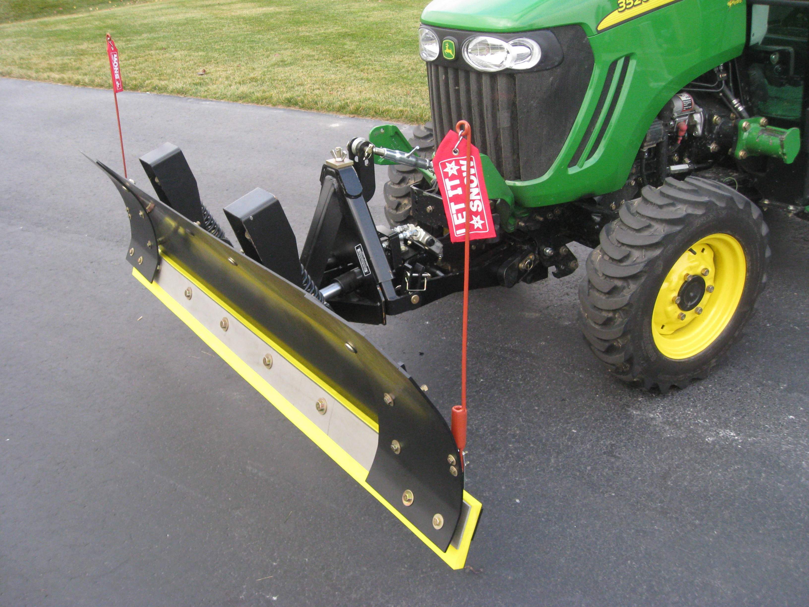

I like the poly. We have black top driveways in the sub and the poly appears to be much gentler on the surface than the steel edge would have been. If cars do not drive on the snow prior to plowing it cleans well. Not sure about the hoses - they are attached to the plow so when it gets removed the hoses go with it...
As an added benefit the Poly is almost JD Yellow.

I tried a rubber edge on my back blade, but with no down pressure, it doesn't scrape

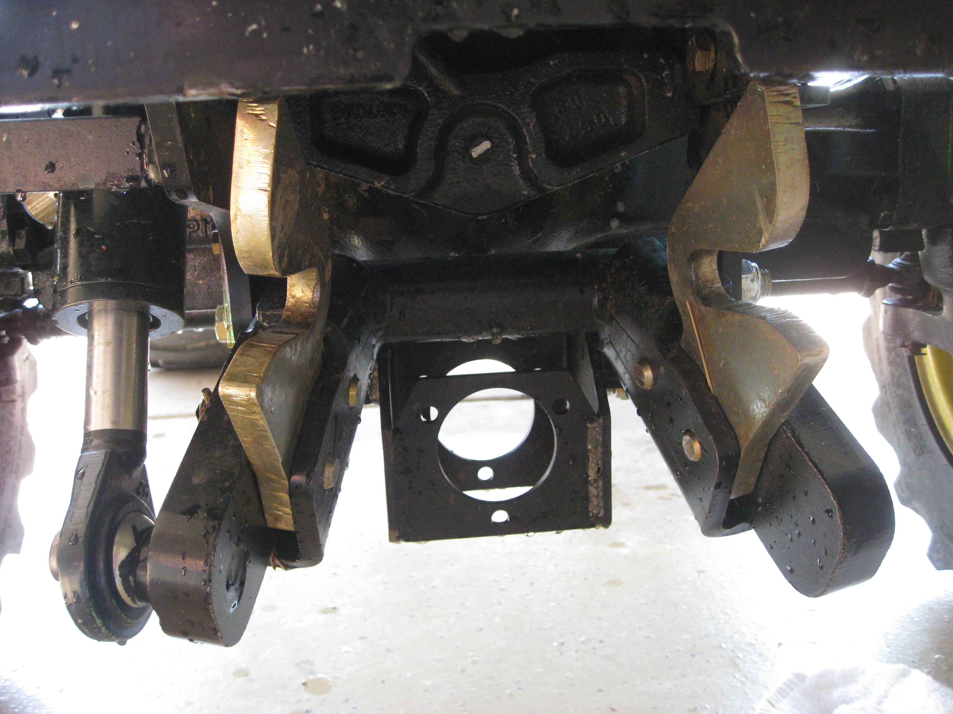

very well. I'm hoping this works better. When you take the plow off for the summer, two hoses come off with the plow, but the other two hoses will stay on the tractor with the cylinder and the rest of the front quick hitch.
