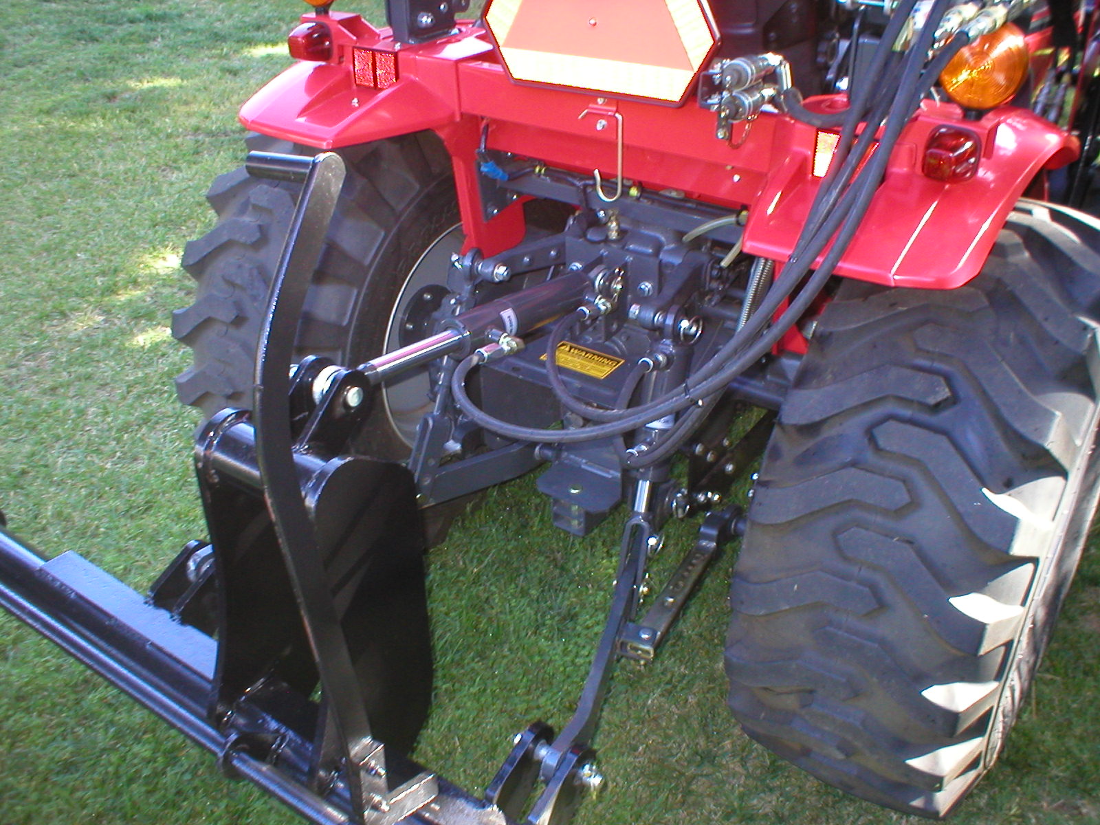

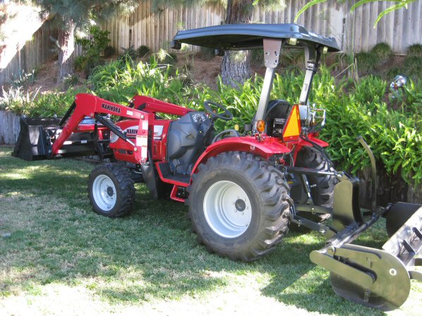

Bob Cats are very nice tractors. you would be happy with either one. The rear remotes are used commonly for Top and Tilt hydraulics for the 3 point hitch. BC has 2 available as an option, The Mahindra only has 1 and is one of their weak spots if you were to ask me.
Maybe you should start a thread over in the BC forum so that you can get some more info on the BCs. Here is a pic of my Mahindra 3215HST with top & Tilt hydraulics for the 3pt hitch. If you are going to do any grading with about any implement, "TnT" is the only way to go.
