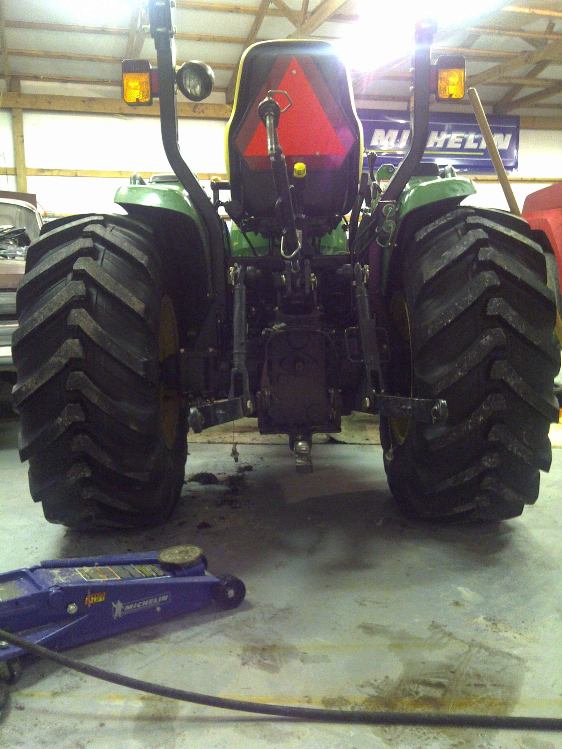

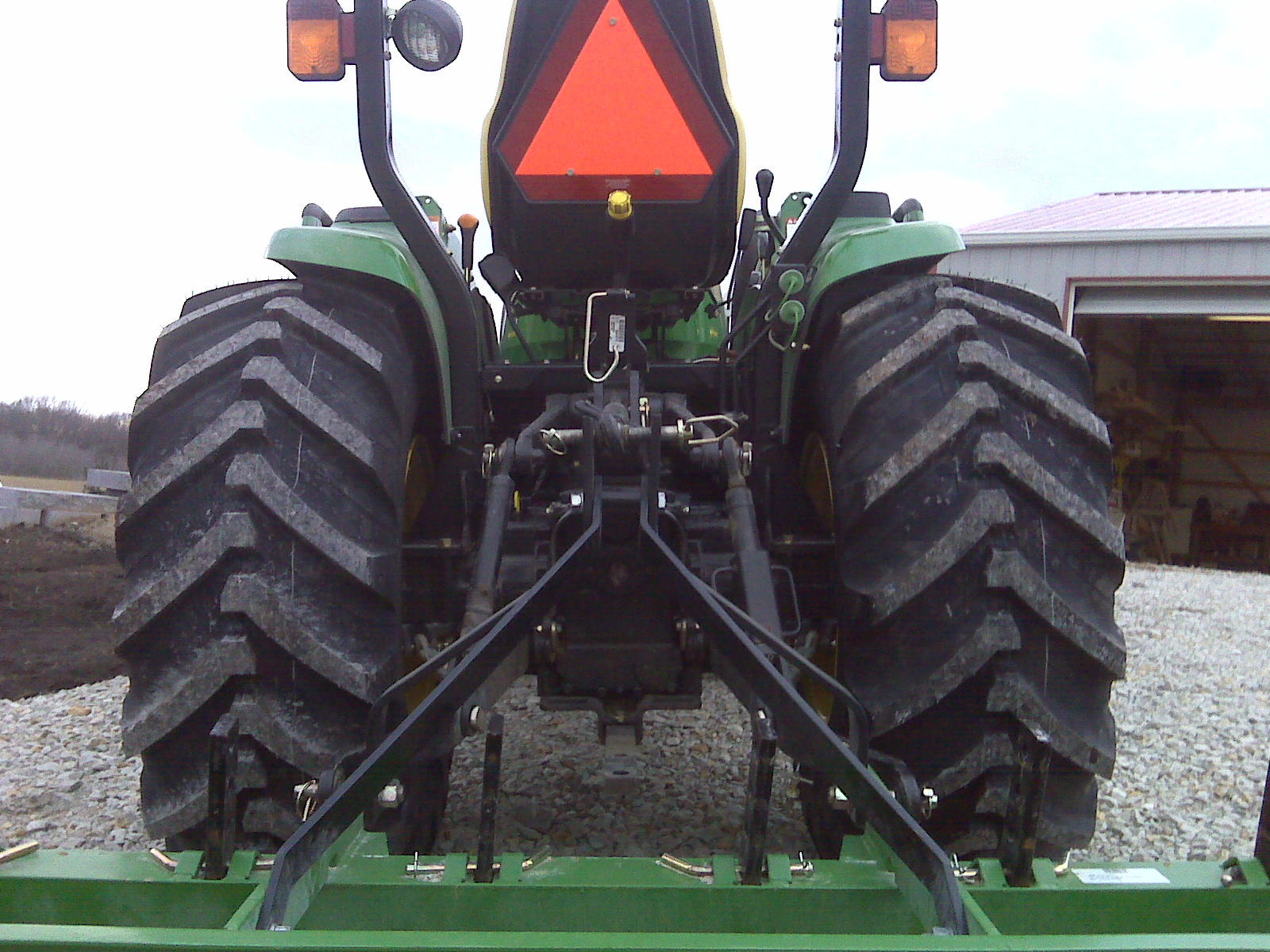

The weight of the implements will help. However, if you have the Galaxy's like I did, I don't think you will be happy. I put Michelin XMCL Radail R-4s on my 3520, and they were fantastic in the snow, All I used was a box blade and the loader to move snow. They have a much bigger footprint than a bias tire will. Plus their tread design cleaned well and gave me good traction. I have had 2 people from this sight ask me about them, and I know one guy bought them. The size for the rear in a metric radial is 400/70R20.
If you have the 19.5s, then you will be out of luck for the Michelins because they don't make those.
The other key to good traction, is to make sure you don't have to much air in the tires. Most people do. I ran between 9 to 11 psi in those back tires, and 18 to 22 in the fronts. I still think the rear tires had bit much in them as they did not squat at all under load.
Here are a couple of pics. One shows one rear tire way further out, and that is because I was putting spacers on and snapped a pic to show how much difference 4 inch spacers do for you.
Good Luck

Nice tread design. Light air pressure with those and you're going places.:thumbsup:
