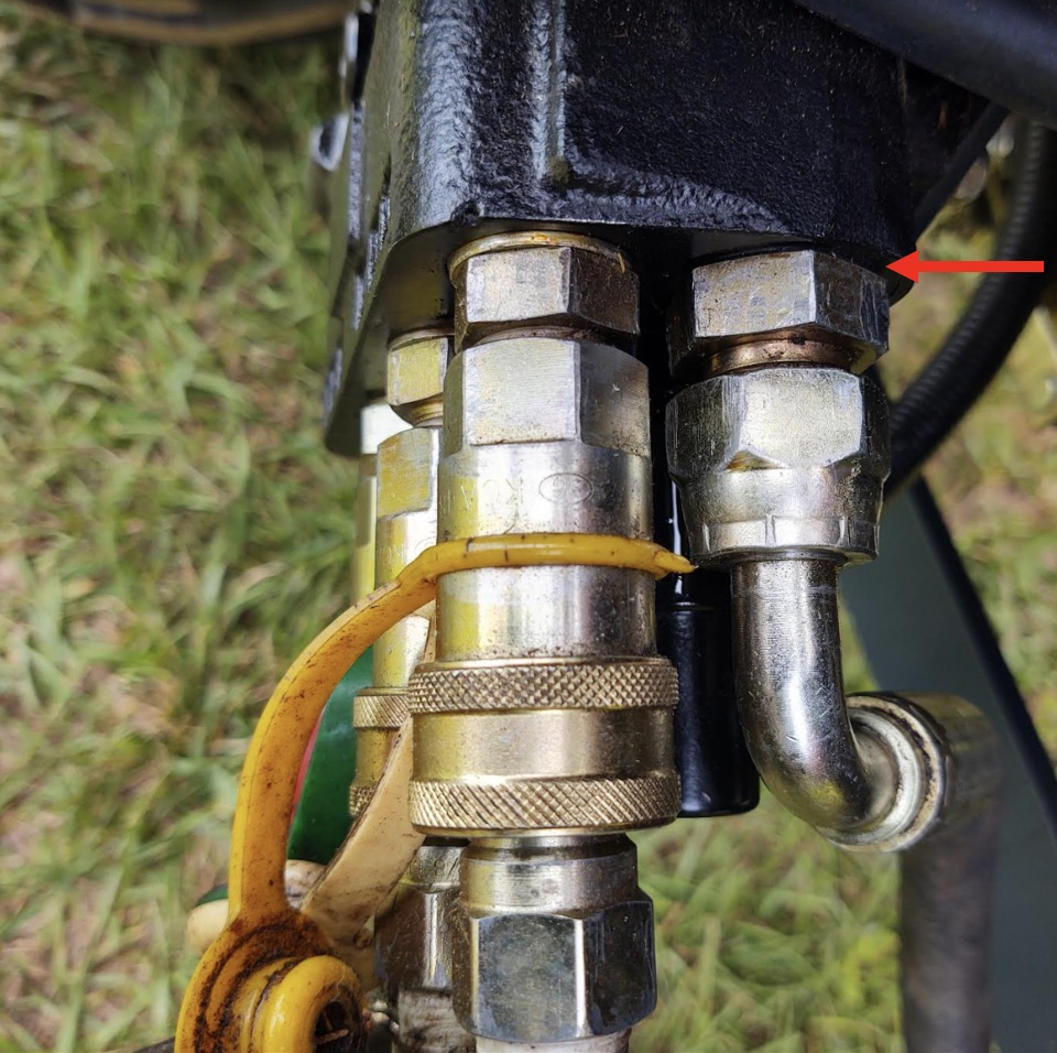

3515CH with ~300 hrs and I don't experience that issue. I did have an issue where the if I lowered the bucket I could let go of the loader joystick and it would continue to lower and I would have to pull the joystick back to stop it. The problem was the line coming into the value block below cab they had used a normal o-ring which was crushed and caused the value to leak. I changed to a metal style and it fixed the problem. Is your value (where all the loader lines connect) leaking?
I am attaching a pic of the connection that was missing the proper seal (note the rest of the lines had the proper metal one)

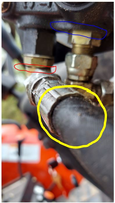

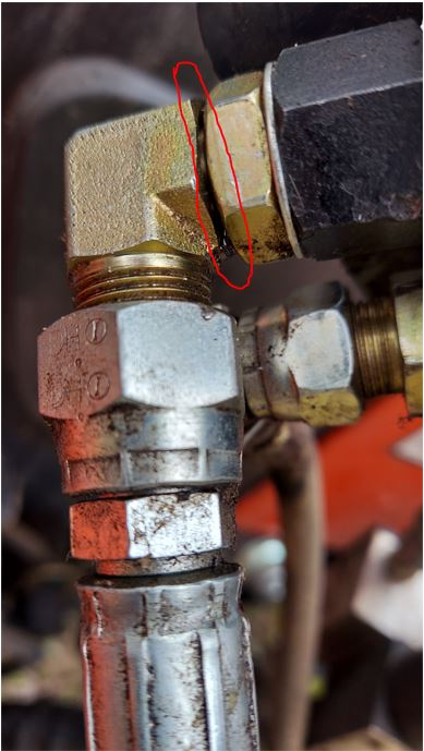

Denjen, I have had several small leaks from the loader valve and and third function quick connects. The first picture shows the bottom of the loader valve block. It was dripping between the elbow and the adapter. The area of the drip is circled in red. I took that apart and tightened everything up. That appears to have stopped that drip for now. I do occasionally get a drip of fluid on platform. I think that is coming from the hose crimp. The second picture shows a different view of the drip area. I have circled in blue what I think is the similar connection where you added the crush washer. I do not have one in that area either. The hoses from the third function kit are both weeping fluid at the crimp. I have taken apart, cleaned and tightened the fitting for the third function quick connects up front multiple times. Debating if I want to replace the hoses myself or haul it into the dealer and have him go over all of the hydraulic connections.

Is it under warranty? One thing I don't like is how the main line coming from the pump to the loader value goes underneath the tractor. Mine burst it might have been pinched; but didn't see evidence of that. Dealer replaced it and fluid under warranty. I may in the future look for alternate route and get new hose made.
