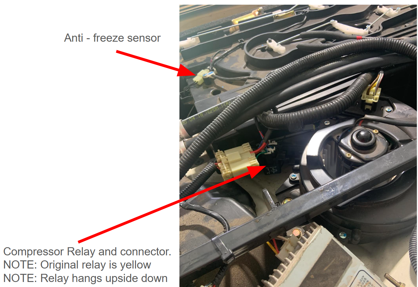

LouNY, thanks for the reply, I did notice the manual shows 4 relays (relay set) under the dash; but it has 5 relays and none of them are labelled. I will review the schematics some more.

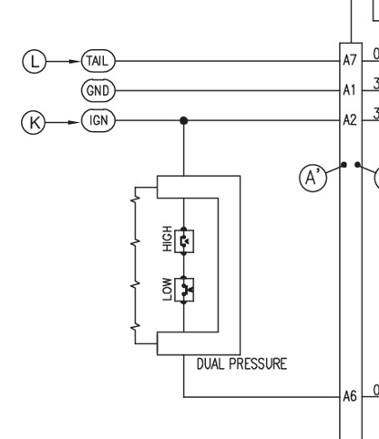

Thought would update for others that might have this issue
Symptom - No cold AC, compressor clutch does not engage

3) Check pressure switch on condenser (used continuity tester), next checked for pressure switch voltage, tested good (need ignition switch on).
NOTE: per the schematic it shows a 'dual pressure (high/low) switch'
NOTE: Page 756 of 15 series service manual
Since blower, AC button appeared to work decided to verify the anti-freezing sensor (left side, 2 wire plug, part of evaporator in roof), checked out good
4) Engine running, blower motor set to 2, AC on, checked for power on compressor relay plug (labelled E1 and is blue/white wire), no power. Removed and tested per service manual (used example page 775) and found continuity bad.
5) Replaced compressor relay and AC blowing cold air.... :) (So far.... LOL)

Yes, condenser and receiver are combined on 15 as well. I cut/pasted from the schematic about the pressure switch.
I traced the lines from the evaporator all way to the compressor and couldn't find a switch in the line, so if somebody that has a 15 series knows where it is please add it here.
