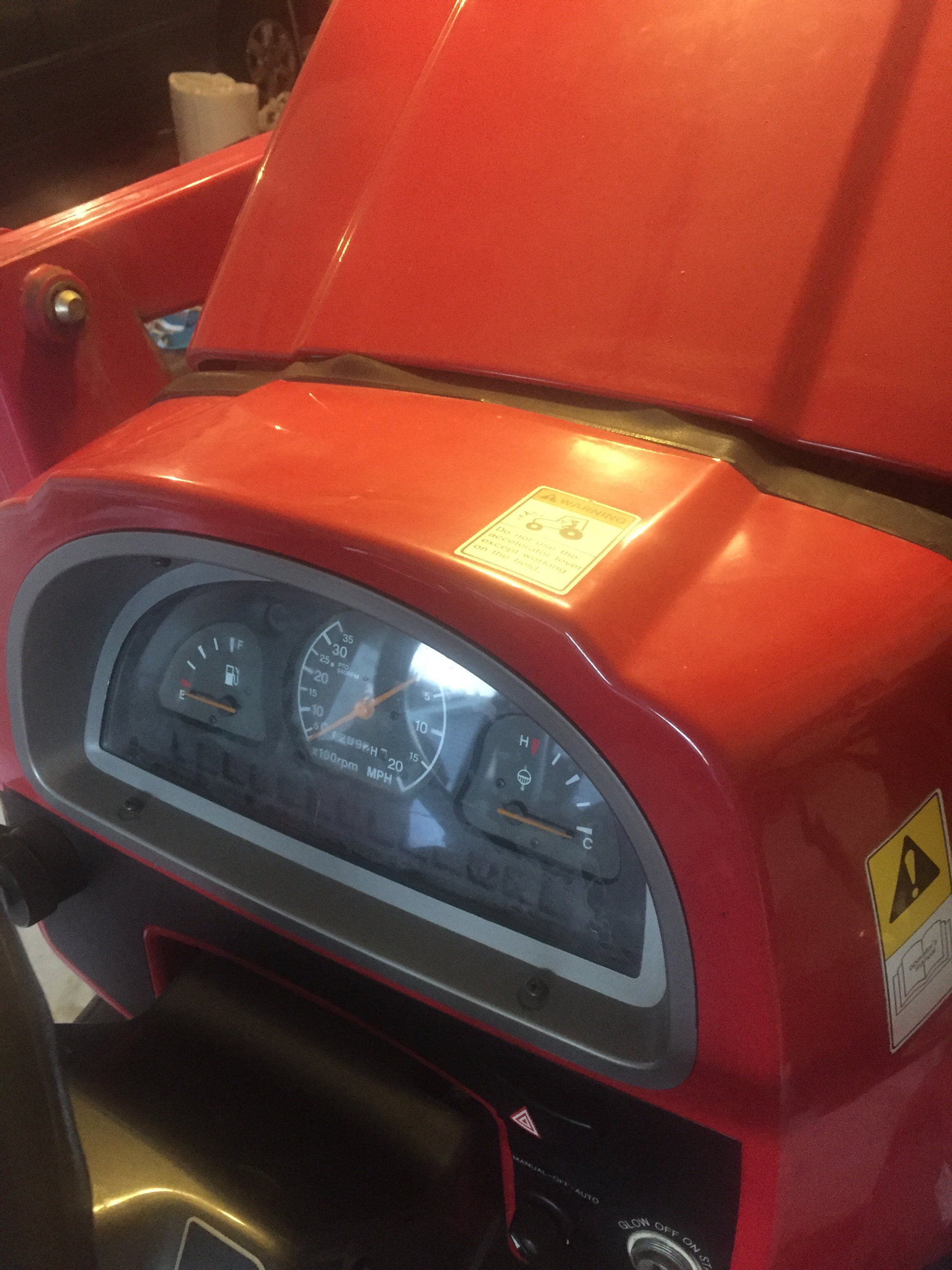

The original owner cleaned the tractor prior to me picking it up, I'm pretty sure with a pressure washer. It seems water must have gotten into places it shouldn't have as I'm seeing some weird things going on. At first the turn signals weren't working, after pulling one of the harness plugs, drying and applying die-electric grease they are now working. I know the original owner well and have used this tractor in the past, this issue has just come up after washing.
The glow plug light is on faintly even with the key in the off position. When started it goes out and seems to run fine but I'm a little worried why the glow plug light would be on faintly in the off position. Am I on the right track to continue disconnecting harnesses and applying die-electric grease and this might be related to the cleaning? Anything else I should look for?

As for my electrical issue I was wrong in my first post, the light(s) that remain on after the key is turned off are the oil pressure and battery not the glow plug as previously indicated. I've found if I turn the key on and off several times the light(s) will eventually go off, possibly a bad connection at the key switch or bad key switch? The lights do go out once the tractor is started.

If indicator light is partially on, it probably means plugs are too. Is possible, test if the glow plugs themselves are "faintly on" with a voltmeter? Hope it's not a key switch issue. Maybe check connections there?
When you say apply dielectric grease (an insulator), do you mean to the connections before you put them back together, or around connections after you clean them and put them together?
Edit: Saw your comment about which lights are staying on. Sounds like it is a key switch issue, not completely turning off; but enough where fuel shutoff is dropping out and shutting engine down, but leaking enough that you're getting the lights you'd get if you turn key to "On" but don't start the engine.

I figured out how to access the switch, you have to remove the instrument panel. Out of time tonight to go any further, will update tomorrow.

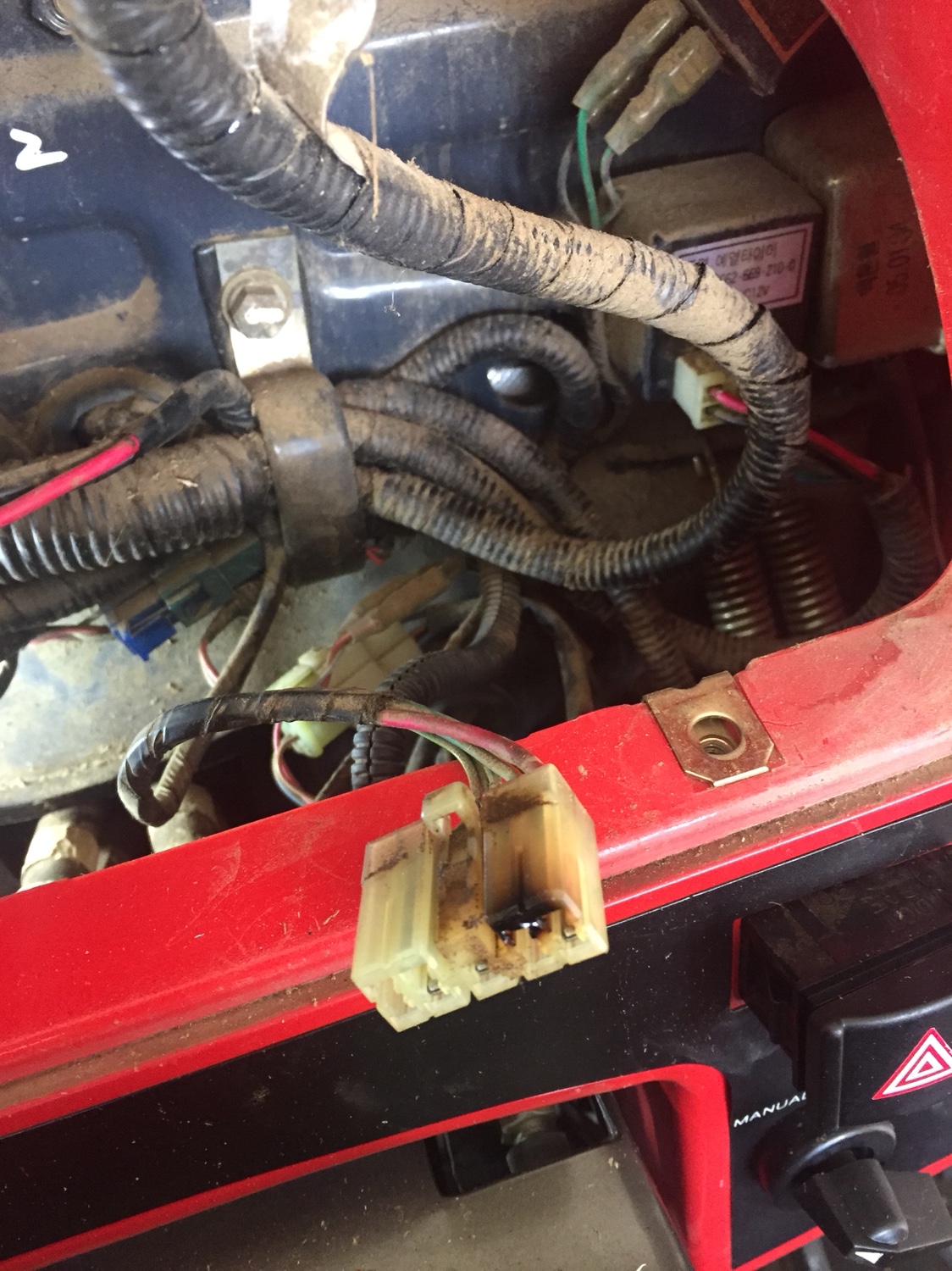

I've been through just about every connector on the tractor so far, cleaned, greased and reassembled with no luck. Guess I'm going to try a key switch next.

That’s the harness for the hazard switch. Unplugged it and the dim lights go out. Going to order a new switch and see what happens.

Replaced the hazard switch, good to go now...
