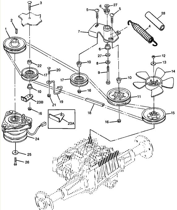

Here is a shot of the pulley's that make up the main drive. And can check to see if something is/isn't caught in the fan. Plenty of things turning that might cause some noise.

Thanks. Could you also attach the parts list?

Also check the PTO clutch (#24 in the diagram). Even when the PTO is not engaged the motor shaft spins inside it all the time and it has internal bearings that can wear out. Usually when those bearings are worn the clutch will whine when it is NOT engaged, then when you engage it the noise quiets down (I know that seems strange but it's because of how the bearings work under load) but that is not always the case.
Yes, I can. But you can get it just as easy by going to jdparts.com (free registration) and plug in the model no. Then every part on the 345 will come up.

Well it is the PTO's bearing(s). I took off the PTO and the noise went away from the tractor. Also, I can tell by, moving the removed PTO by hand, that the bearing(s) are rough.
I'm going to replace the PTO (then try to re-bearing the old one) and drive belt.
I figured I'd at least replace the bushing on the two sheaves and one idler. Bushings are #10 on the drawing. Is that good enough, or do I need to change the actual pulleys?

The bushing is only a spacer. The idlers have sealed bearings in them. If the bearing in the idler is making noise, replace the idler. Been there, done that...

Thanks Bill. I replaced the PTO without ordering anything else. I loosened the drive belt while down there and took off one of the idlers. Just like you said, the bushing is just a spacer. I need a new drive belt. Ordere on and the three idlers. I'll plan to replace it all in a few weeks.
The PTO was the source of the noise that bothered me. The idlers are not too expensive, figured I should just change them while I have the belt off.
